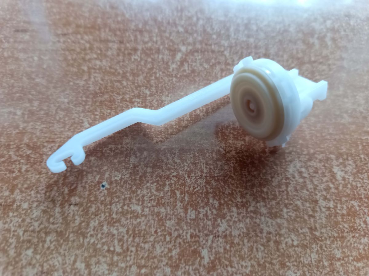

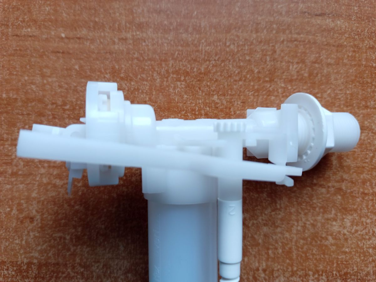

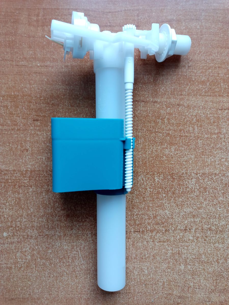

    My cistern has developed a problem with a slow Inter-Sano fill valve,
    Slow Filling Cistern: DIY Solutions for Compact Toilet or Plumber Needed? .

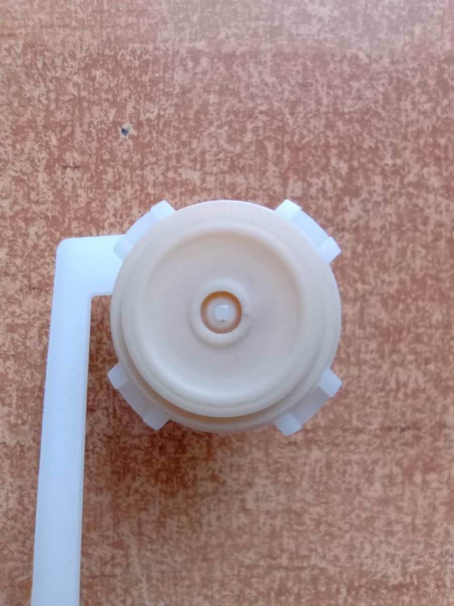

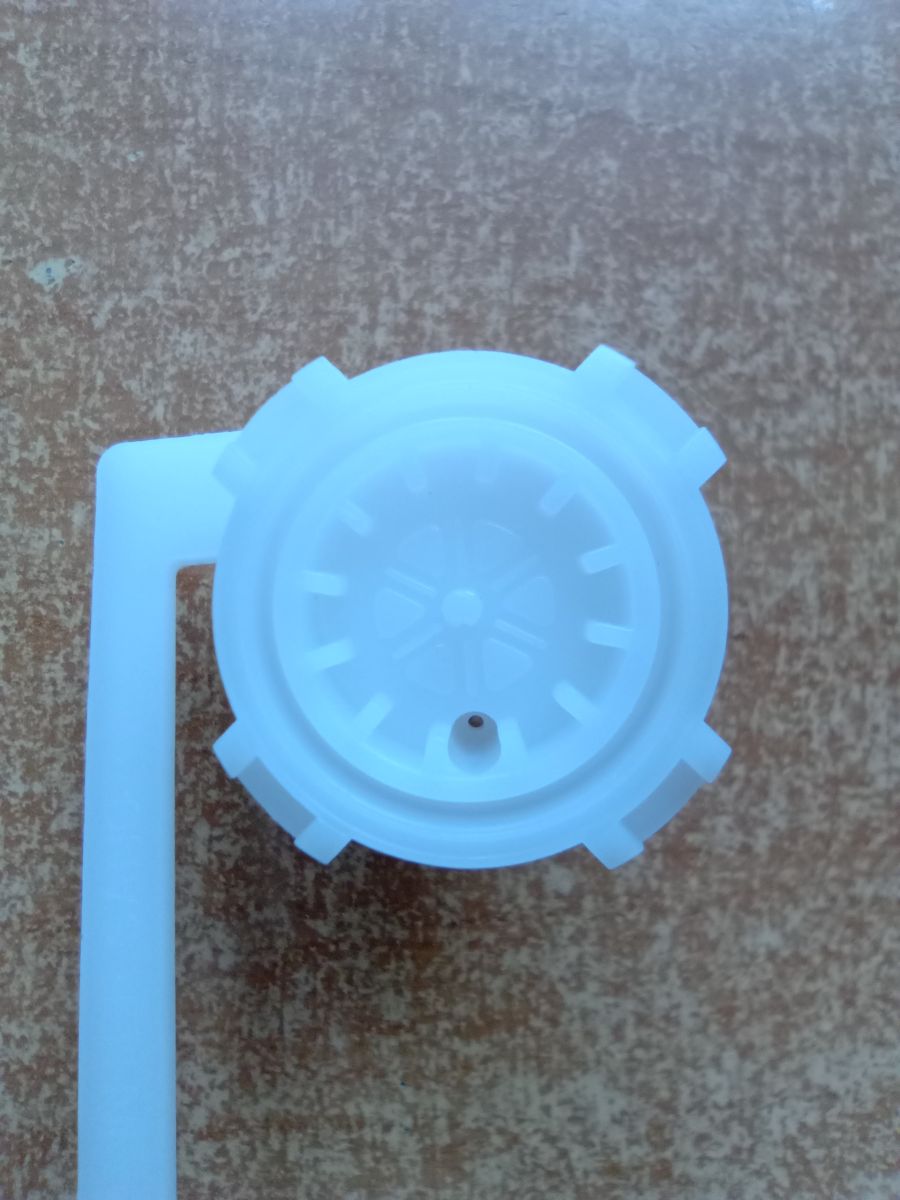

    resulting from insufficient pressure of the diaphragm against the plastic part of the control chamber. The cause appeared to be a loosening/unsealing of the connection between the two components.

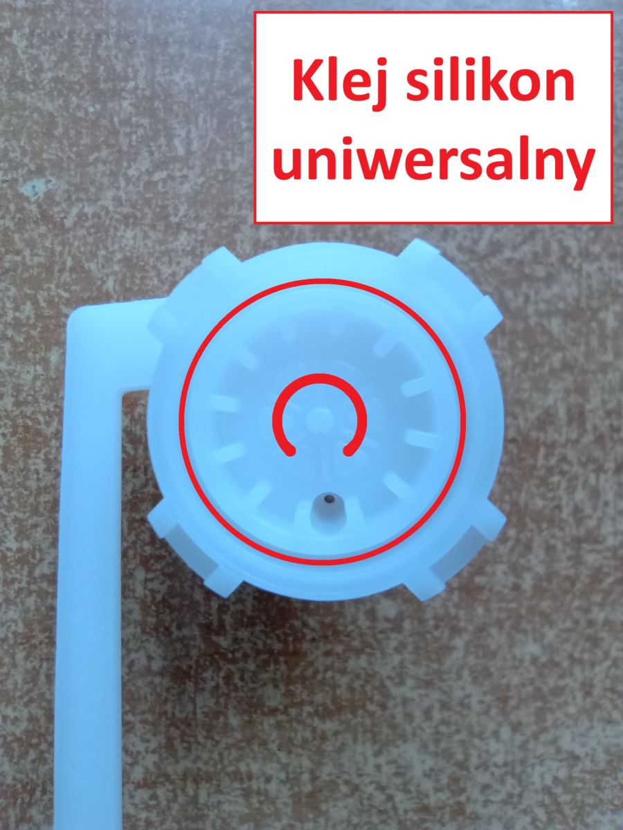

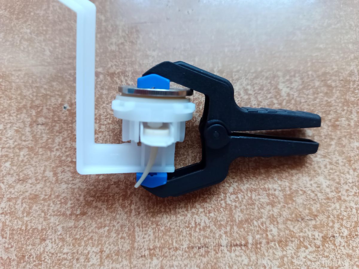

    For the repair I used 100% silicone universal clear glue No. S-072 (20 ml) brand Technicqll . The glue was applied pointwise to the arc of the circle and the outer circle marked in red,

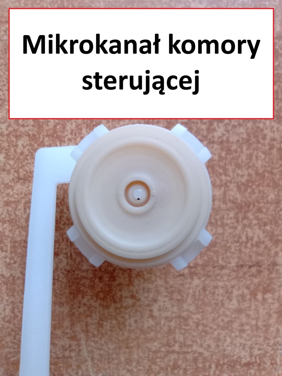

    omitting the section (arc of the circle) directly below the microchannel of the control chamber,
    so as not to disturb its hydraulic function.

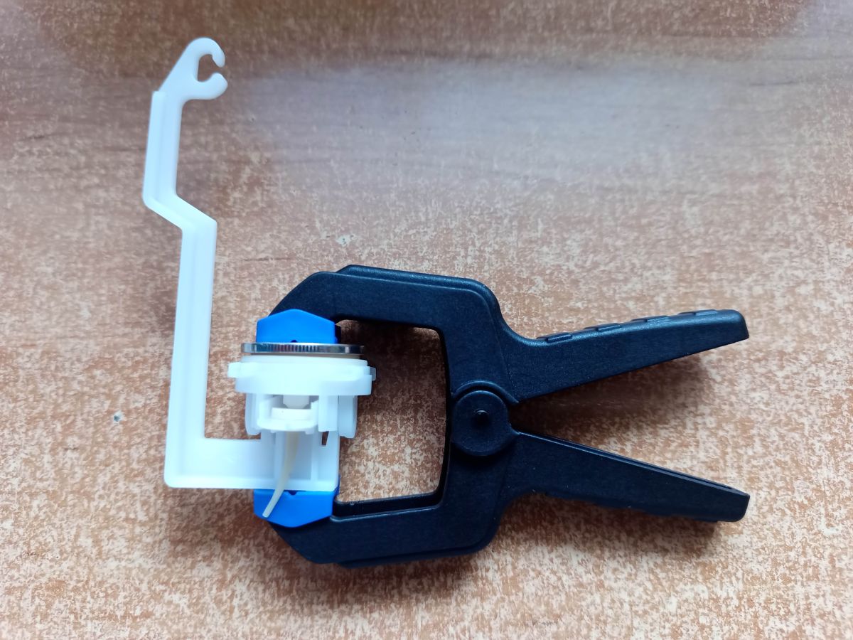

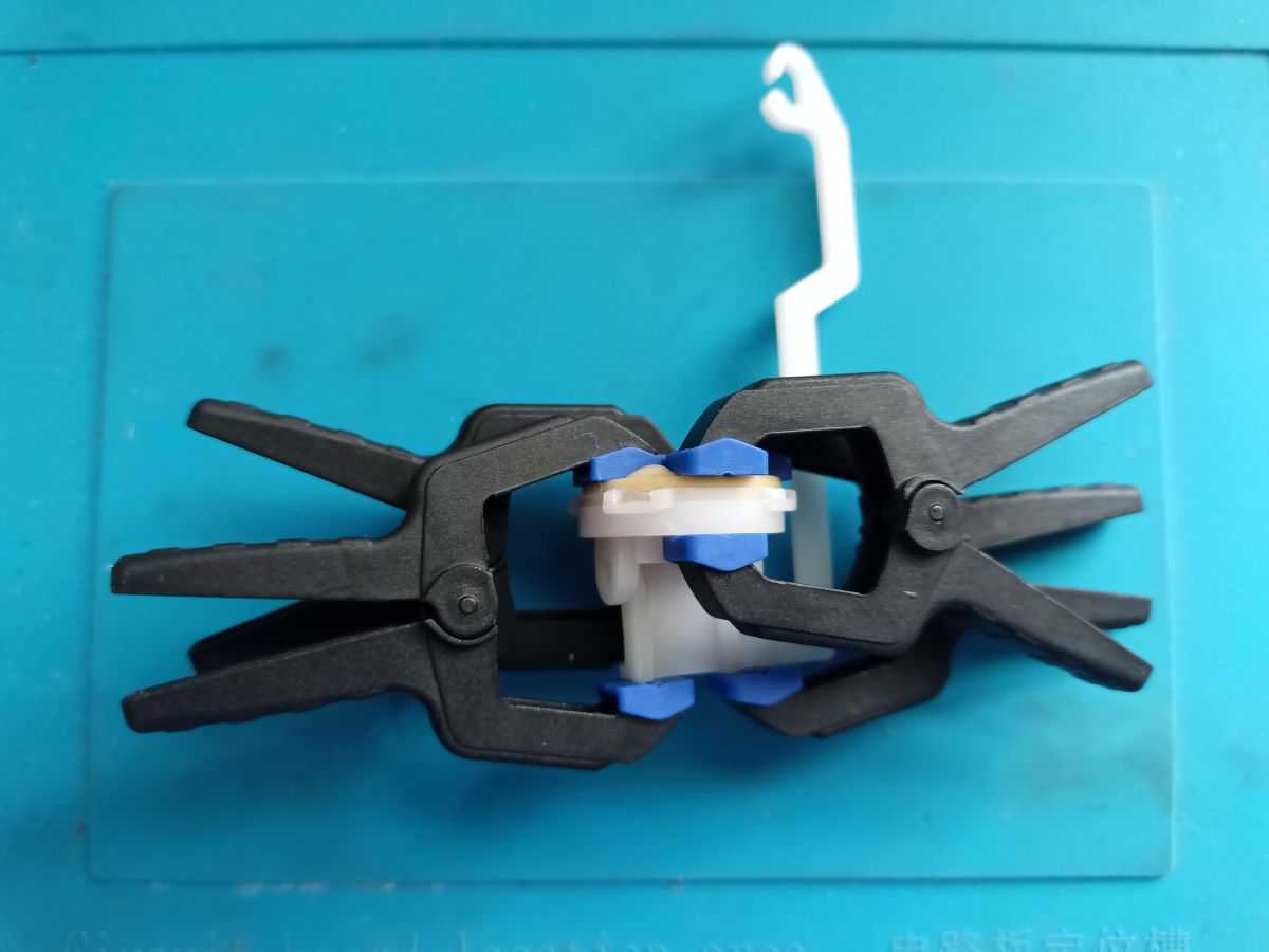

    After the adhesive application, the diaphragm and plastic component assembly was compressed with LUX-TOOLS spring compressors.
    Compression with LUX-TOOLS 50 mm spring compressors is recommended.
    or 85 mm
    using a 1 zloty coin between the clamp jaw and the diaphragm for even pressure distribution, stabilisation of the components during curing, avoidance of diaphragm crushing and precision without specialised tools.
    The components were left in the clamp for 24 hours at room temperature to cure the adhesive. After reassembly, the valve has been working properly for a month now.
    I hope this method will help other forum users to solve a similar problem - in my case it proved completely successful 😁.
