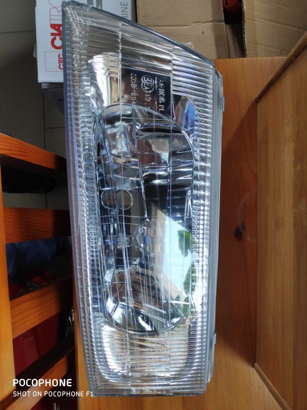

How can I tell whether an E4-marked headlamp is meant for right- or left-hand traffic?

    I have a question whether this lamp is for right or left-hand traffic - the E4 marking suggests Dutch approval, while from what I found on the web, the right arrow is a lamp for an Englishman?

    It is possible that from "english".
    can you post pictures of the entire lamp from the front?

    There is nothing about a right arrow at all on this page, and the reverse is true of the other pages.
    Removal of the entire lamp

    To my eye, this is a left-hand traffic lamp.
    But I can be wrong.
    The halogen lamp has three lugs, the one on top is perfectly vertical for right-hand traffic. In a left-hand drive lamp, the bulb is slightly twisted to the right - clockwise when viewed from the bulb mounting side.
    As a last resort, you can always insert the H4 bulb, connect the cable and see if it shines higher to the left (English) or to the right (continent).

    Right arrow = left-hand traffic.

    Then why is the E4 marking in this case?

    It does not matter. It was approved there. Not only angoles produce left-hand traffic.

    And can it be 100% determined after marking the lamp?
    Because the seller insists that it is adapted to our right-hand traffic.
    The lamp is marked DEPO 2701685

    Looking at the shape of the slant on the mirror - asymmetrical light, right-hand traffic, i.e. continental Europe. The arrow is not a right / left movement, but the place where the lamp is mounted, in this case the left side of the vehicle (LH). The number of gauges and the types of lamps suggest that it is a H4 lamp.
    Buddy sanfran, in this case, only after marking RHD on the sticker, you can tell that these are English lamps.
    By the way, what's the problem to insert a light bulb and see what the shape of the light beam is?

    BANANvanDYK wrote:
    The arrow is not a right- / left-hand movement, but the place where the lamp is mounted
    And that's what it is, the left / right arrow always points to the outer contour of the vehicle.
