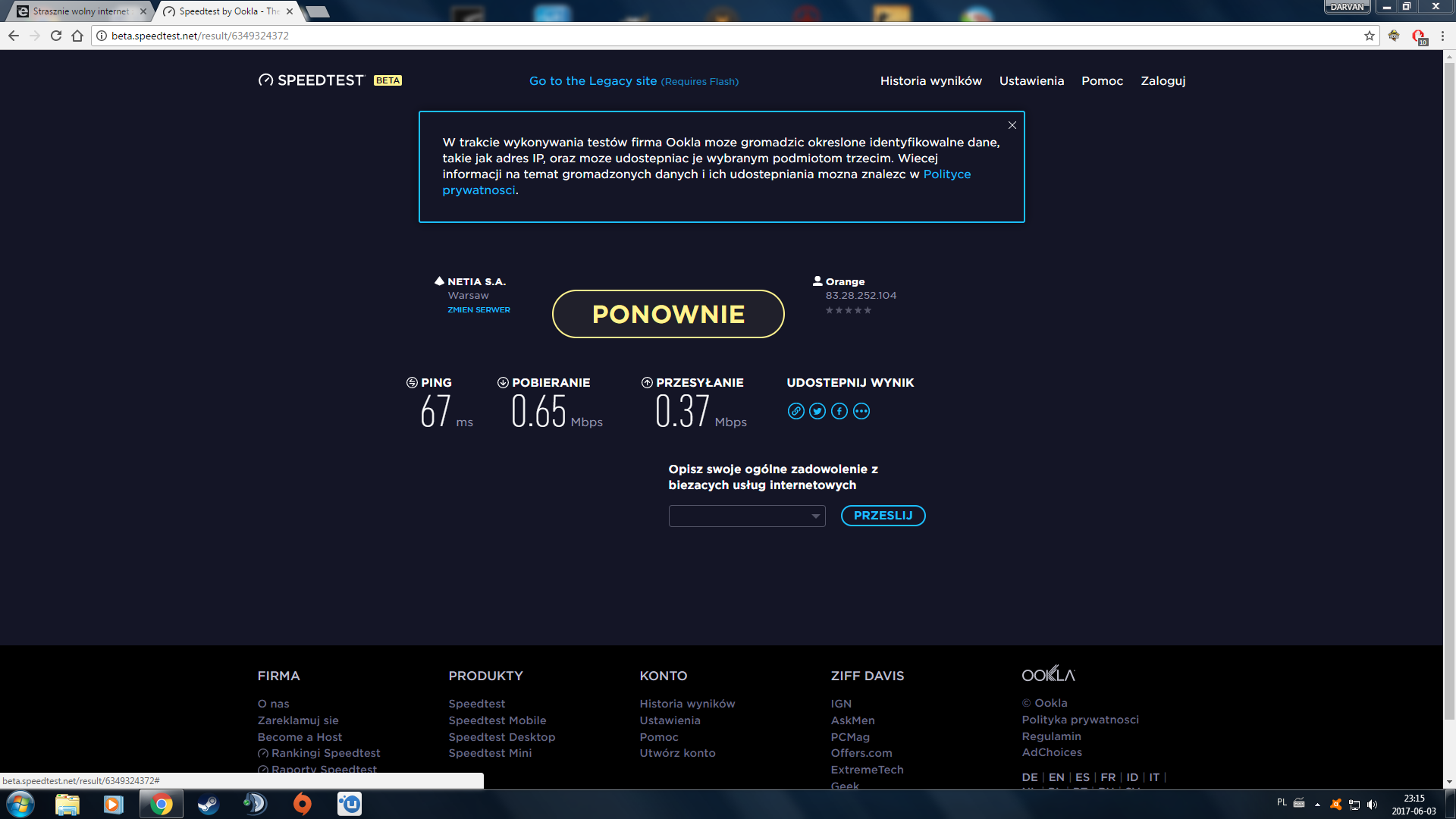

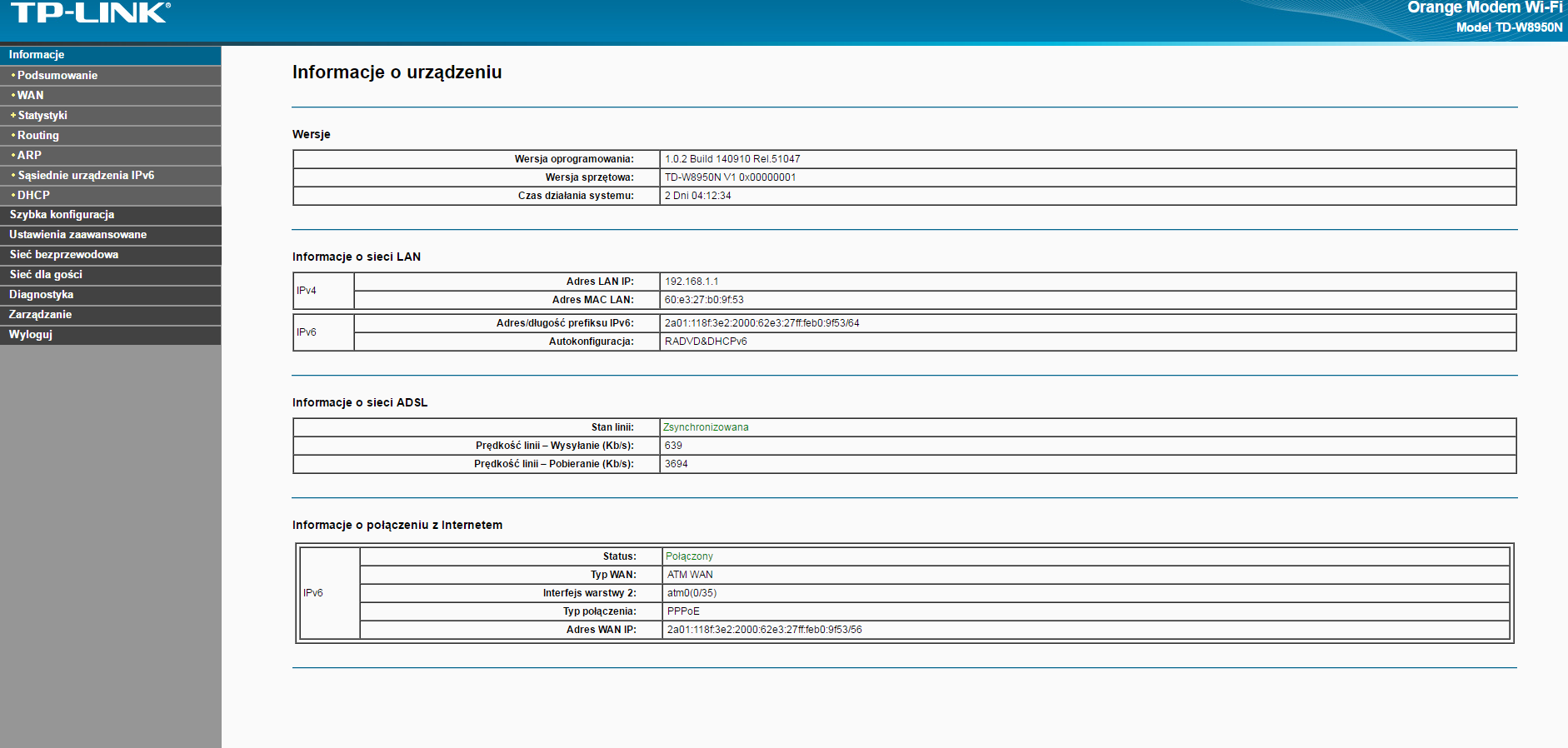

    Hello, my problem is the Internet from Neostrada, the download speed is very slow, about 300kb / s on the router page says that the download is 3694kb / s, the same is true, sending works 10x slower than it should. Can i do something about it?
    I have internet connected with a computer cable, it works similarly on wi-fi.

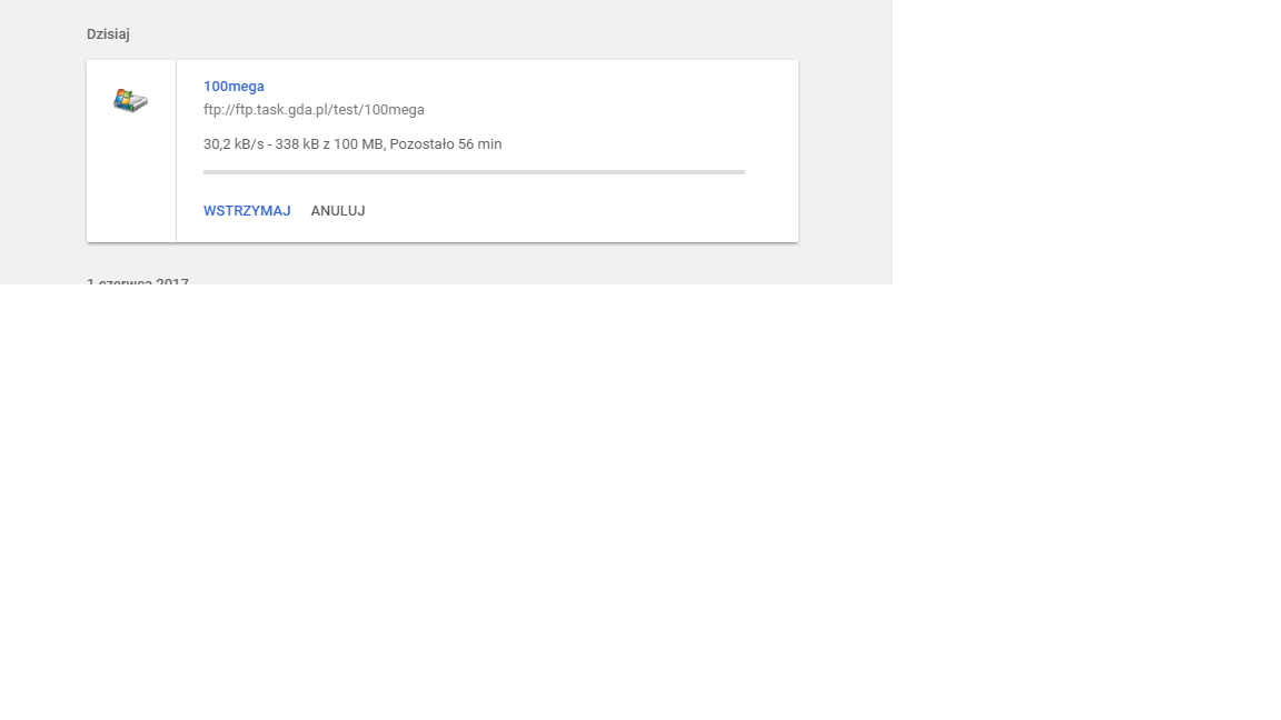

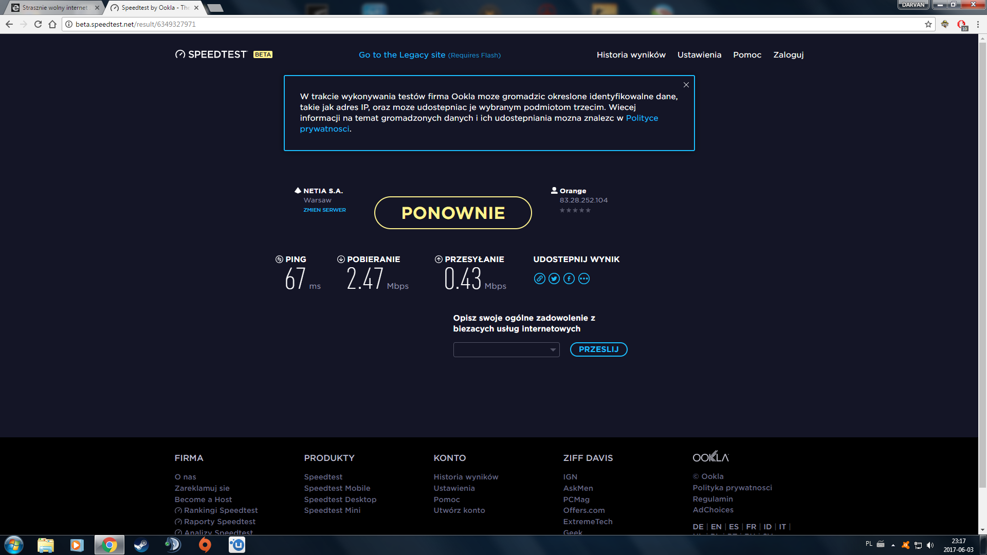

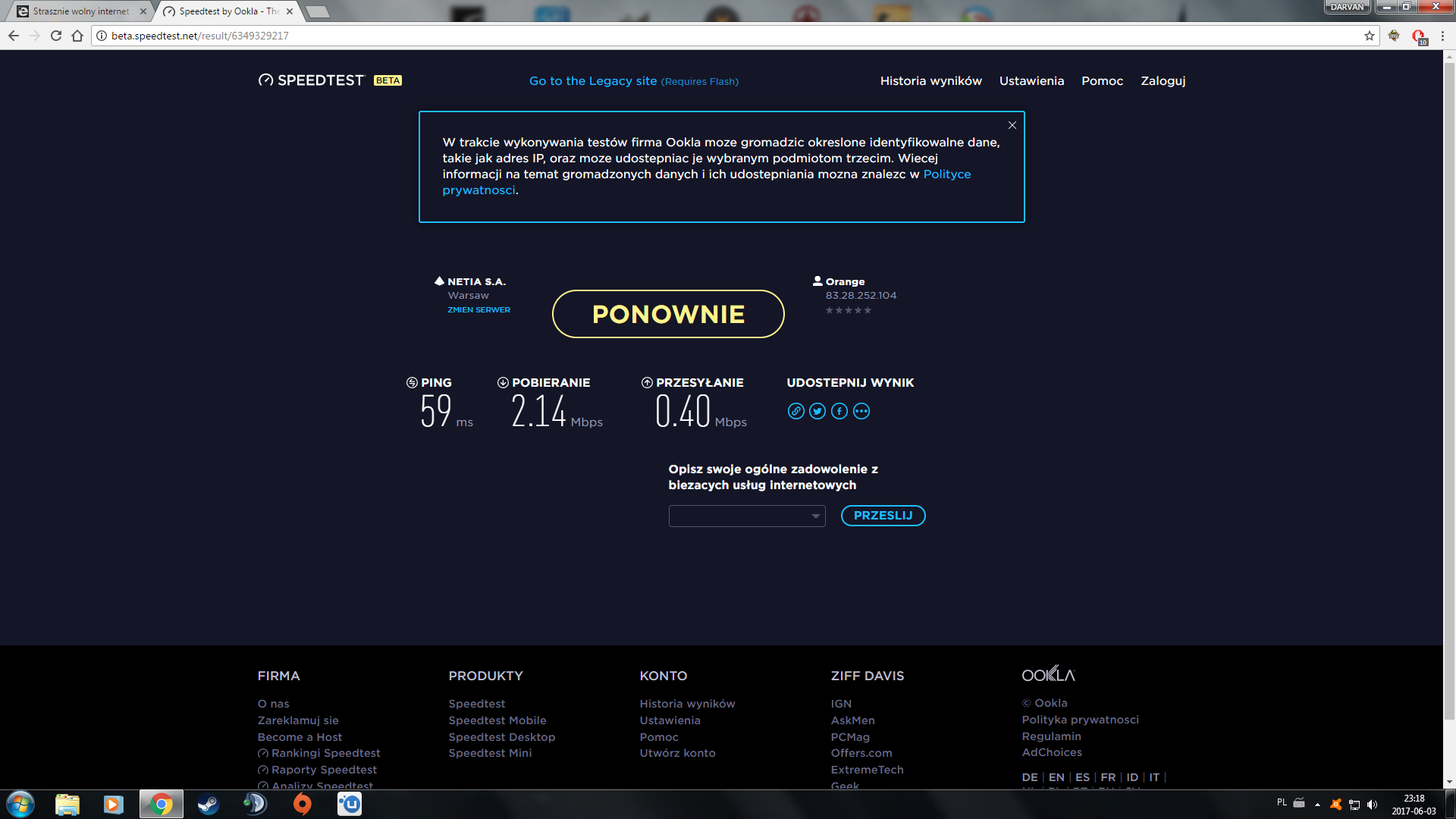

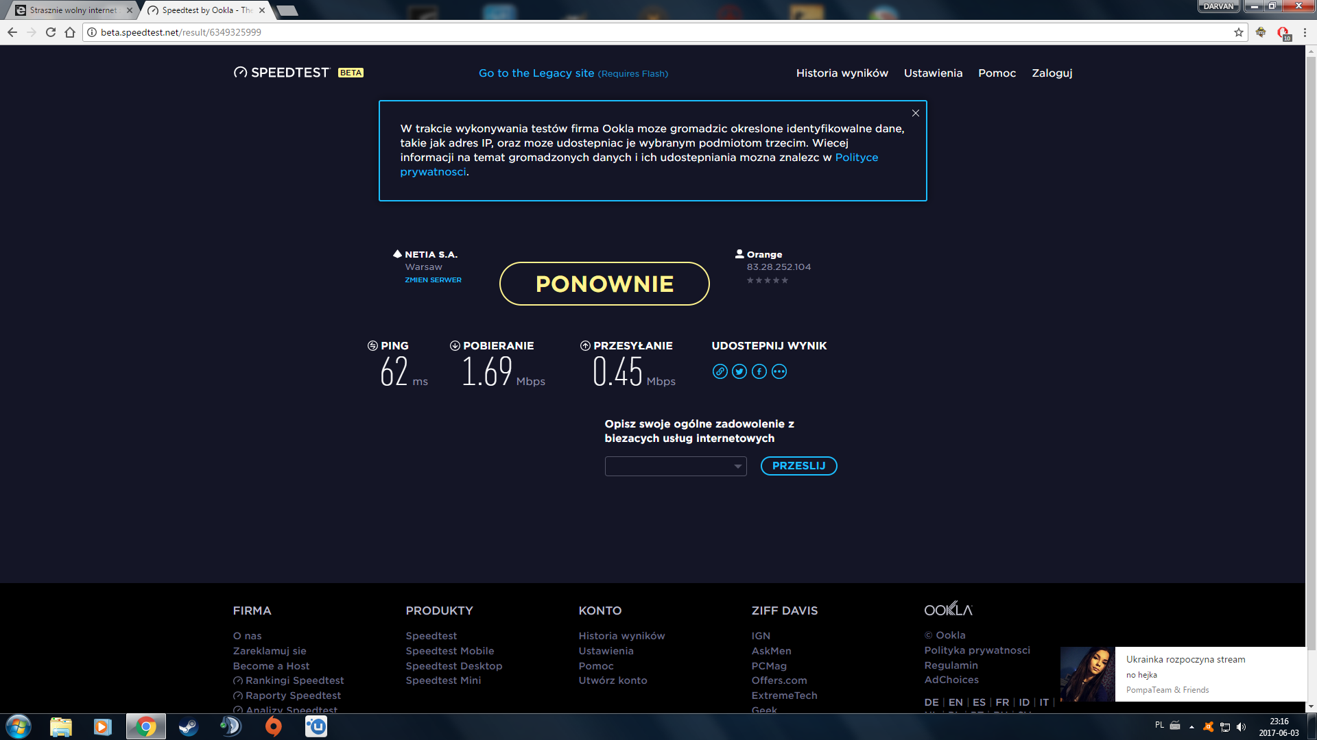

    Every time I did the speed test, the speed was different. Wi-fi in my router was off when downloading this test file max 30 kB / s. Normally, when I download something, it is about 300kB / s when I play some online games, I have 100 ping when no one on wi-fi :( you can't play like that.

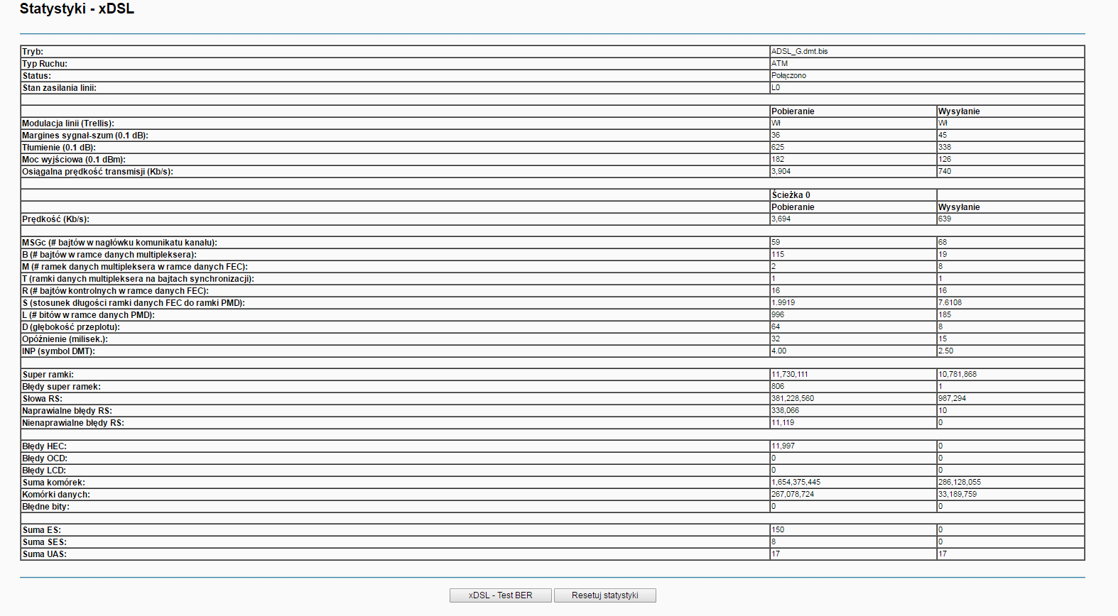

    show full adsl statistics from router, suppression of SNR margin
  • #7 16511450
    DARVAN
    Posts: 7
    I don't really know where to find it.
  • #8 16511464
    LucekB
    Posts: 995
    Help: 143
    Rate: 137

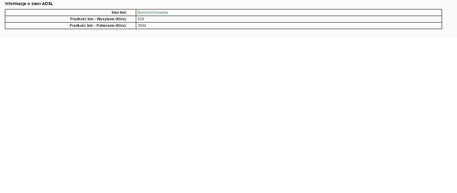

    status> device info and at the very bottom of the page.

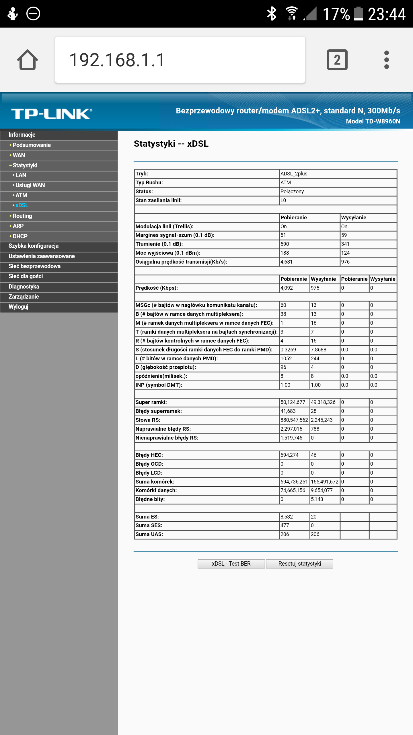

    no, go to statistics> xDSL
  • #11 16511570

    you have 3.9 synchronization so the connection speed achieved is about 3Mbps for speedtest
    High line suppression - long distance to control panel, low SNR can break connections.
    synchro in adsl mode, ask / write / call operator for ADSL2 + then the speed will increase a little.
    Have you always had max 3 Mb / s?
