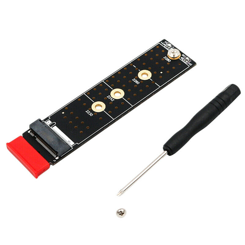

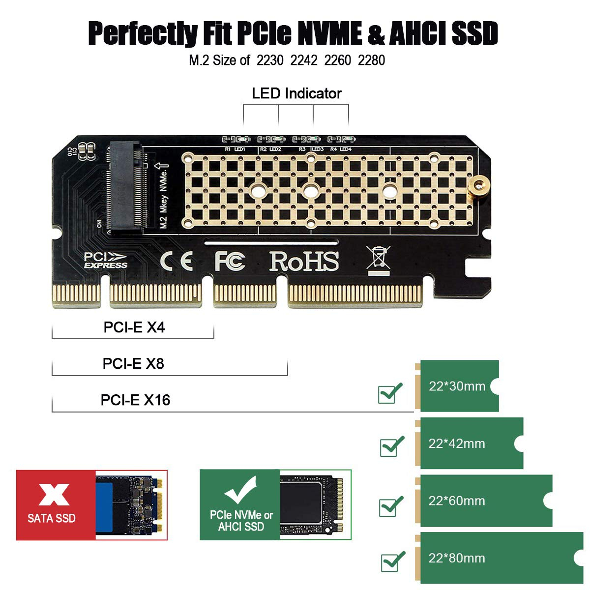

    1/ Dual M.2 Pcie Adapter, M2 Ssd Nvme (M Key) Or Sata (B Key) 22110 2280 2260
    Does My Motherboard Support NVME & How to Check? M2 SSD, Adapter, Gigabyte GA-B250M-D2V
    * za 6.$ i masz opis Link
    2. Amazon za 12.$ Link
    3. 1x(pcie to M2 Adapter NVMe SSD M2 PCIe X1 Raiser Pci-e PCI Express M Key / cena 3.$
    Does My Motherboard Support NVME & How to Check? M2 SSD, Adapter, Gigabyte GA-B250M-D2V Does My Motherboard Support NVME & How to Check? M2 SSD, Adapter, Gigabyte GA-B250M-D2V
    4. oraz to co Amazon za 4.$
    M.2 NVMe SSD NGFF to PCIE 3.0 X16 Adapter M Key Interface Card Suppor PCI Link
    Znane forum (Tomshardware) opisało Link
    * lub Link
    M.2 SSD that has 490MB/s Reads and 460MB/s writes will be affected when used in a PCIe x1 slot (Gen 2) as one PCIe lane is 500MB/s .
    SSD SATA3 ma teoretycznie 6Gb/s
    To mit.
    Zaoszczedzone ($) przeznacz na zakup większego (GBajtowego ) SSD SATA3
