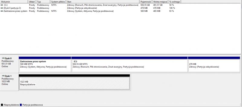

    Hello, I have a big problem with the new SSD (ADATA SU800 256GB). After connecting it to the computer in the windows installer and in the disk manager itself, it shows the capacity of 1023mb. The disk cannot be damaged because I could install the system on it when I plugged it into my laptop. In the laptop, he sees the disk correctly and everything is fine. I checked various sata ports and various cables. I will add that at the very beginning, when I got this disk and I had the same problem, I sent it back for warranty. However, the problem wasn't with the hard drive but with my computer. Has anyone had a similar problem?
    Motherboard: Gigabyte GA-B250M-D3H
    Processor: Intel Core i7-7700K
    SSD: ADATA SU800 256GB
  • #3 17323729
    ayjay_ghale
    Posts: 14
    Only I don't have any partitions on this disk. As I assign this 1gb, it does not even show me that there is any.
    And could you please tell me more precisely what to do in this program?

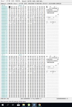

    ADATA SU800 256GB SSD Showing 1023MB Capacity on Gigabyte GA-B250M-D3H Motherboard - Solutions? ADATA SU800 256GB SSD Showing 1023MB Capacity on Gigabyte GA-B250M-D3H Motherboard - Solutions?
    Added after 31 [seconds]:
    This short one is my hdd. and this pour of zeros is ssd
    Are you sure?

    I wrote exactly. Connect the disk and insert the DMDE screen with "current partitioning".
    It's supposed to look like this => ADATA SU800 256GB SSD Showing 1023MB Capacity on Gigabyte GA-B250M-D3H Motherboard - Solutions?

    Your SSD reports itself as SM2258AB-10-00831000 F / W: 20141211 ~ 1.0 GB
    and should: ADATA SU800 F / W: ...... 256 GB
    Upload its SMART from CrystalDiskInfo on this CD (it will probably be 'empty') and then from your laptop.
    Lastly: update the motherboard's BIOS first
