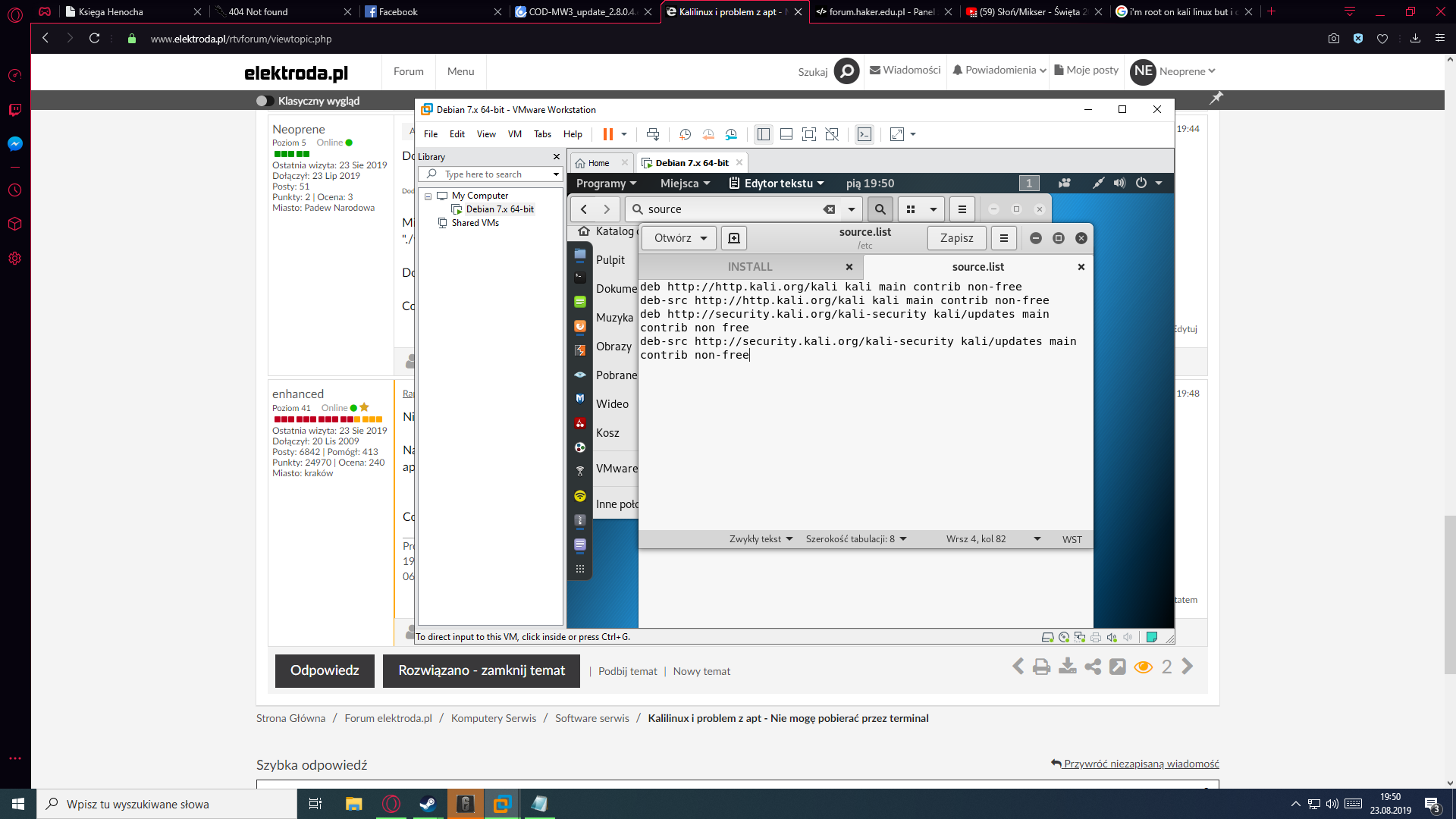

  • #11 18131632
    Neoprene
    Posts: 61
    Rate: 12
    I don't know what you mean by graphics mode
    I will just give you screenshots of this txt Kali Linux on VMware: Issues Downloading Files via Terminal - open-vm-tools-desktop, Tor
  • #12 18131639
    enhanced
    Posts: 10442
    Help: 964
    Rate: 884
    hmm
    but I can see the path
    /etc/sources.list
    and I listed /etc/apt/sources.list
    unless kali has it - I gave it from ubuntu
    Well, if you have a graphical mode, you probably have aptitude or synaptic there?

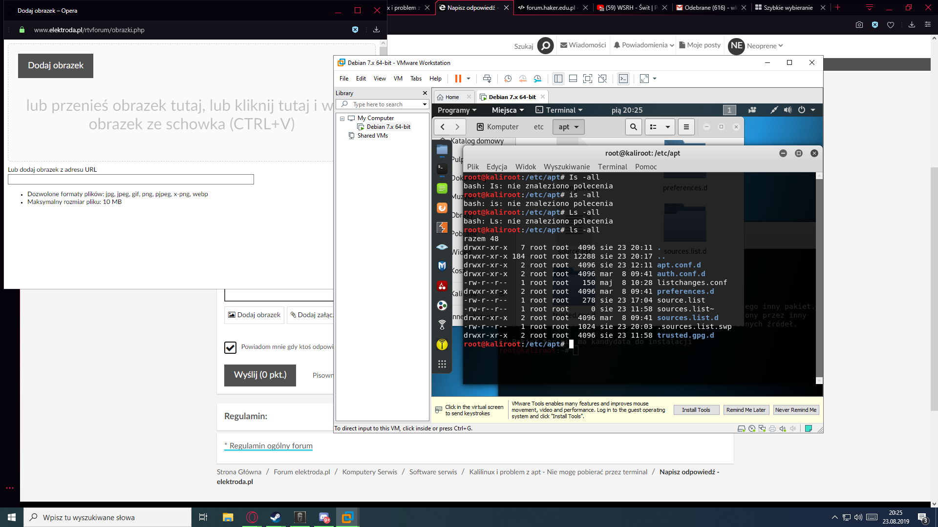

    Go to the / etc / apt directory and give the command
    ls -all
  • #20 18131714
    Neoprene
    Posts: 61
    Rate: 12
  • #21 18131721
    enhanced
    Posts: 10442
    Help: 964
    Rate: 884
    Looks OK, show the contents to be safe and the update result for apt.
