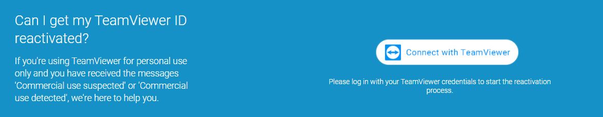

    #7 19333991
    trexx2020
    I came across this thread and managed to fix the problem. A colleague above is right about the license. If we are actually using it for non-commercial purposes, we may apply for an account unblocking. It looks like you need to log in first
    Teamviewer Disconnects After 5 Min: Solve Commercial Use Error on Android & Raspberry Pi
    And then, after filling in the data, print the pdf, sign it and send it to the TV service, there will be a button to attach the scan, it must be in pdf, jpga refused to accept me.
    And here is the link to the form:
    https://www.teamviewer.com/en/reset-management/
    I hope it will be useful to someone :)
    Greetings

  • #10 19345141
    Fox31
    hello 1 day waiting and they apologized to me and unlocked the access is ok you had to fill out the application. hula
