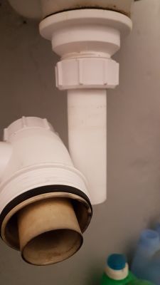

    I live in a block from the beginning of the 60's. For some time the sink has been giving off an unpleasant odor from the sewage system after flushing the tap water. I tried to run hot water for half an hour, then I sprinkled Kreta in granules but it did not help. In the end I used Kreta Bio with enzymes, poured in 100 ml as instructed and left it overnight, then rinsed It seemed that the problem was gone, but after a few days it returned. What's next?

    berthold61 wrote:
    Check the siphon under the sink if it has the right level, maybe you have pushed too much of a pipe inside and there is no level so the air passes through.
    The vertical tube enters 0.5 cm, the horizontal one approx. 3 cm

    Htomas wrote:
    I do not know if I understand you correctly, but this tube from the top is to be submerged below the water level by at least 3 cm.
    Irrelevant. Siphon and it will be so. This chamber is divided inside.

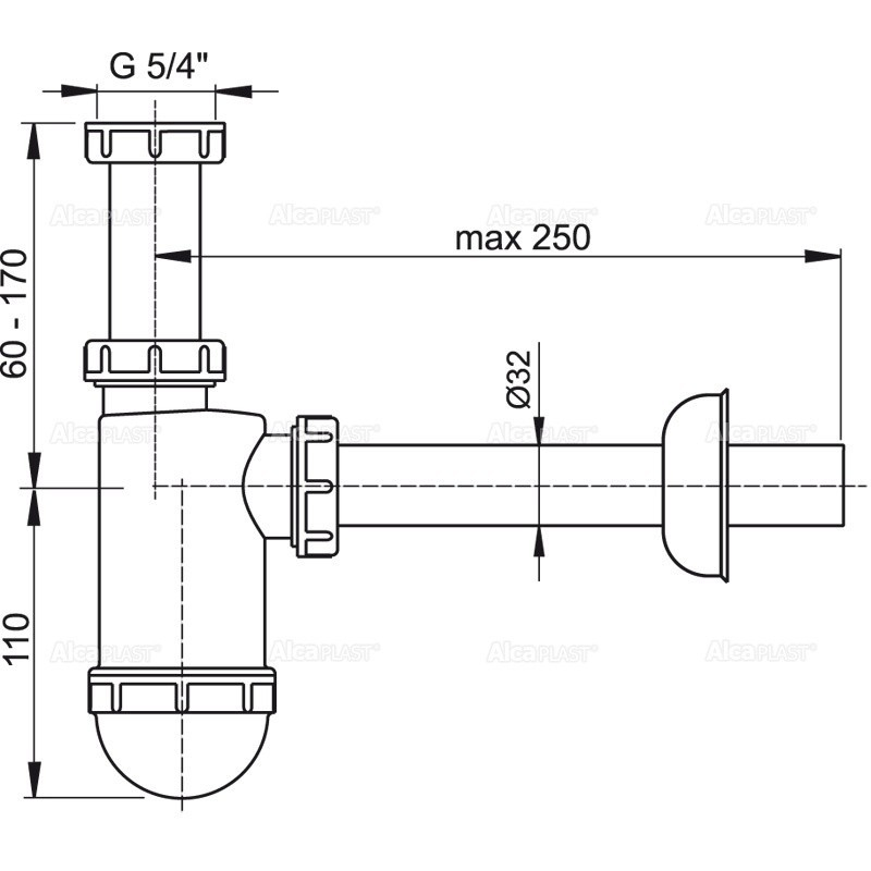

    If what you write about immersion of the tube made sense, this drawing would be wrong.
    The manufacturer states that we can pull the tube as much as 110 mm when the water surface is about 90 mm?
    Does he not know how the siphon works?

    This is a drawing - a view. It does not show the interior. You would have this cross-section.
    I put some on the drawing and you can see how the water goes.
    Because that's how much you can extend and maintain the mechanical rigidity of the connection. For the manufacturer, it is a sedimentation tank, and whether it will be a siphon depends on the immersion of the downpipe.
    Yes, the photo above shows another one, and it can be with a partition.
    In my apartment, the settlers' chambers are not divided and there is a free passage in the "pear".
    I have exactly the ones in the drawing.
    The baffle in this model would have to be like a green line and ... it would be a bit tight at outlet 32
    Good. You have a fantasy :)
    You see, I don't need a cross-section to infer from the documentation that the manufacturer siphon allows the tube to be pulled out so that its end is about 110 mm above the bottom of the glass siphon if at the same time this height is half the height of the drain, i.e. higher than the water level, a siphon must be structurally provided in the center. For example, through a partition or a tube as in the photo
