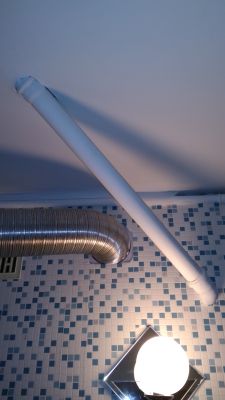

    Hello, I bought an apartment in a block of flats and I have a problem with the drain of the bathtub. Sometimes it stinks from under the bathtub. Today there was a mega unpleasant smell and I decided to go for it. This is the case. The drain is in the floor. The bathtub has no siphon. I found a metal grate on the floor in the corner. When I looked at that square drain in the floor, there is water all the time. Should it be like that? For now, it is not necessary to renovate the bathroom because in the future the cooperative will liquidate gas stoves. How to temporarily fix this situation? Buy a bathtub siphon? But it shouldn't stink now anyway, because there is water in this grate. Addressing Unpleasant Odor from Floor Bathtub Drain in Apartment Block - No Siphon Issue Addressing Unpleasant Odor from Floor Bathtub Drain in Apartment Block - No Siphon Issue Addressing Unpleasant Odor from Floor Bathtub Drain in Apartment Block - No Siphon Issue
    This inclined pipe is a preview of what the drain pipe from the bathtub looks like

    The fact that the water is standing still is not enough. The question is whether the drain is below the water level, i.e. is there any siphon (something in the photo is slightly visible). The second thing, the water splashes onto the spout and soaks into the concrete, as if there are no terrible impurities in the bathtub, but with time it can smell and develop fungus or mold.

    I will try to feel there today whether the drain is under or above the water level.
    Should I buy a grid for this hole or what should I do with it?
    If the drain is under the water level, should I buy a bathtub siphon or leave it as it is?

    Terrible confusion! First, if there is water, there must be a siphon installed in this floor and you do not need another one. Odors can arise due to the siphon being heavily soiled and must be cleaned preferably by hand. WARNING! In my old apartment I had a similar situation and it turned out that the previous owner was throwing used razor blades on the floor and landing in this siphon, so I recommend caution. The low capacity of this siphon caused by its contamination can cause the rapid flow of the draining water to suck in too much and the siphon to open. This will open up a flow of air (stinks) from all sewerage to the bathroom and then onto the apartment. You don't have to close the holes under the bathtub, because theoretically there is fresh water all the time.

    I checked and the drain is slightly below the water level. I cleaned this siphon with my hand as much as possible, I took out a bit of muck but when entering the bathroom I still feel a slight unpleasant smell.
    What agent should I use to treat this siphon to clean it of these organic residues? You write that it is alkaline, but what exactly to use?

    Oki, I read that the mole can be used for plastic and metal pipes, not for aluminum ones. It's a block made of a large plate, so the pipes are probably rather cast iron, there should be no aluminum anywhere, right?
    This oblique pipe, which you can see in the photo, seems to be made of plastic, so it should probably be ok.

    In general, sodium hydroxide should not be used only for aluminum pipes, it reacts with the evolution of hydrogen. For the rest, it is relatively safe, you just need to rinse thoroughly. In contact with the body, it creates deep burns that are difficult to heal. The first sensation is slippery skin, despite being rinsed with water.
    You see you wrote the first one. Aluminum was not used in the sewage system, only plastic, cast iron or stoneware.
