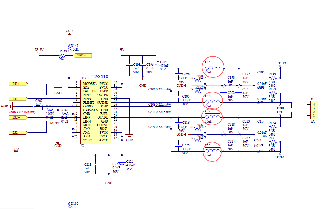

    It took a while, but only now I found the time.
    In my soundbar, the output chokes and some of the power amplifiers get warm.
    When listening at a moderate volume, the chokes can be so hot that they burn.
    Interestingly, the chokes get a little warm even if I physically disconnect the speakers at the plug; they are not very hot, but noticeably warm.
    The voltage from the 24V stable power supply and on the power supply and on the capacitors at the power amplifier.
    It looks to me like the TPA3118 power amplifiers are damaged in some way.
    The sound is clear and does not indicate any deficiencies.

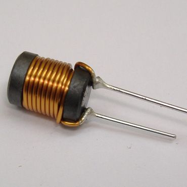

  • #11 18321151
    mick
    Posts: 212
    Rate: 204
    I tried replacing capacitors near the heating chokes, but it did not work... the chokes continued to heat up.
    So I replaced the chokes on one input with 15uH and 3A, they heat up only a little, the rest are hot.
    I`ll order a set of chokes and replace them, we`ll see.
    I confirm after replacing it with 10uH 5A chokes
    http://sklep.remagas.pl/pl/elementy-indukcyjne/d%C5%82awiki/dsz-9-10-5,0-v-detail
    chokes do not heat up!
    Correction, after tests on loud music, unfortunately the temperature of the chokes is quite high, not high enough for the thermal protection to work, but some chokes are clearly hot.

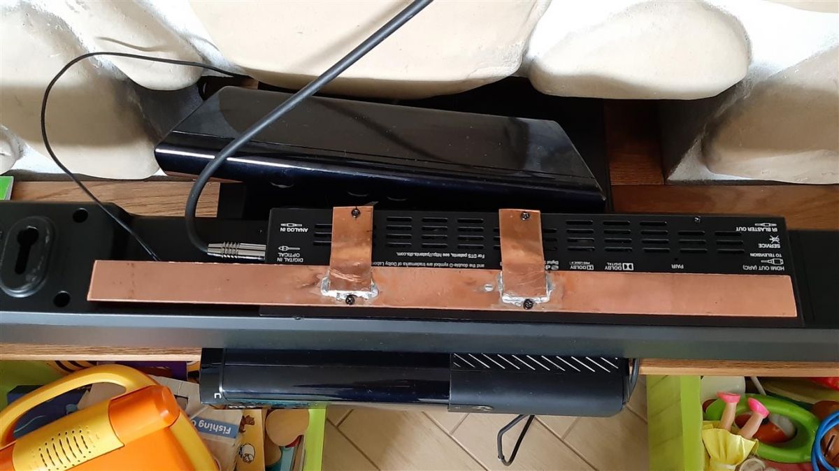

  • #14 18468253
    mick
    Posts: 212
    Rate: 204
    I have to worry you, the chokes have been changed and they are still heating up :( I`m going to cool the choke cores, but I still don`t have time
    I changed the chokes to 7A as in the one below http://www.sklep.remagas.pl/pl/?option=com_vi..._id=120&virtuemart_product_id=5900&Itemid=101
    Denon DHT-S514 soundbar - sound problem
    The chokes are too large for the housing, so I had to cut a hole, after which the chokes protrude about 3 mm from the housing.
    Unfortunately, these chokes also get hot, so I assembled the heat sink from 3x30mm copper flat bars and attached the heat sink with existing screws. Since I couldn`t solder the chokes perfectly straight, I put a rolled aluminum foil between the heat sink and the choke cores. After pressing and fastening with screws, the heat sink is invisible.
    When used after an hour, the radiator is about 45 degrees!!! For now, thermal protection does not turn off the soundbar. I`m a bit of an amateur, but I haven`t found a better way.
    More than 2 months have passed with this modification of mine, i.e. replacing the chokes and the radiator. During this time, the soundbar did not turn off even once. The tightened flat bar is about 45-50 degrees C.

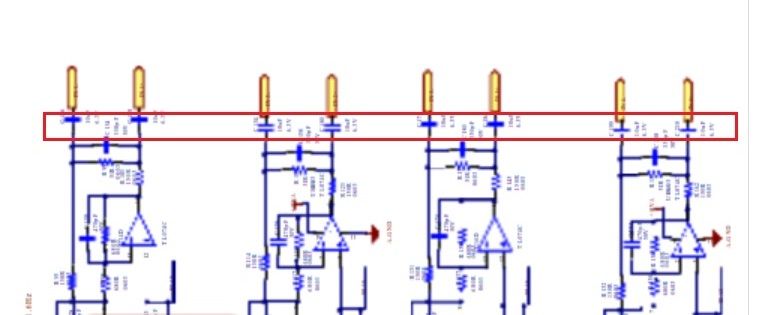

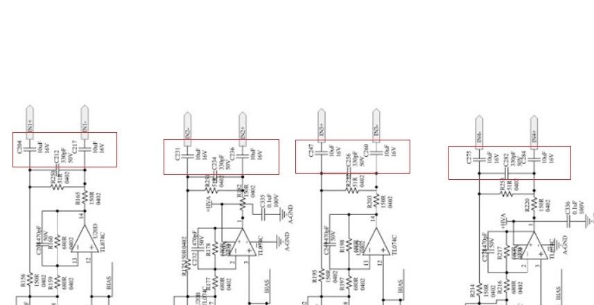

    I wanted to share my observations about the problems with DHTS514, as they have occurred to me once again. I am not an electronics expert, and the presented conclusions are based on the collected knowledge.
    Failure 1
    Since new, I had a problem with starting the beam, the subwoofer turned on immediately, but the beam (sound) turned on a few minutes later. Warranty repair – "Replacement main".
    Failure 2
    This is probably the most common condition and I think it may apply to some of the cases described here - after it warms up, there is a popping, clicking, knocking, sound fading, etc. In my case it started after 1-1.5 hours of work and it sounded like this:
    https://youtu.be/CsNcH5D750w
    The fault was repaired under warranty - "Replacement of music track capacitors" - which solved the problem for about 3 years.
    It`s the capacitors - replacing electrolytes helps in some, but not in others, I don`t know which ones were replaced in my case. However, I came across an interesting description of the repair of DHT100, where the culprit for such symptoms were DC blocking capacitors between the TL074 analog filter and the input of the TPA3118. In DHT100 they are 6.3v 10uF and the author recommends replacing them with at least 25V, preferably 1uF.
    “During startup the spikes on these caps will be about the full 24 Volt of the power supply”
    “failure modes of MLCC capacitors”
    “So if you ever have no-sound or clicks/ticks/glitches take a look at the DC blocking caps.”
    Our DHT514s already have 16V 10uF, but maybe it would be worth checking their voltage and possibly replacing them with at least 25V as recommended? I encourage you to read the source material.
    DHT100 capacitors C126, C138, C154, C160, C171, C184, C199, C210
    DHT514 capacitors C204, C217, C231, C236, C247, C260, C275, C284

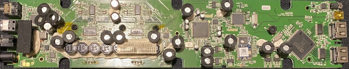

    Failure 3
    This is a crash I`m currently struggling with and I wanted to ask for help. After turning it on "cold", regardless of the selected signal source, you can hear slight noise in the background:
    https://youtu.be/XIJ5ZRHukgM
    Over time, they become stronger, so that after about 3-4 minutes of operation, nothing but noise can be heard:
    https://youtu.be/8D2v8j4QwY0
    Based on the symptoms and manufacturer`s guidelines, the service determined the need to replace the motherboard - the cost was PLN 750. You can also buy such a CD online for about USD 150-170. Basically, the decision was made to write off the beam and replace it with something new, but regardless, I would like to fight a bit - for my own satisfaction. And here`s my question, do you have any suggestions in which direction to look? I was thinking about replacing the electrolytic capacitors, just to be sure, but is that the way to go?
  • Resoldering DSP processor fixed intermittent sound loss
