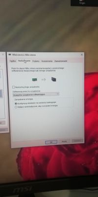

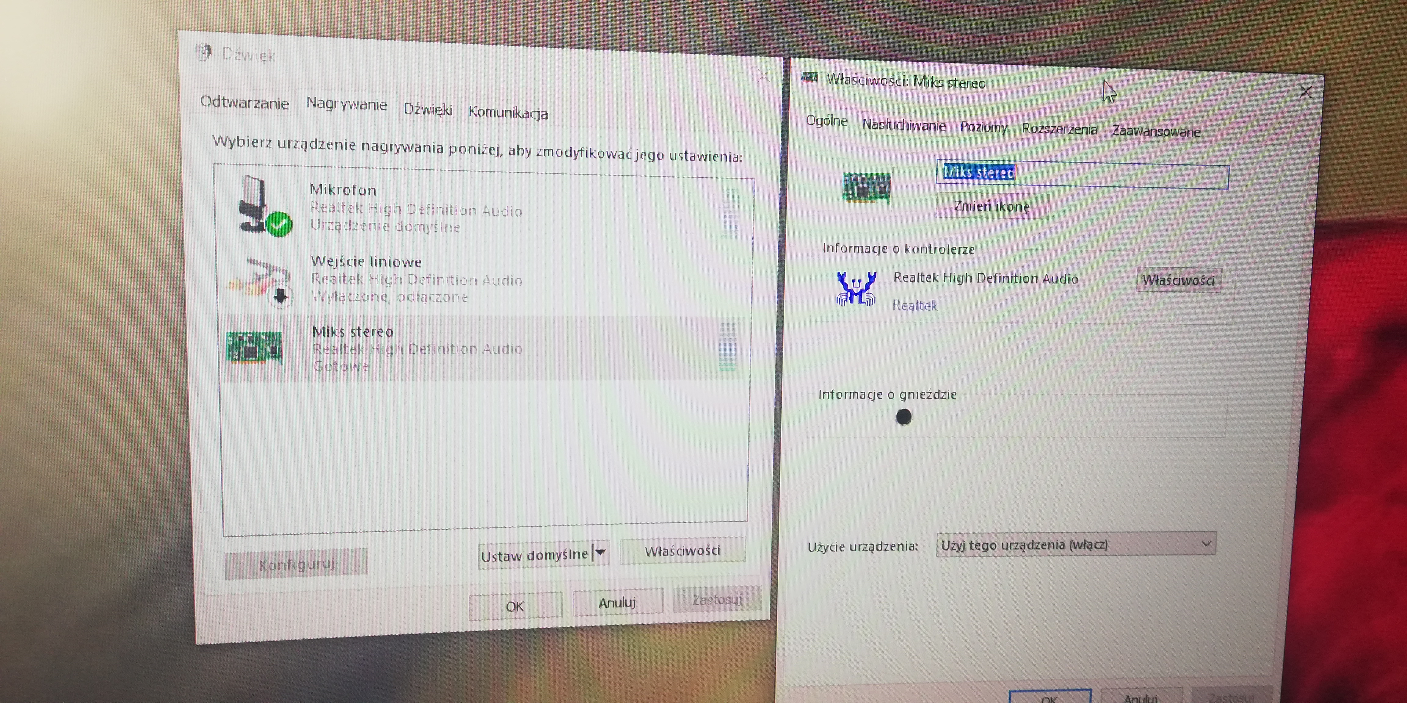

    My problem is this: when chatting on Discord or Skype, my friends can hear all my computer's system sounds, YouTube, notifications, everything. I tried to turn off the stereo mix and unfortunately it didn't help, set the microphone as a recording device in both programs I also tried, which also had no effect, so I'm starting to wonder about buying a sound card, is it sure that it will solve the problem? If so, which one is better to choose external or internal?

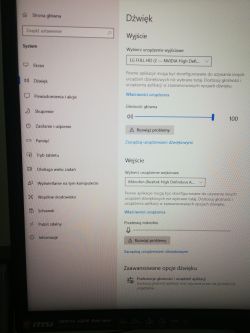

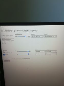

    Show mixer system recording settings.
  • #3 18179872
    Michalstar123
    Posts: 11
    Hearing System Sounds on Discord/Skype: Solutions & Sound Card Recommendations Hearing System Sounds on Discord/Skype: Solutions & Sound Card Recommendations Hearing System Sounds on Discord/Skype: Solutions & Sound Card Recommendations Hearing System Sounds on Discord/Skype: Solutions & Sound Card Recommendations Hearing System Sounds on Discord/Skype: Solutions & Sound Card Recommendations
  • #4 18179876
    ArturAVS
    Moderator
    Posts: 26408
    Help: 2303
    Rate: 7828

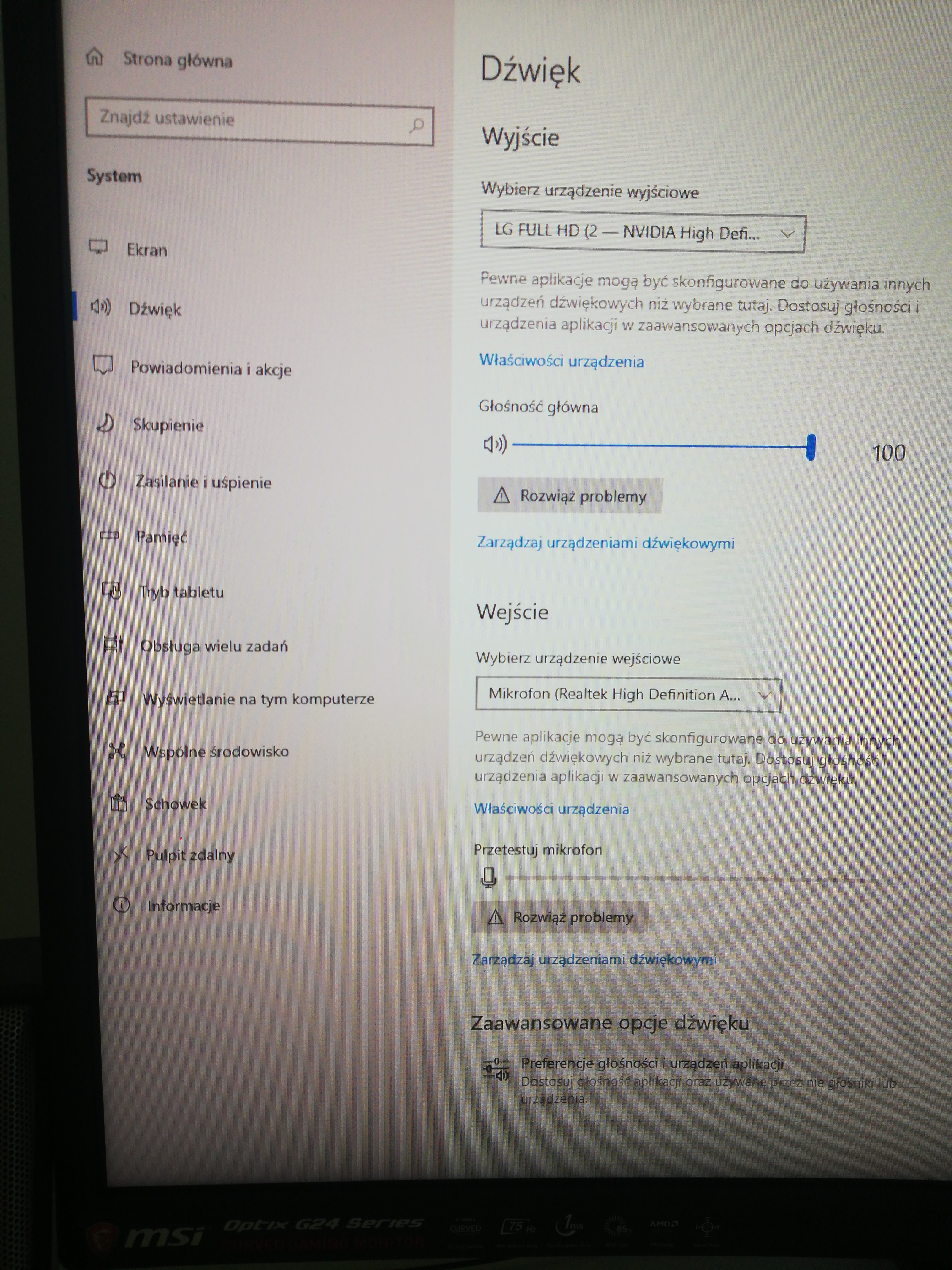

    This is not a mixer. The mixer is after double-left clicking on the speaker on the bar.
  • #5 18179893
    Michalstar123
    Posts: 11
    Was that it? Because when I double click on the mixer, nothing shows up. Hearing System Sounds on Discord/Skype: Solutions & Sound Card Recommendations
  • #6 18179925
    ArturAVS
    Moderator
    Posts: 26408
    Help: 2303
    Rate: 7828
    Go to advanced sound options.

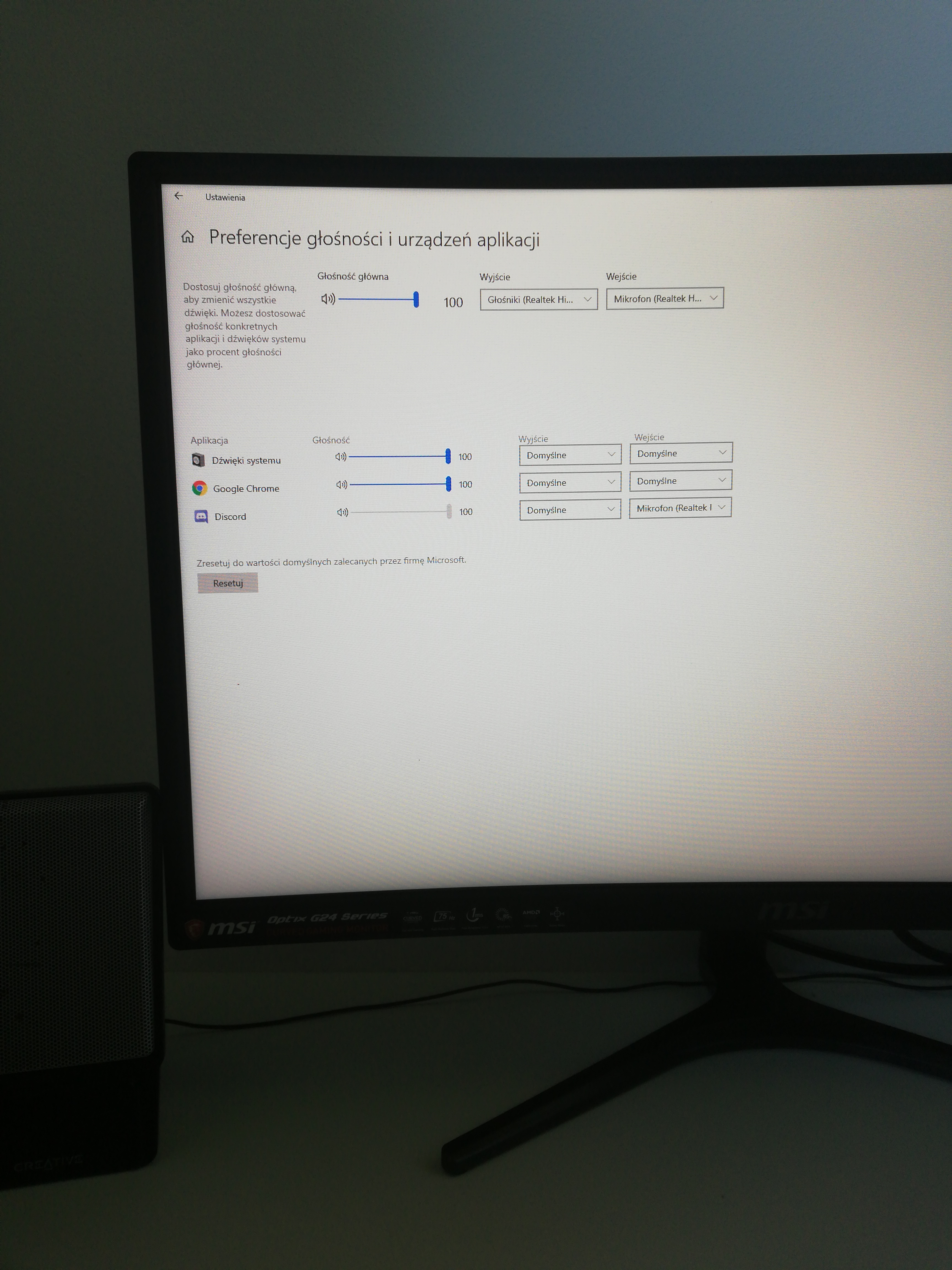

  • #7 18180020
    Michalstar123
    Posts: 11
    • Hearing System Sounds on Discord/Skype: Solutions & Sound Card Recommendations 15691426162057064691692844280757.jpg (4.56 MB) You must be logged in to download this attachment.
  • #8 18180120
    ArturAVS
    Moderator
    Posts: 26408
    Help: 2303
    Rate: 7828
    Set Skype input from default to microphone.
  • #9 18180128
    Michalstar123
    Posts: 11
    I changed it on discord (I use it mostly) but unfortunately nothing has changed.

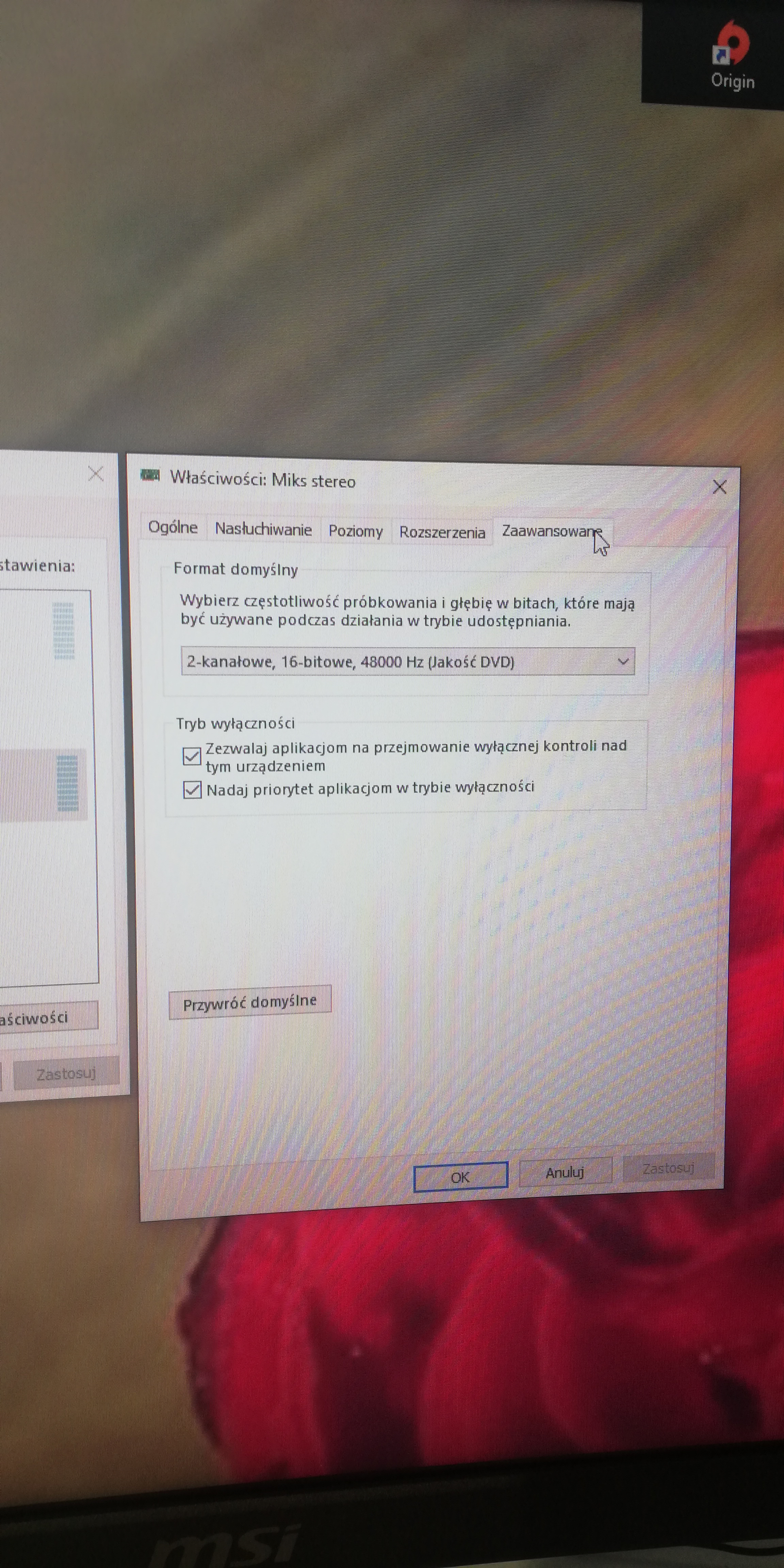

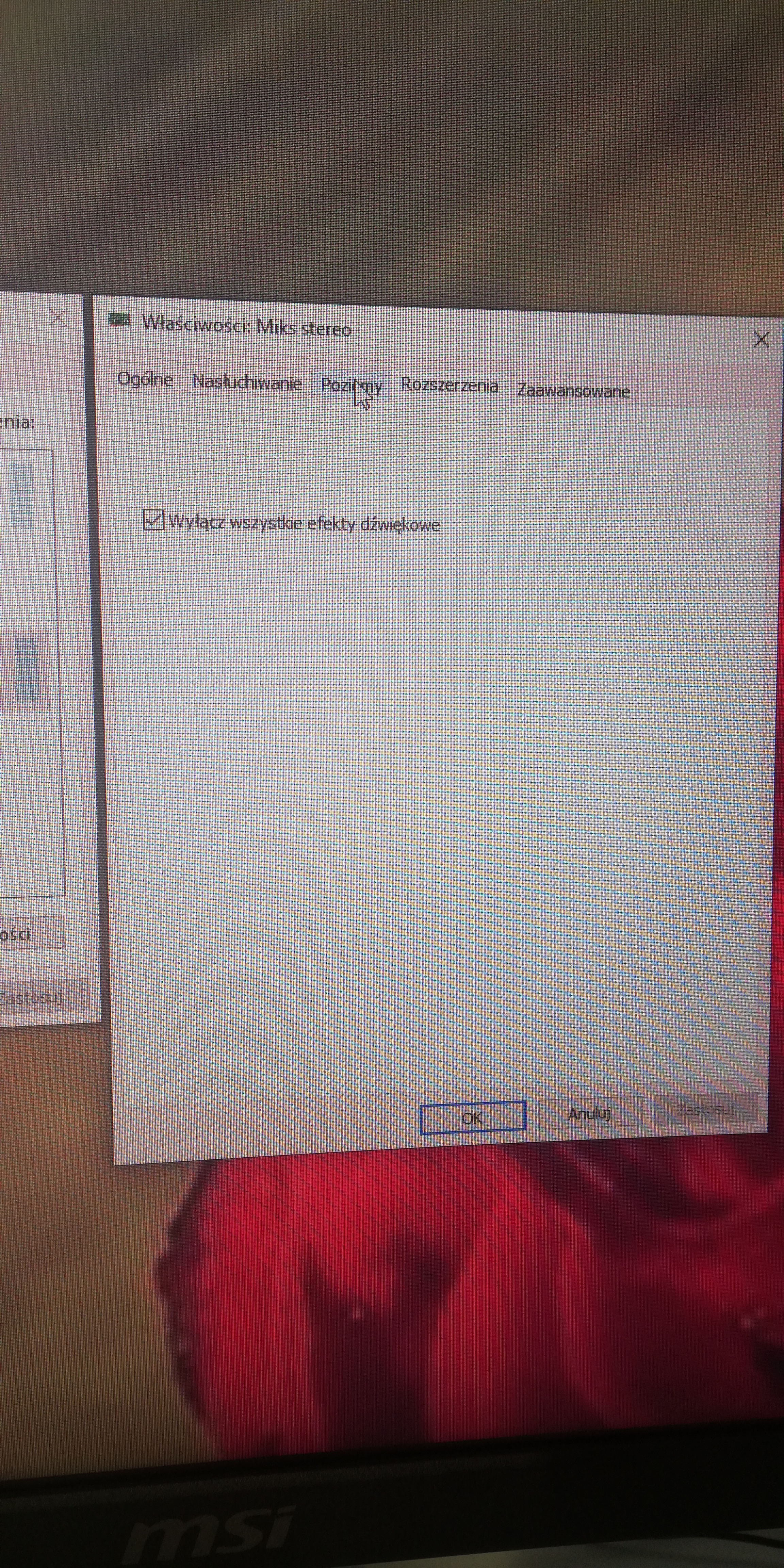

  • #10 18180138
    ArturAVS
    Moderator
    Posts: 26408
    Help: 2303
    Rate: 7828

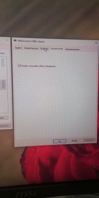

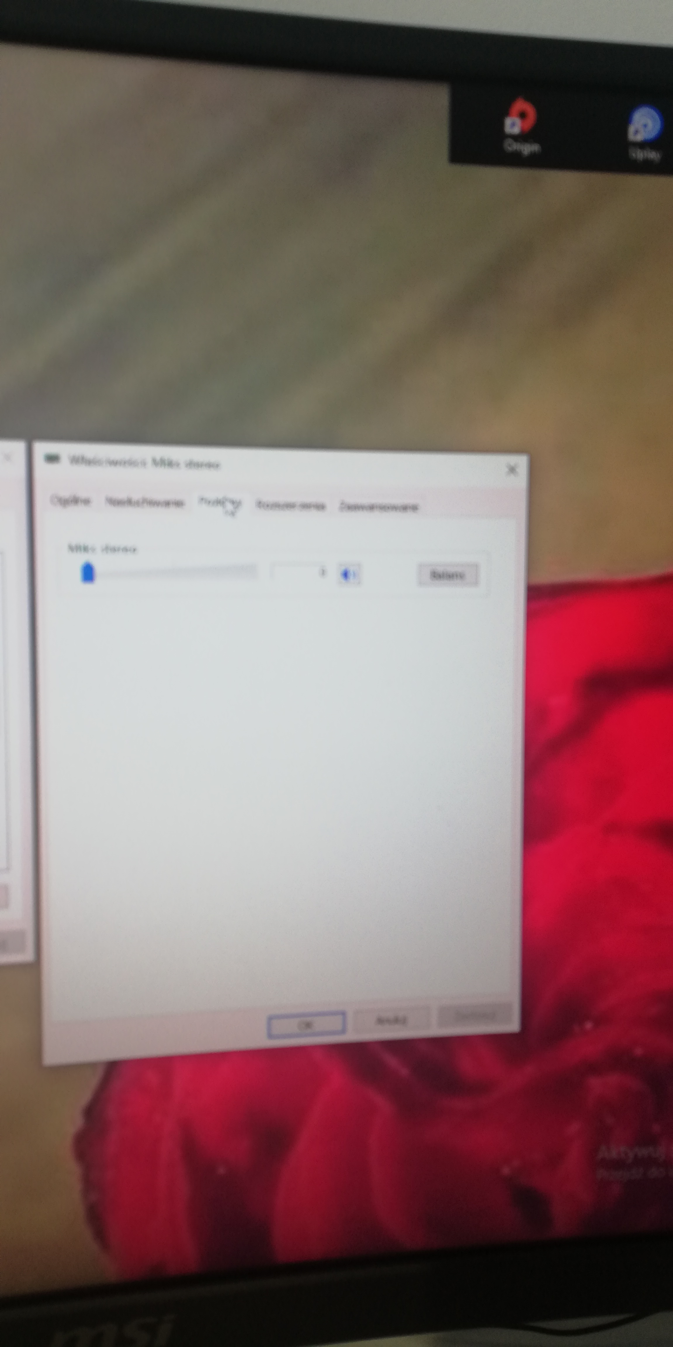

    Then turn off the stereo mix.
  • #11 18180153
    Michalstar123
    Posts: 11
    I turned it off and unfortunately no improvement again but I noticed an interesting relationship: the problem occurs only when I connect headphones to the computer, after connecting the speakers everything works normally
