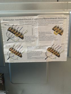

    I'm new to electricity so wanted to get some advice here. Namely, I have an AEG oven with a ceramic hob. The problem is that there is no power in the apartment. Can such an oven be safely connected to a regular socket after processing the cable or buying a ready-made one? I am sending a photo which is attached to the back of the oven. Regards

    You have how to connect the oven to one phase on a tray. Only the socket and the installation to it must have the appropriate load capacity.

    Yes, I understand it, but in the apartment the sockets are all the same and hence my question if there will be no problem if I buy such a cable. Will the protection disconnect me and will there be a short circuit?

    What power cooker with oven and what kind of pre-counter protection do you have?

    We know nothing about your installation (what wires, protections, etc.). There is one rule: high-power devices (2000W) should have a separate power circuit.
    If you have several sockets on one protection, you must take into account that you will not be able to use many devices at the same time when the oven is operating, because the protection (after exceeding a certain power) will disconnect, while a short circuit usually occurs when you have a damaged device.

    An oven with a ceramic hob? Get this device out of your head for a single-phase installation and a power range of probably 5kW or less.

    But why such a column if you can't use it normally and limit yourself at every step? Nonsense.
    It's better to stay with the gas or increase the power allocation and redo the entire power supply.
