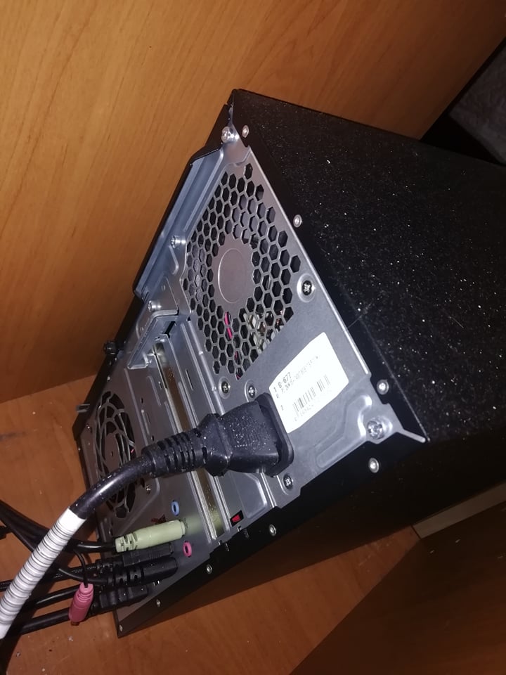

  • #6 18195600
    bubu1769
    Posts: 8063
    Help: 1177
    Rate: 2374
    But which exit?
    Is it on the motherboard or on the graphics card?

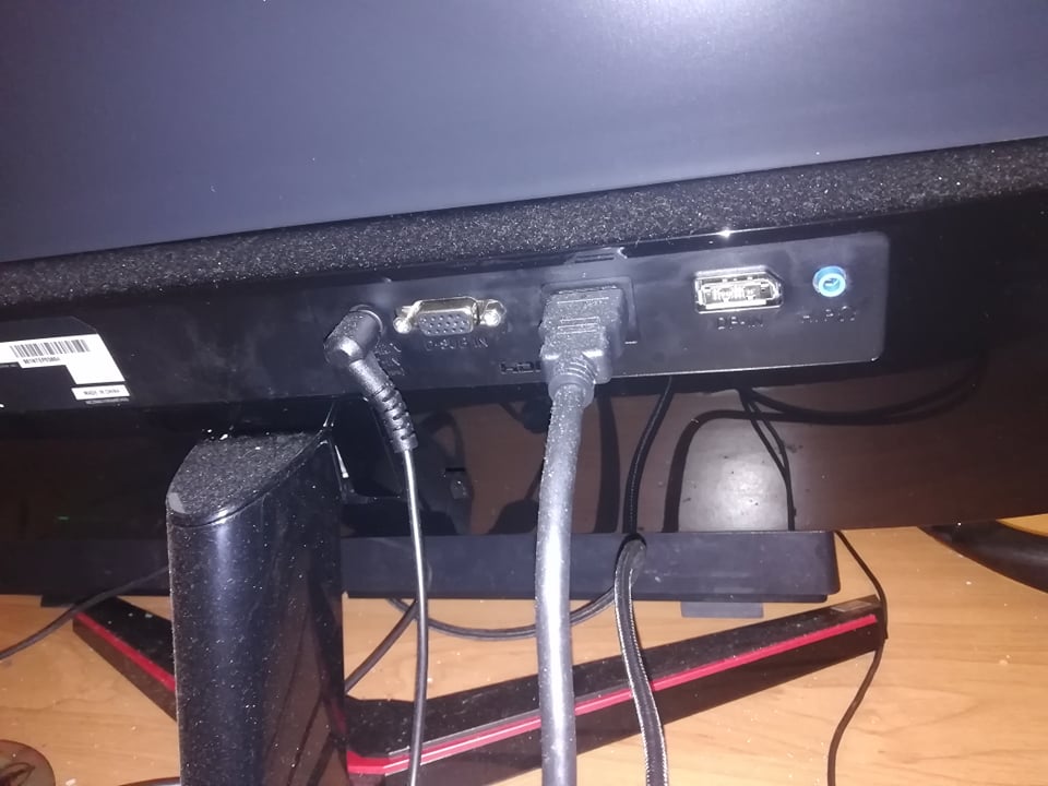

  • #7 18195601
    Enytjoo
    Posts: 7
    I do not understand too much there is a photo in the zalocznik

  • #8 18195609
    bumble
    Level 40  
    Posts: 7189
    Help: 609
    Rate: 1194
    There is probably one monitor output like in laptops. You have drivers from radeon installed. There should be a card panel on the bar next to the clock and this is how the dedicated card is to be set and in which programs. By default, in fullscreen games, it should work. You can also check it there in the card activity panel. I don't know exactly what amd is like. There is also an option to disable the card integrated in the bios, although it may not be here.

    and from what I saw in the monitor, there are probably 2 inputs
    • How to switch the default graphics card from integrated to dedicated 71658054_1495251783958902_8381194263676846080_n.jpg (74.82 KB) You must be logged in to download this attachment.

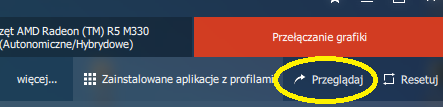

  • #12 18195782
    sylweksylwina
    Posts: 13216
    Help: 1882
    Rate: 2355
    The monitor is well connected via HDMI, there is nothing to draw on.
    1. It is rather impossible to disable the integrated UEFI card, since the image from the radeon probably goes through it.
    2. It is possible to indicate the executable file of a given game / application in this way:
    How to switch the default graphics card from integrated to dedicated How to switch the default graphics card from integrated to dedicated
  • #13 18195812
    Enytjoo
    Posts: 7
    But, for example, in GTA Online in RP I can not play because, as he adds, the game is still played from Intel
    Or, for example, another minecraft is minecraft launcher adds it this way and it does not give anything, because minecraft is launched by some jave.exe, there are many other examples
