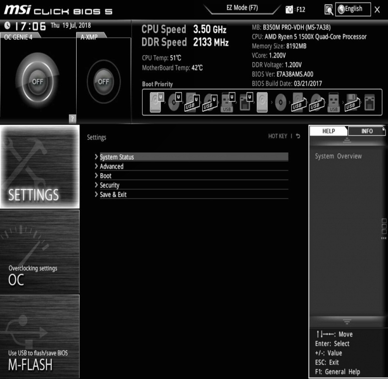

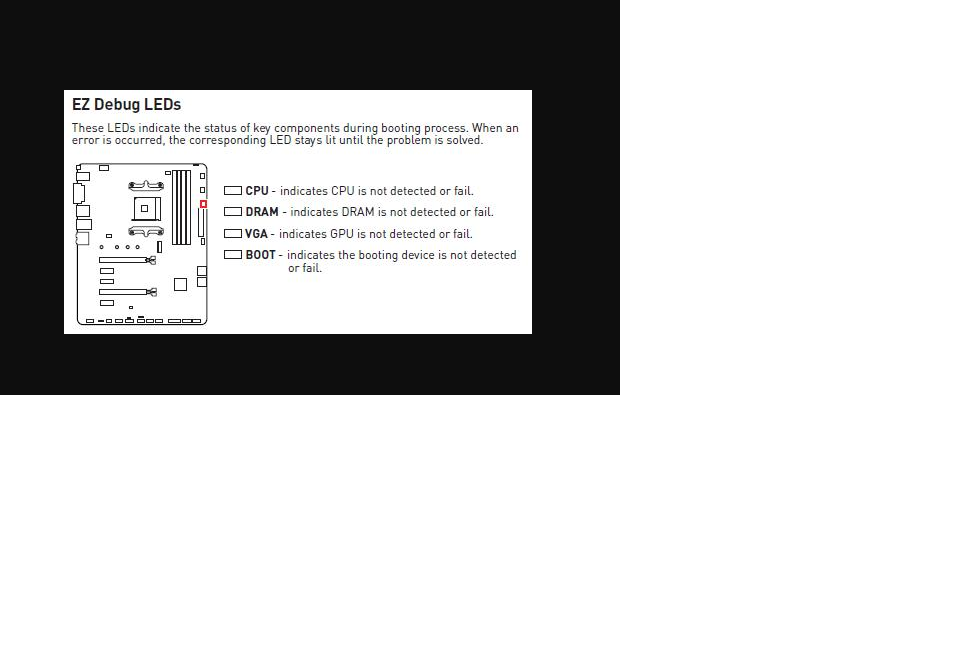

    W starej płycie podłaczałeś kabel 8-pin (dla cpu) z zasilazcem?
    No Display and Constant VGA LED On - GTX 1060 Palit Dual on MSI B450-A PRO MAX No Display and Constant VGA LED On - GTX 1060 Palit Dual on MSI B450-A PRO MAX
    Nowa płyta Link
    - złącze 8-pin dla cpu
    * 6+2 pin and 6 pin connectors on the graphics card
    * dlaczego Max Link
    - z forum MSI o EZ debug: VGA
    Link_ B450 wont POST, VGA light on
    Link_ MSI B350 TOMAHAWK EZ DEBUG CPU LED
    Link_MSI B450 pro vdh - EZ debug LED lights
    Link
    Supports 1st, 2nd and 3rd Gen AMD Ryzen™ / Ryzen™ with Radeon™ Vega Graphics and 2nd Gen AMD Ryzen™ with Radeon™ Graphics / Athlon™ with Radeon™ Vega Graphics Desktop Processors for Socket AM4
    Dla mnie masz problem z cpu Ryzen.
    p.s
    :idea: VGA led lit = it's not finding a video card.
    The VGA debug led (is Red) was on because the GPU wasn't posting ,this is bcoz the graphic card isn't getting sufficient electricity or the appropriate electricity. what I mean by this is either u have to make a stronger volt line or you are using a wrong psu cord head. for eg - I had a US head PSU but I needed a European one. hope this helps. Also this is 90% of the time a problem specifically with a GTX 1060 6GB idk why so nvidia u might want to look into this

    Everything is connected as it should, the processor pins are not bent, and I have already checked the second pcie slot. Dida debugowanis glows white not red
