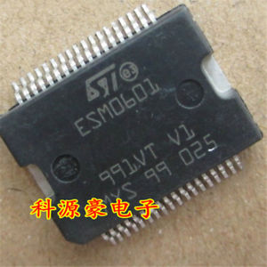

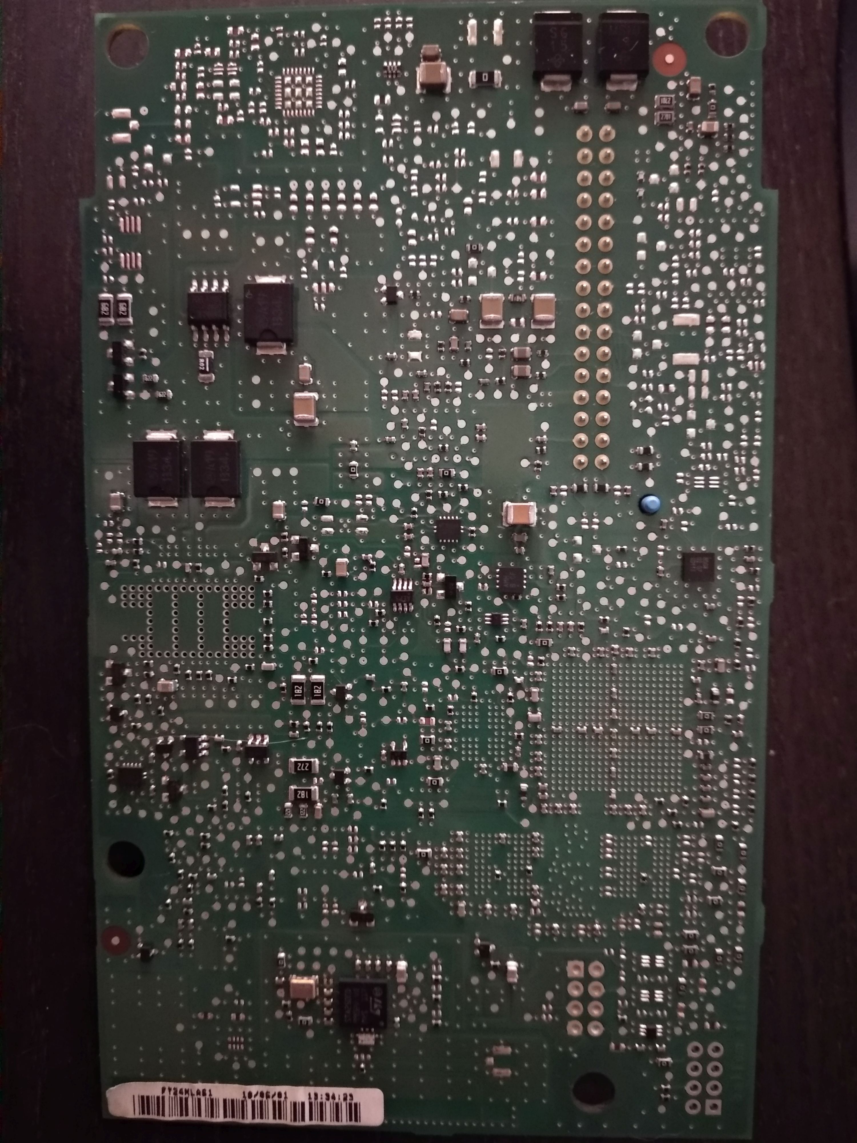

    Hi,
    Blue & Me module. Undetectable by body. The counter flashes.
    I took the disc out of the casing from the clipboard, plugged it in.
    The pendrive plugged into the USB socket blinks briefly every now and then, the circuits on the board are getting warm, but one - ESM0601 - is getting very warm.
    I checked the legs and the 3 closest to the cut corner have a short to ground.
    The layout is attached.
    I can't find a description of this layout anywhere.
    Maybe someone has already had contact with the Blue & Me module and maybe repaired it?
    Attached photos of the plate on both sides.
    • Fiat Grande Punto: Blue & Me Module Detection Issues, ESM0601 Overheating, Short to Ground MB1.jpg (1.65 MB) You must be logged in to download this attachment.
    • Fiat Grande Punto: Blue & Me Module Detection Issues, ESM0601 Overheating, Short to Ground MB2.jpg (1.14 MB) You must be logged in to download this attachment.
    • Fiat Grande Punto: Blue & Me Module Detection Issues, ESM0601 Overheating, Short to Ground ESM0601.jpg (20.36 KB) You must be logged in to download this attachment.

    The question about the chip remains valid: if someone has a datasheet for this system, he could check with his B&M if these 3 pins have a short to ground.

    How you searched for this datasheet :)
    But there is no datasheet for ESM0601 there. There are other models but I haven't found it there. Or I'm blind ;-)

    Friend, you were right, the website referred me to a completely different system with the same number of feet.

    It looks like an audio power amplifier.

    Today I desolder these capacitors and check them with a tester. I will let you know the effects.
    If necessary, they are not expensive, so when I desolder and turn out to be good, I will buy new ones and solder new ones. It won't be worse ;-)

    Pin 3 reads like it is short to ground but it is not. Pin 3 is the current sense for the boost FET (IRF7484Q) on the back of the board. There is a 0.2 Ohm resistor between the source and ground, this is what people are reading and thinking it is a short.
    I have one here and I think these boards have booted but are sleeping/hung. I have both 5V rails and the 4 outputs from the ESM0601 are all present - 3.3V, 2.75V, 1.8V and 1.4V. The 32kHz reference clock is there, the ARM is warm and I think it is running code - there is activity on the bus. The boost circuit is not running but I don't think that is an issue, I think it just hasn't got that far in the boot sequence.
    I suspect it is waiting to speak to the vehicle but can't. I have seen CANBUS transceivers go back in vehicle modules before so I will run down that rabbit hole next.
    Did anyone get theirs sorted?
