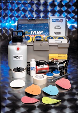

  • #12 5032516
    stany_21
    For the first time with professional removal of scratches, welding spatter, grinding and other damage from any type of glass: tempered, semi-tempered, laminated (car windshields), bulletproof, insulating, bent glass, mirrors and others, I came across in England two years ago . It was the GForce system from the American company GlasWeld Systems. More info at www.glasweld.pl and in my opinion it is a great device. Among other known to me sets for removing scratches offered on the Polish market is the Scratch Hog system also from the American company Glass Technology. More info at www.gtglass.pl. The Scratch Hog system uses abrasives, while GForce removes all types of scratches, even deep ones, without distorting the surface.
