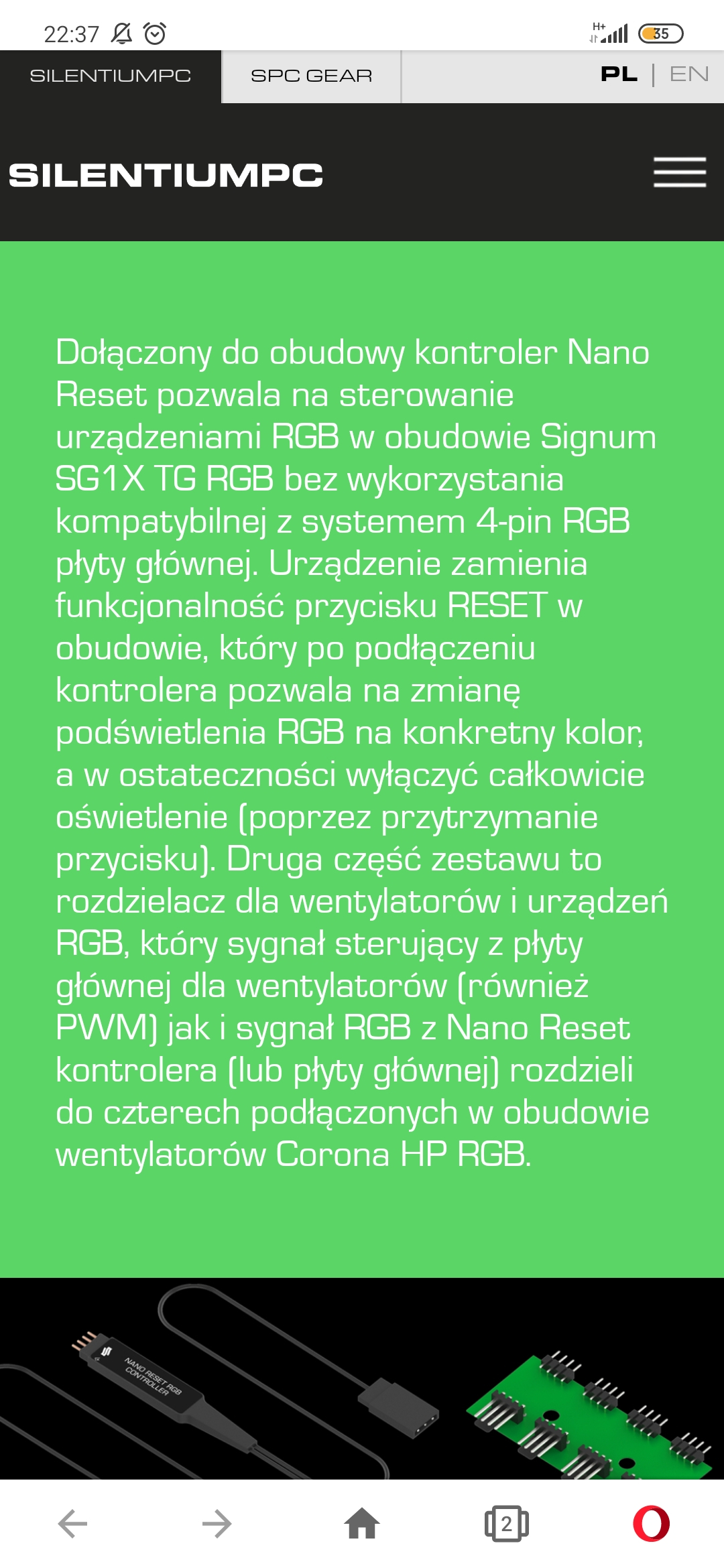

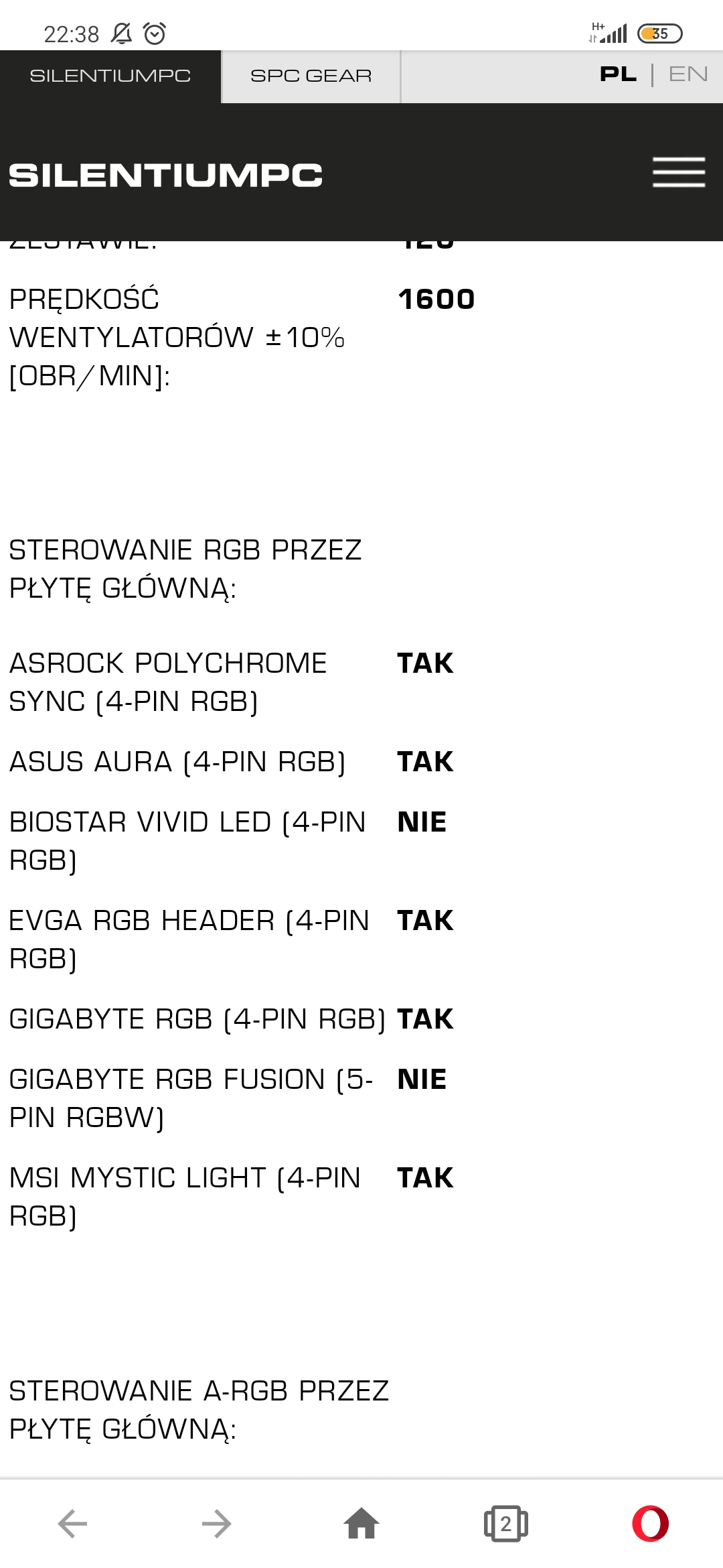

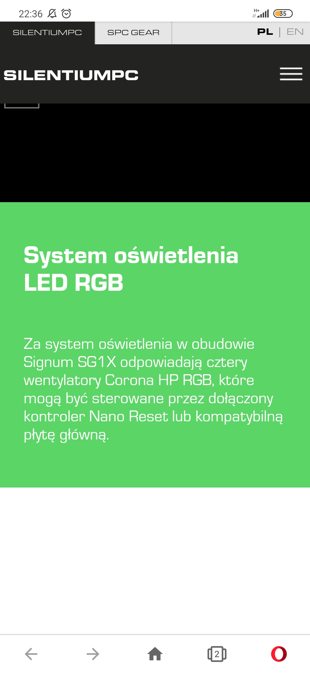

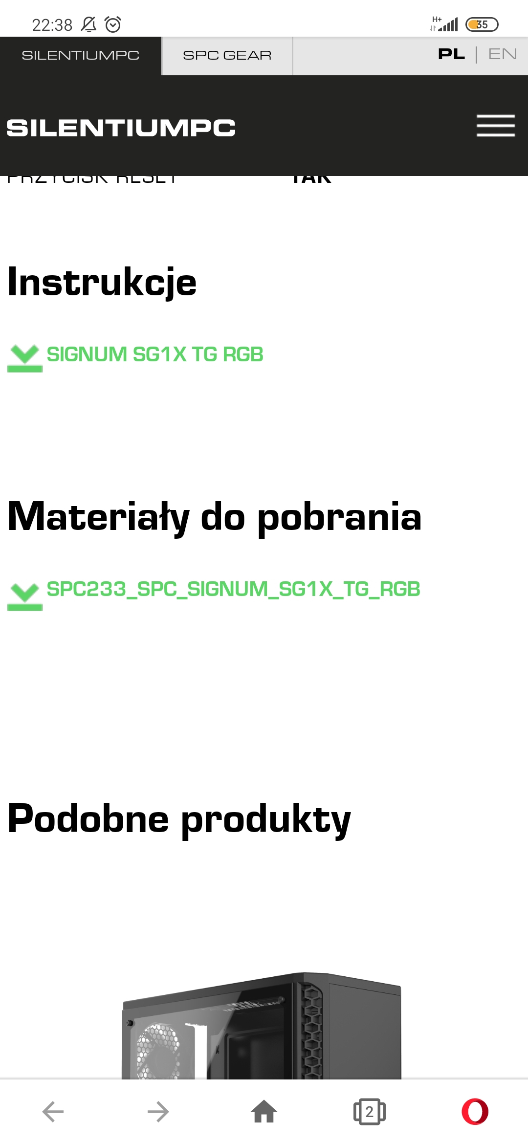

    Hi
    I have a Signum SG1X TG RGB housing and as I was buying a ready-made set on Allegro, I probably did not get a remote control to change the backlight of the fans, and what I read on this page: https://www.silentiumpc.com/pl/product/signum- sg1x-tg-rgb /
    It is possible, but I don't know how to do it, please help.

    MSI B360M motherboard
    I was reading it with understanding and it doesn't tell me much.

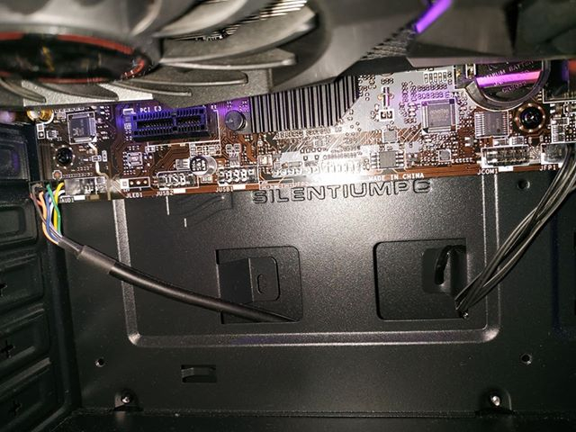

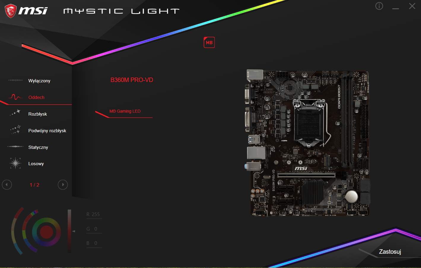

    Changing Fan Illumination Color on Signum SG1X TG RGB Without Remote Control
    this is what it looks like for me, only the backlight of the motherboard works, i.e. a thin white line as you can see on ss

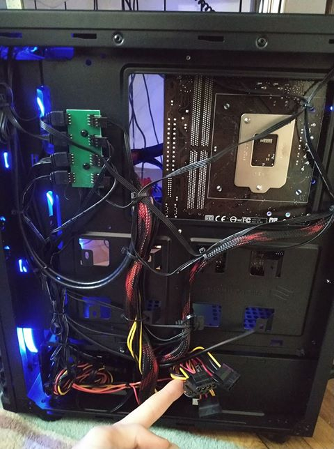

    I just don't know what it is, I would like to read this manual but I didn't get one, I didn't get anything except two driver CDs.
    Added after 7 [minutes]:
    this is how it looks for me, it's the only free slots to connect something, they are under the graphics card, there are no free spaces above the card
    Added after 5 [minutes]:
    and this is what it looks like from the other side

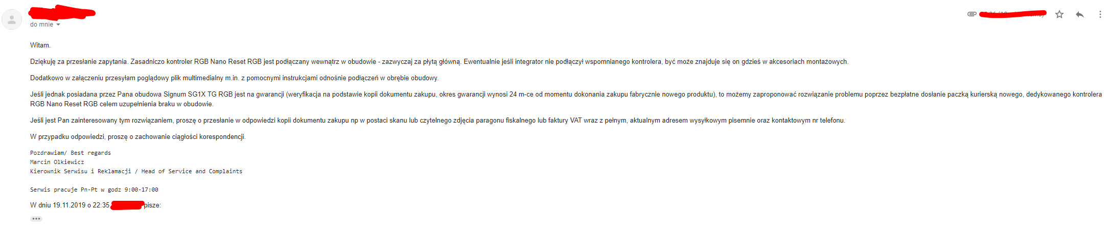

    Added after 1 [hours] 53 [minutes]:
    the solution is on ss Changing Fan Illumination Color on Signum SG1X TG RGB Without Remote Control
