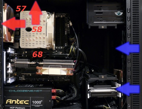

    I have one more question. I don't quite know how to connect the fans. I mean, which sockets to use so that the cables in the housing make sense. I want to do something like this in the housing:
    MSI Z270 Tomahawk Motherboard: Correct Front Panel Connection Pin Numbering and Guide

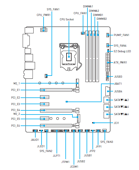

    The distribution of fan sockets is as follows:
    I mean mainly additional fans. I have cooling under CPU_FAN procka processor.

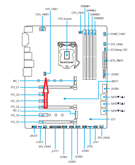

    Put the cables down, they will not interfere with anything and disturb the air flow (we are talking about the fans at the front of the case).
    Connect to SYS_FAN2 and SYS_FAN3
    Connect the exhaust air fan on the back of the case under SYS_FAN1

    Oki, and where to connect this fan on the TOP - also extracting warm air? Under SYS_FAN4?
  • #8 16621602
    RADU23
    Posts: 20718
    Help: 2428
    Rate: 1732
    You can. Try not to let the cables hang loose like a spider's web, but to keep them as close to the board as possible.
    Then there is order and they do not disturb the air circulation in the housing.
