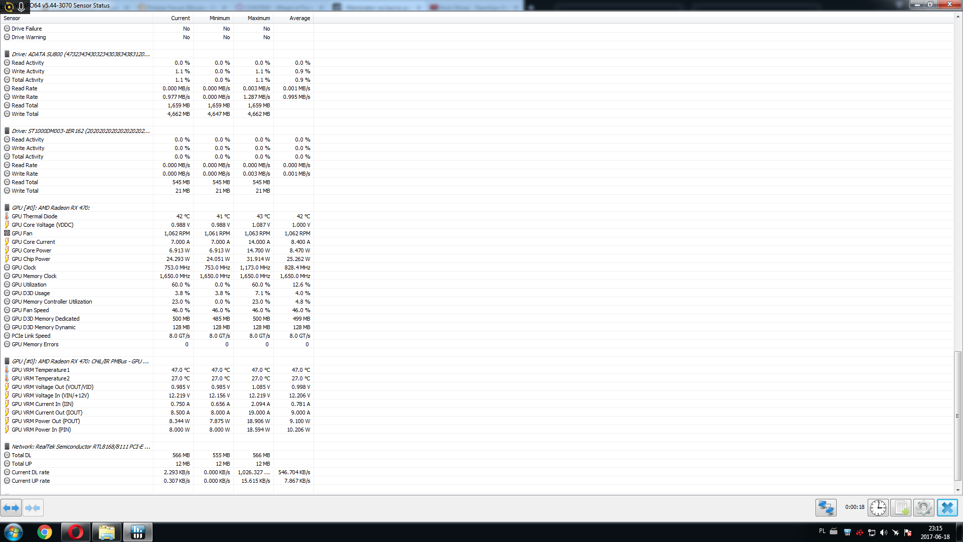

    Hello!
    When turning on the computer, the fan turns off for a moment and stops when Windows starts. Then (already with Windows turned on) it does not spin at all, regardless of the temperature. Interestingly on Linux it works normally (at least it does not spin). MSI Afterburner
    I set this fan somehow and it works - the fan is spinning, but I would treat it as a temporary solution. Immediately after turning off MSI Afterburner, the fan stops spinning. How can I make this fan spin normally on Windows without any unnecessary programs?

    Venesky
    Posts: 51
    Graphics Card Fan Not Spinning on Windows: RX 470 Power Color Red Dragon V2 & MSI Afterburner
    With MSI Afterburner disabled

    Venesky wrote:
    Right after turning off MSI Afterburner, the fan stops spinning.
    OKAY.
    Now turn off MSI and post the screen again.
    How do you perform a stress test for the graphics card, with MSI turned off, the fan will start to rotate after exceeding a certain temperature or not?

    Venesky
    Posts: 51
    I prefer not to test, but today (as I did not know yet that the valve is not turning) I started CS: GO it was 87 degrees. I guess it was not spinning, because I have not had such a high temperature at home yet.
    On this card, as far as I know, the fan starts to run at 60 degrees.

    310artur
    Posts: 9002
    Help: 980
    Rate: 670
    To be sure, try cleaning the drivers with DDU and reinstalling.

    Venesky
    Posts: 51
    Thanks, it works :D
