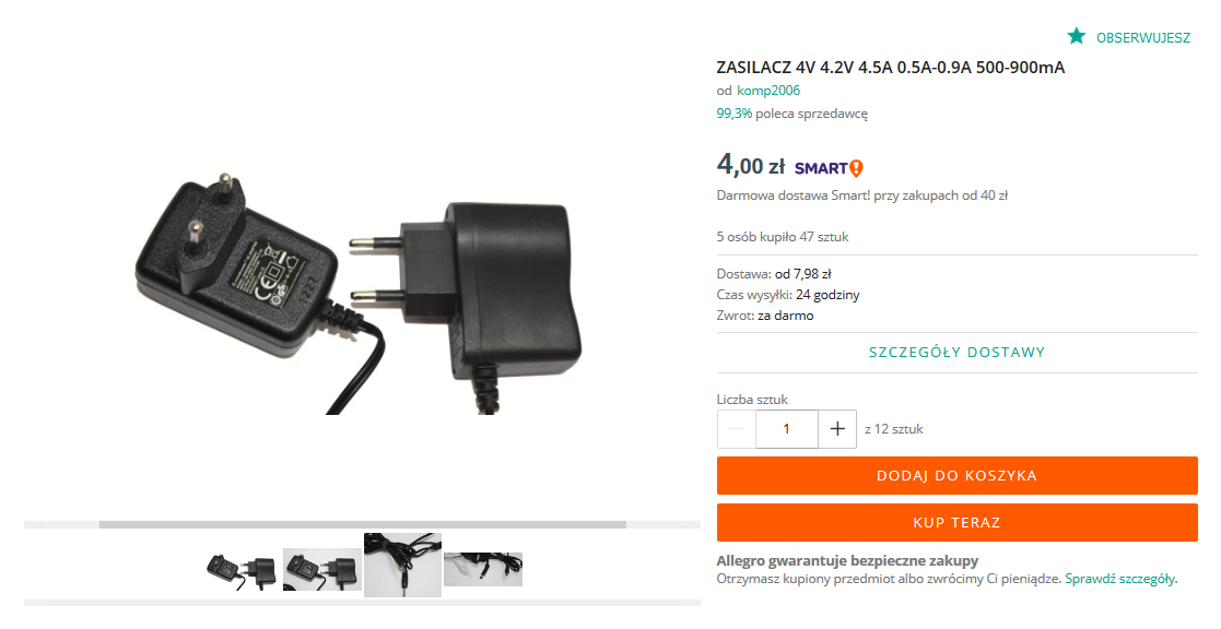

    Here, the guy from allegro sells for PLN 4 about relatives
    parameters:
    Ikea lamp power supply (NÄVLINGE) KMV-040-030-GS replacement I am looking for
    I'm a total amateur but I don't like to throw things away until I've made some attempt to treat them. I took the lamp out from someone in a damp basement and after cleaning it worked for a while but quickly fell. I'm assuming it's the power supply. The one from the allegro has a different tip but I wanted to cut it live, also cut the one from the lamp and connect the wires and see what happens. If it worked, solder it. What do you think?

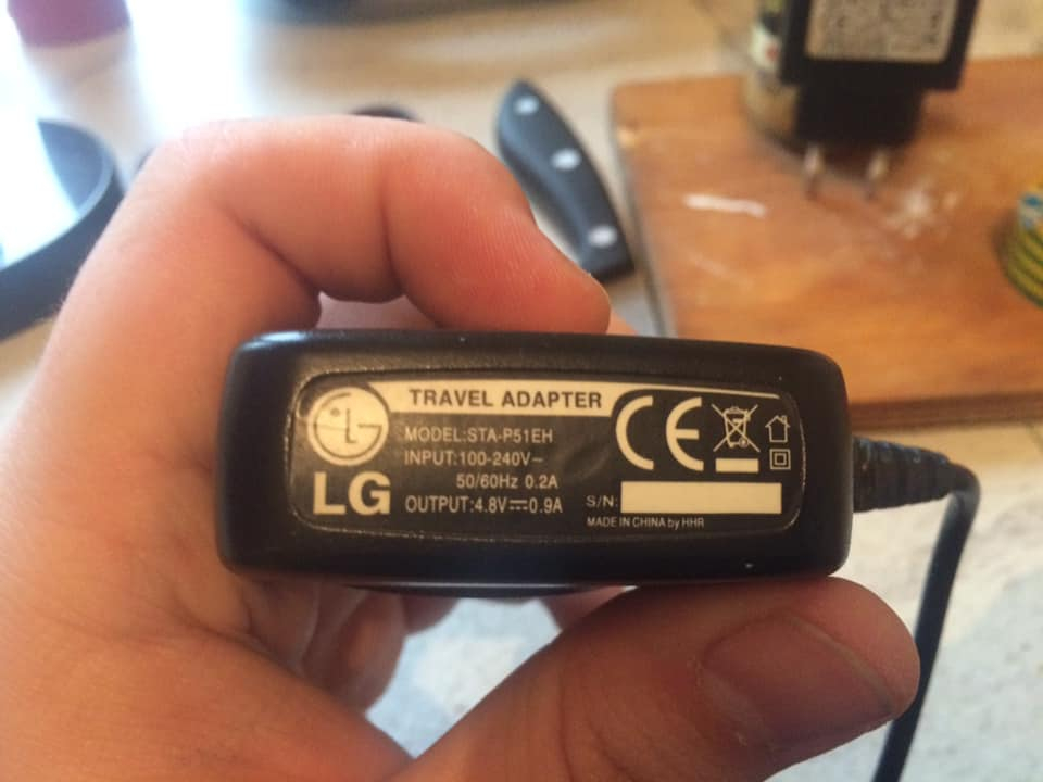

    I decided to use an old LG phone charger with a wide output, probably from 2000:

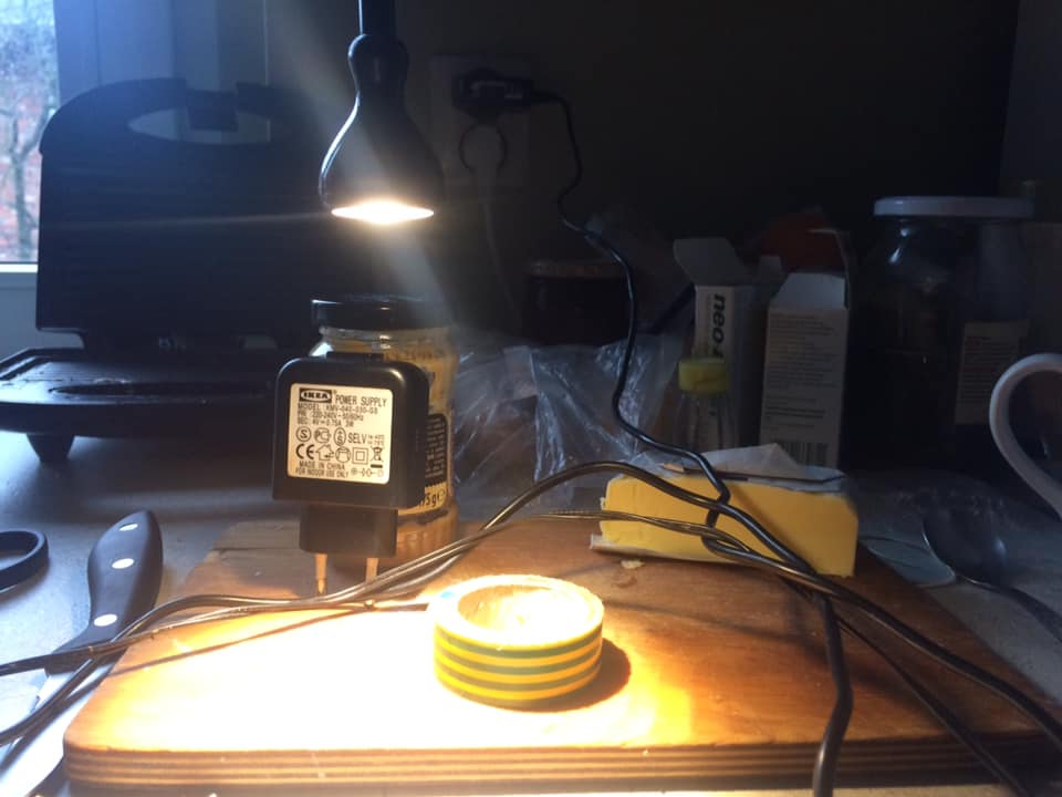

    I cut off the tip in this charger and it was a 10 because these old chargers have quite thick wires that were quite easy to separate and we have red (-) and white which is a plus (+) and I connected it to the original plug that goes into the original power supply . The plug has a thin and thicker pin, everything is described on the power supply and the socket has the right shapes of plus and minus, it's possible to figure out which is which.
    after isolating the wires from each other so that they do not touch each other, I wrapped everything with insulating tape and welded it with a lighter and I won't even solder it. Topic to be closed. I also recommend Nokia chargers with a thick pin.

    I used a 4.8V LG phone charger
    the same parameters have a charger from nokia with a thick pin
