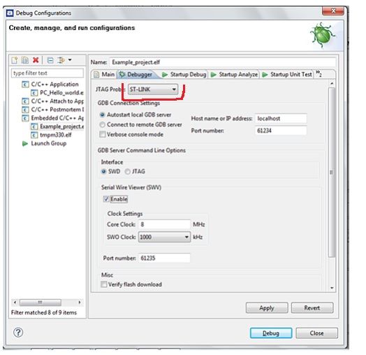

  • #6 18334507
    vp32
    Posts: 505
    Rate: 47
    Can you help me?
    I don't understand why I can't connect to uC using ST-LINK.
    SWD pins PA13 and PA14 are free, I don't have them occupied. In Cube they are set as SWDIO and SWCLK. Supposedly, this setting does nothing other than not assigning pins to other purposes.
    In TrueStudio, there is always an error after trying to establish communication
    Error in initializing ST-LINK device.
    When I run ST-Link Utility, it does not connect either, but after pressing RESET, it manages to establish communication with the board.
    What's the deal with Connect Under Reset, why can't I connect via Debbuger in TrueStudio?

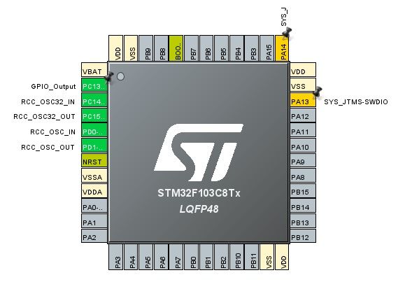

    vp32
    Posts: 505
    Rate: 47
    Ok, how to fix it?, The chip is STM32F103C8Tx

  • #10 18334938
    vp32
    Posts: 505
    Rate: 47
    Title: STM32 Serial Wire Viewer & Output, ST-LINK: Beginner Questions on SWO, SWCLK & Reset No changes unfortunately :-(
    Sareph wrote:
    A, then not in port A, because there DP is configured in AFIO->MAPR
    I don't understand what you mean, if not on A then on what.
    I took PA13 and PA14 from CubeMX. See drawing.

  • #11 18334959
    Sareph
    Posts: 638
    Help: 65
    Rate: 378
    Your Cube configuration indicates that you have SWD *disabled*. Go under device SYS, there enable debug on SWD or async trace if you want SWO. Merely marking the pins here does not give you anything. (Orange - pony reserved but device is not turned on).

  • #12 18335112
    vp32
    Posts: 505
    Rate: 47

  • #14 18342282
    vp32
    Posts: 505
    Rate: 47
    Okay, something happened after changing SYS to SW Debug.
    But that gave me another question. Because setting this SW Debug causes the function to be called
    Code: C / C++
    Which registers AFIO->MAPR 0b010 at [26:24]
    If I don't set SW Debug it will be entered into these registers
    Code: C / C++
    So they will be ordinary GPIO
    But why, after all the initialization done by CubeIDE, I type it manually
    [syntax=c]AFIO->MAPR =(0b010

How do I enable SWO/ITM on an STM32?
Enable ITM in firmware or let your debugger do it. Configure the SWO pin to its alternate function. When unused, that pin can act as normal GPIO. Many IDEs (e.g., Atollic TrueSTUDIO/CubeIDE) can auto‑init ITM and SWO during attach. Redirecting printf to ITM/SWO is a common setup. [Elektroda, Sareph, post #18331006]

How do I enable SWD on STM32F103 in CubeMX/HAL?
In CubeMX, set SYS->Debug to “Serial Wire.” HAL then calls __HAL_AFIO_REMAP_SWJ_NOJTAG(), setting AFIO->MAPR SWJ_CFG bits [26:24] to 0b010. That disables JTAG‑DP and enables SW‑DP. This restores PA13/PA14 for SWDIO/SWCLK. [Elektroda, vp32, post #18335112]
What’s the STM32F1 default debug state after reset?

In CubeMX, why isn’t selecting PA13/PA14 as SWD pins enough?
Pin tagging alone does not enable the debug block. You must enable SWD under System Core -> SYS -> Debug (SWD or SWD+Trace). Otherwise, the pins remain regular GPIO and the debugger cannot connect. [Elektroda, Sareph, post #18334959]
