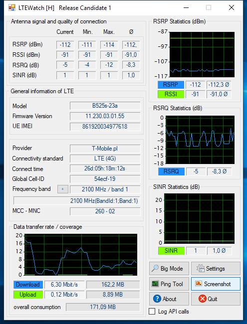

    BTS should be modernized and refarmed at 1800 / 2100MHz. You should check on the B525 what bands work on it. Previously, there was only carrion on LTE800, possibly LTE1800 and LTE2100 on it. on B525 the bands are managed via http://www.mediafire.com/folder/95m83y3qalgbv/B525s_-_23a for Android or https://www.lte-anbieter.info/ltewatch/count_huawei.php?Datei=ltewatch_h for Windows . They choose lTE2100, LTE1800 and LTE800 in turn, you can also check LTE2600. They show the signal parameters, eNB and CID of the BTS. In addition, on each of the speedtest bands. replacement of B525 justified when LTE2100 and LTE1800 are already running on the BTS and LTE1800 + 2100 aggregation. B525 does not support this LTE band aggregation only LTE1800 + 800 and LTE2100 + 800. At 3 km from BTS, an external antenna for LTE capacitive bands is also used, without it there is no chance for a radical increase in speed.

    There is nothing to understand here, you have to check the LTE bands on the BTS because it is crucial when choosing the equipment and antenna. Signaflex is crap, the description is a load of rubbish and the gain of 20dBi is a fingerprint. Broadband antennas with H155 cable have a gain of about 10dbi depending on the frequency.

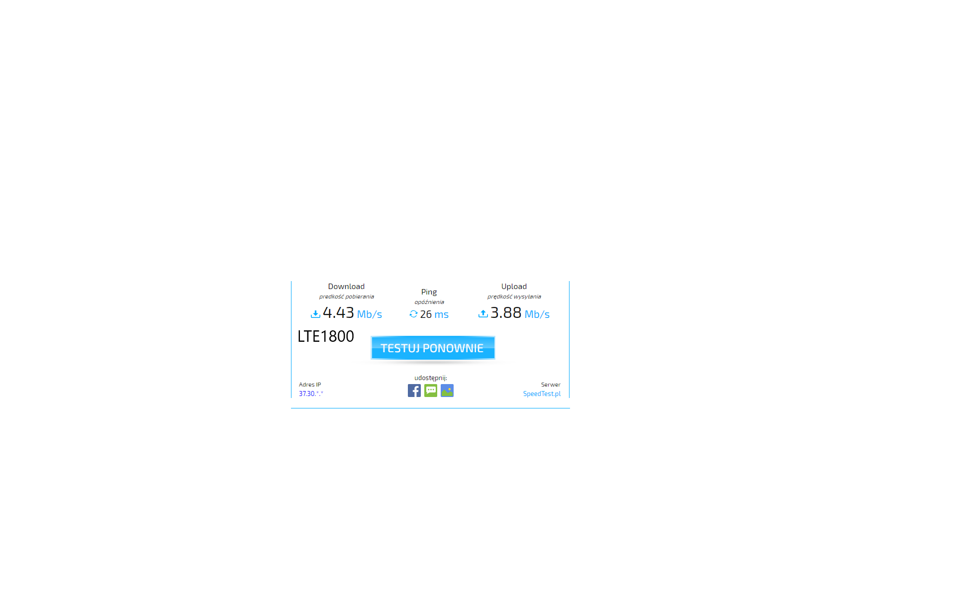

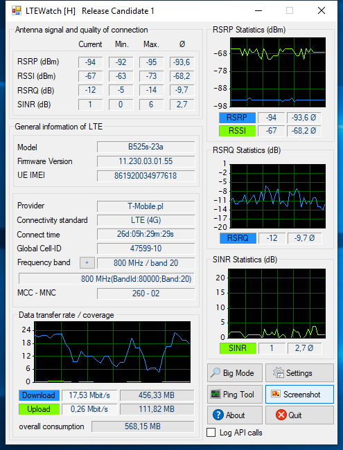

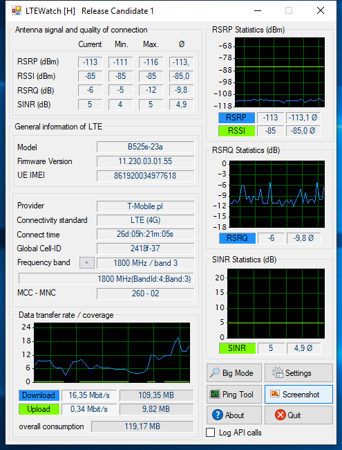

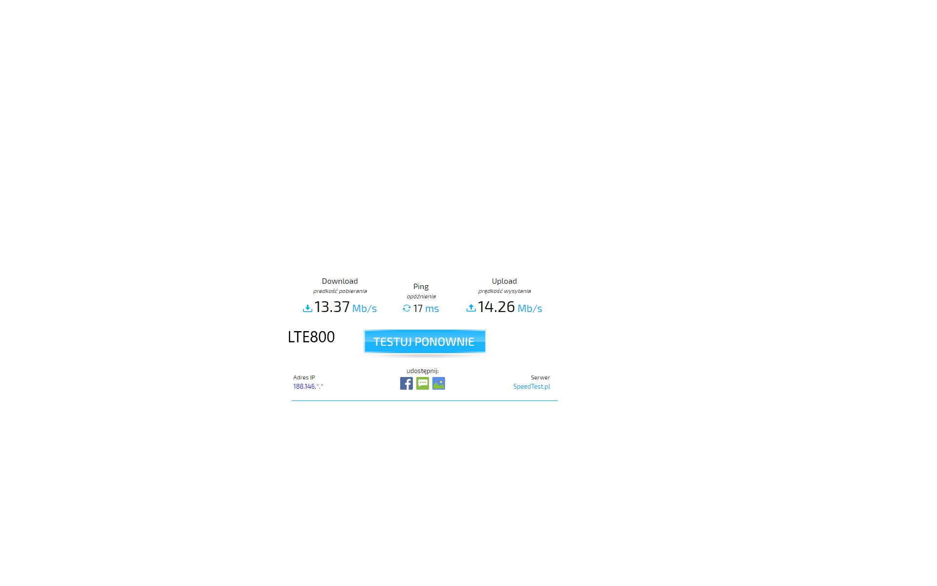

    As you said, I did tests with a frequency forcing program and the best results are LTE800, the speed of 18DL / 13UL, LTE 1800 is also not the worst, it shows 13DL / 8UL. Insert screenshots?

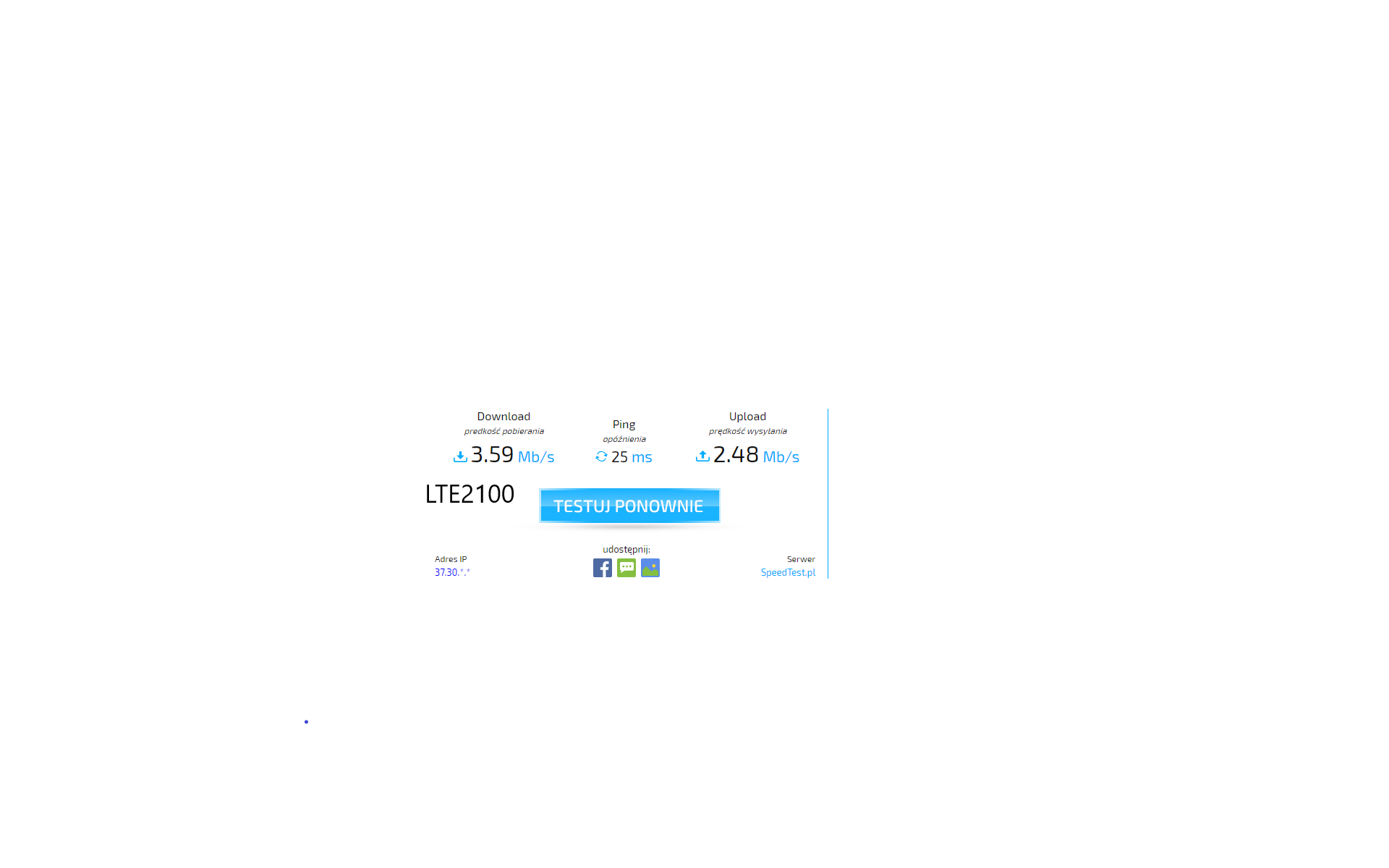

    Show screenshots with signal parameters and BTS data for lte1800, LTE2100 and LTE800. speedtests only those from 19-23 are important when the network is overloaded. Now, few use the Internet.

    In that case, in the evening I will do tests and post screenshots.
    Added after 3 [hours] 2 [minutes]:
    What to buy a T-Mobile router What to buy a T-Mobile router What to buy a T-Mobile router What to buy a T-Mobile router What to buy a T-Mobile router What to buy a T-Mobile router
    I think a pretty good result for LTE800 at 19:40 Friday, the router only on the internal antennas of the small ones.

    You are not running out of anything, you let the consultants wave you around like a little child. The contract concluded for a period of 24 months after it passes for an indefinite period at the same price, i.e. if you have no limit of up to 20Mb / s for PLN 45/49, you can continue using the same conditions. if you want to resign yourself, you can terminate the contract with a 30-day notice period. Of course, if you are satisfied, you do not do anything but continue to use.
    On LTE800, it is not any BTS from Tłuchówek but Bądkowo Kościelne, the signal is sufficient. DL
