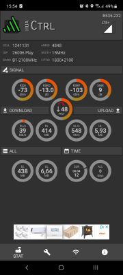

    Hello, I would like to ask you a question about the TCL Linkhub HH130v1 LTE router, I have 4G Internet in Orange and my contract is expiring, I am considering choosing a new modem, currently I have Huawei B535. I use a transmitter located almost 7KM away using a double directional external e-waste antenna. I have forced 2100 2600 and the internet works at 20mb-30mb/s, Ping in online games is quite satisfactory. The range at 2100 is 2 lines, 2600 is barely there, but it`s still the best configuration from what I tested. I call the antenna "electronic waste" because after setting it to 800, 1800, 2100, it somehow pulls the signal from a remote BTS in the opposite direction, which has the 800 1800 bands. I wonder if using a router that aggregates 4 bands (I mean TCL Linkhub HH130v1 LTE, but I`m not sure if this is actually the case because I can`t find the specification for this thing) will be able to download the signal from the BTS located 6 km away on 4 bands. And here I have an important question, does anyone know if there is any software for this router that allows for band enforcement.
  • Forced 800 MHz band selects distant BTS aggregation

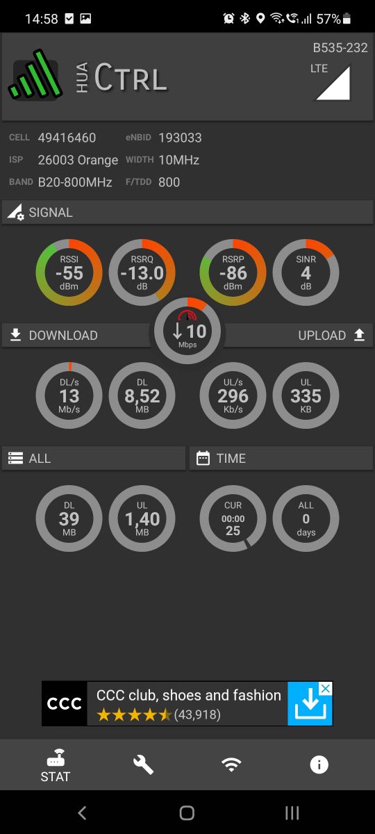

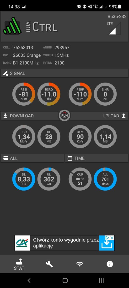

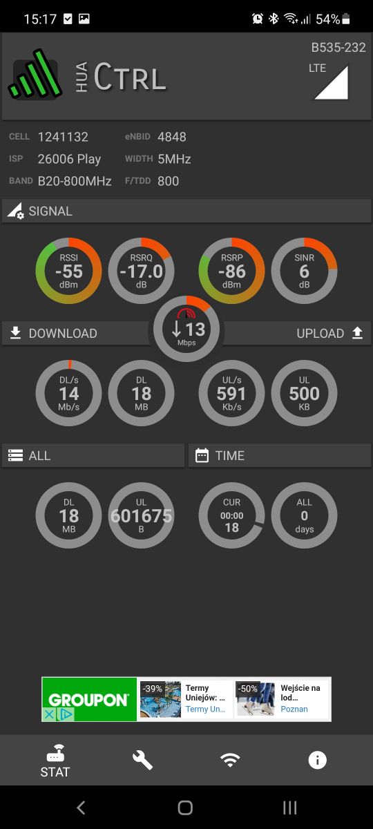

    And first, I would like to ask for screenshots of the band management application on the B535 for each LTE band in turn, i.e. LTE2600/2100/1800/800. These technological wonders from Signaflex for Kołaki/Wola? You checked in the direction of Regimin.
  • Regimin bands unavailable; modem falls back to Kołaki
    #8 19834059
    Glelin
    Posts: 27
    These wonders are located in Regimin, I have never tried it on my own, moving the antenna to the other side of the building is not very practical for me. And I rather reject BTS in Kołaki, it seems to me that it is quite crowded.

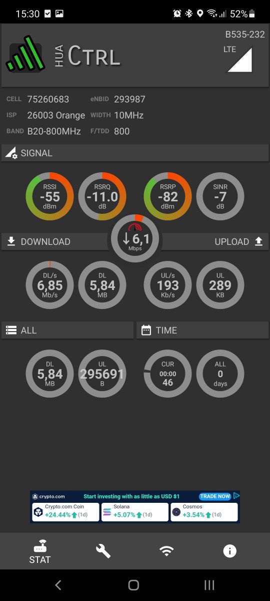

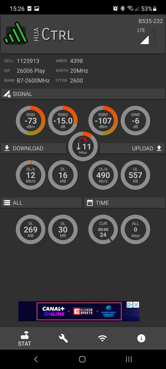

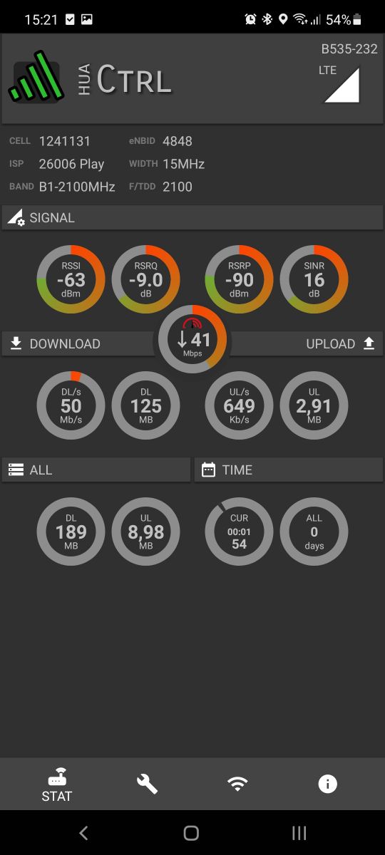

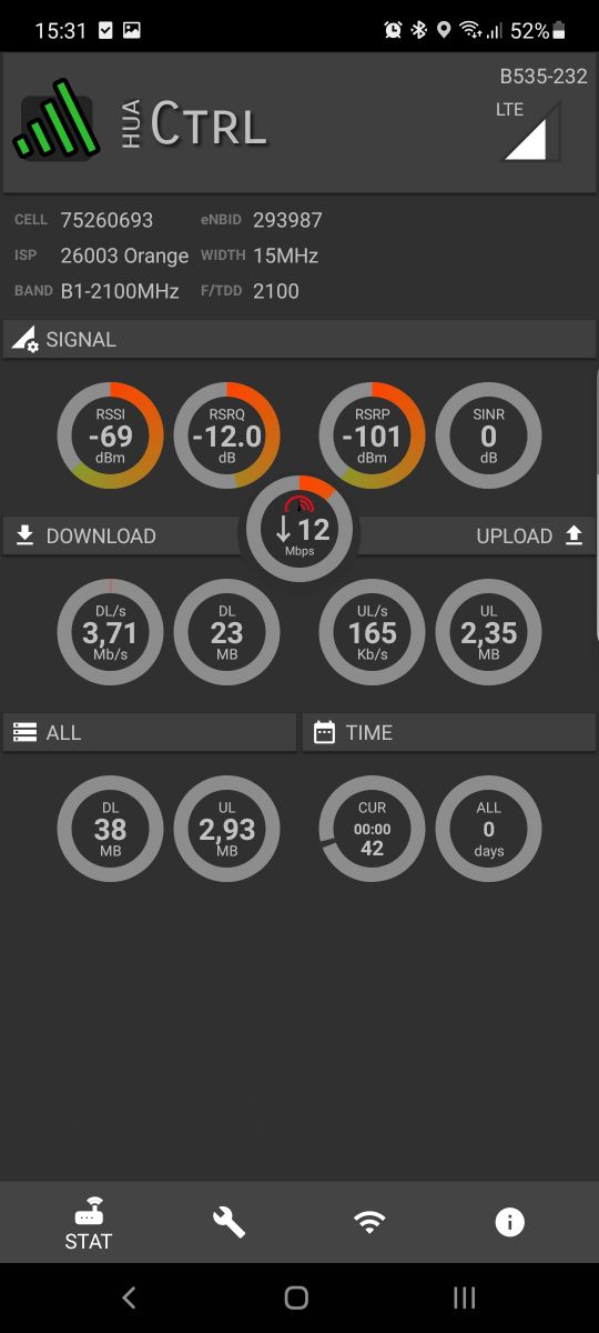

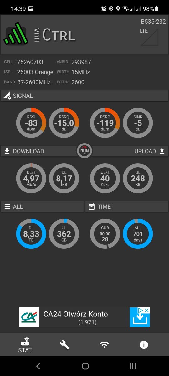

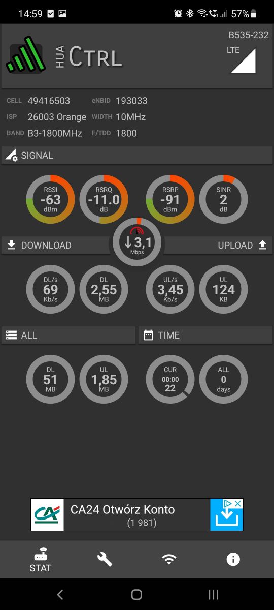

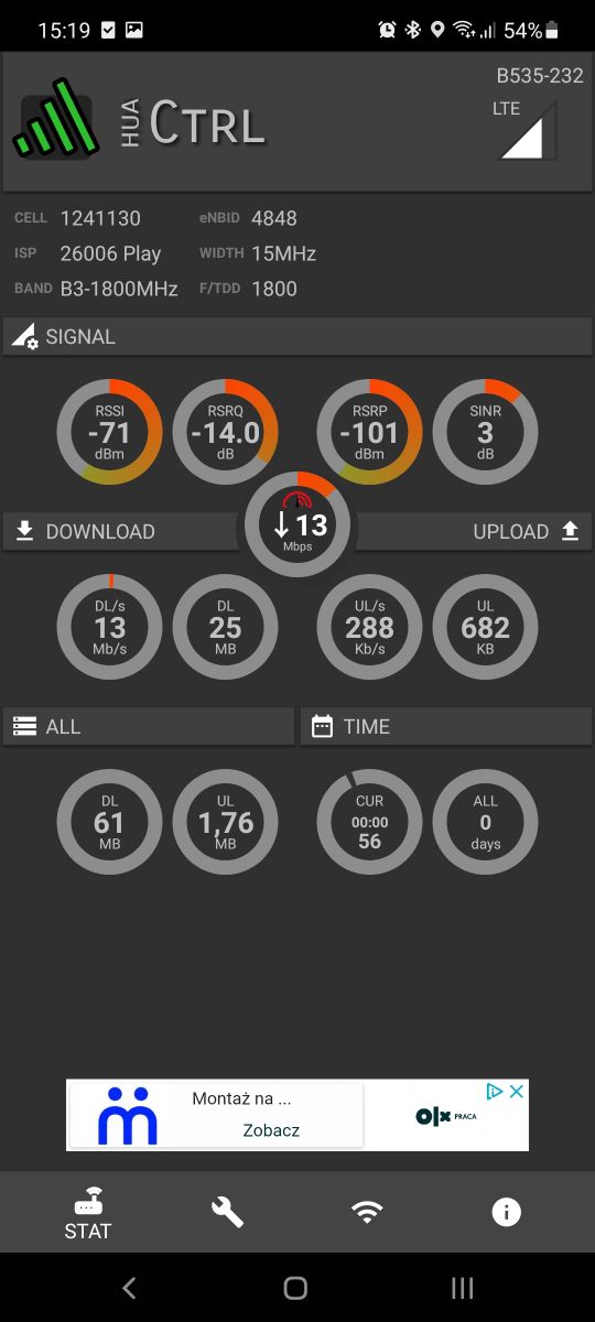

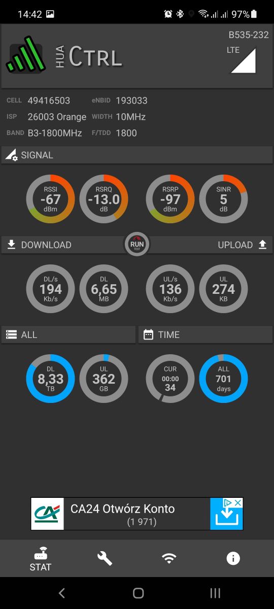

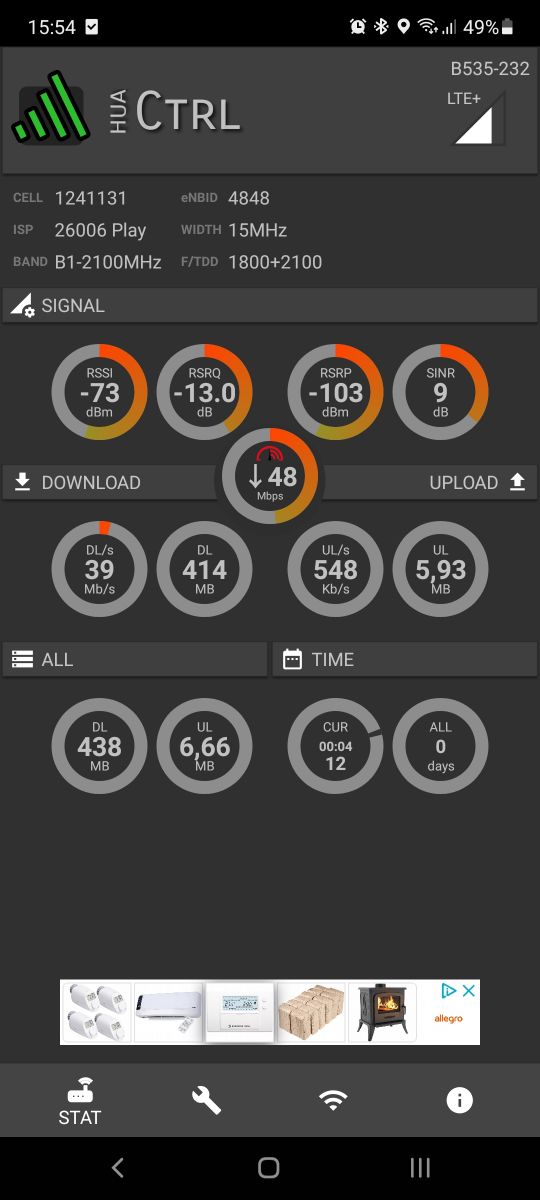

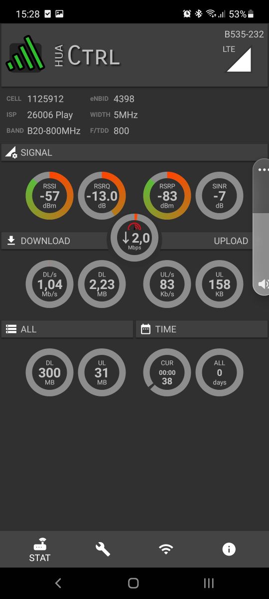

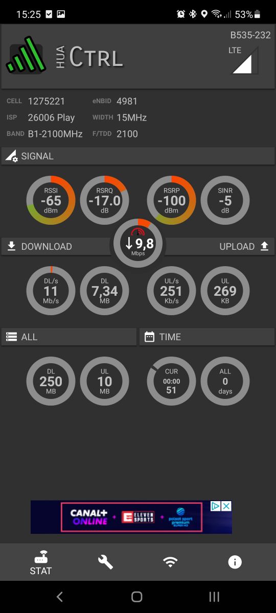

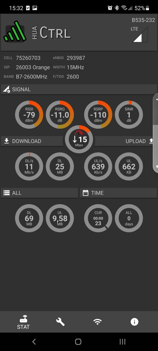

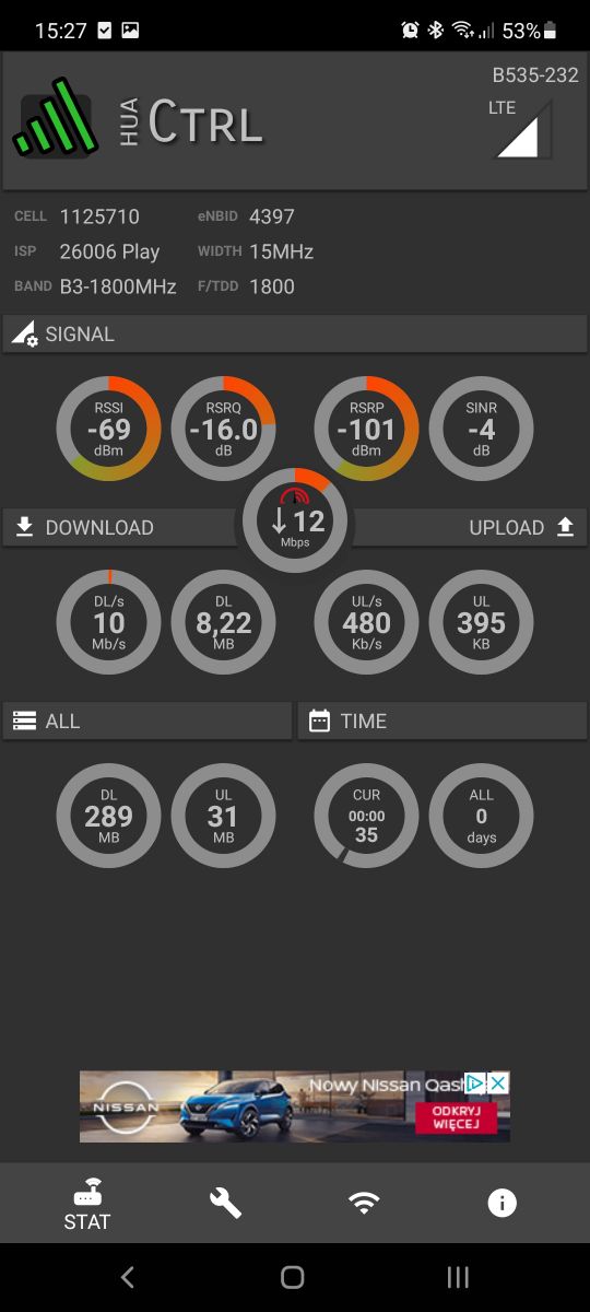

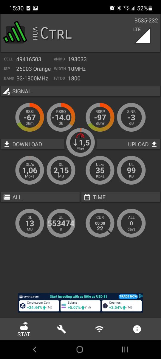

    Ok, I had some time and did a few tests without any antenna connected (what I wrote earlier that Play has no coverage at home is wrong information, I forgot to switch the antenna mode to internal).
    Orange on the opposite side to the external antenna (BTS pins):
    Choosing a 4G internet modem: TCL Linkhub HH130V1 LTE vs Huawei B535 - experiences and opinions Choosing a 4G internet modem: TCL Linkhub HH130V1 LTE vs Huawei B535 - experiences and opinions
    Play on the side opposite to the external antenna (I did not check 2600 because the transmitters on this side do not have the 2600 band):
    Choosing a 4G internet modem: TCL Linkhub HH130V1 LTE vs Huawei B535 - experiences and opinions Choosing a 4G internet modem: TCL Linkhub HH130V1 LTE vs Huawei B535 - experiences and opinions Choosing a 4G internet modem: TCL Linkhub HH130V1 LTE vs Huawei B535 - experiences and opinions
    Play from a window near an outdoor antenna:
    Choosing a 4G internet modem: TCL Linkhub HH130V1 LTE vs Huawei B535 - experiences and opinions Choosing a 4G internet modem: TCL Linkhub HH130V1 LTE vs Huawei B535 - experiences and opinions Choosing a 4G internet modem: TCL Linkhub HH130V1 LTE vs Huawei B535 - experiences and opinions Choosing a 4G internet modem: TCL Linkhub HH130V1 LTE vs Huawei B535 - experiences and opinions
    Orange from the window near the outdoor antenna:
    As it turns out, the most interesting signal is from Play, from BTS, from what I found out from Leśniewo Górny.
    What do you think?
  • Window placement outperforms fake antenna attenuator
    #14 19838352
    matek451
    Posts: 31253
    Help: 4352
    Rate: 5808
    Throw away this attenuator pretending to be an antenna to an electrical scrap yard, the parameters on the router itself from the window are 9dB better on LTE2600 and LTE2100, and I wrote, don`t buy anything from new-electric, Signaflex and their clones. And Play is not surprising because BTS Janowięta operates on LTE2100+1800+800 and in the window there is poor coverage on LTE2600 from the Hospital.
