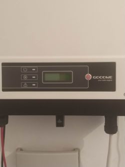

    Good day. I have such a problem, a photovoltaic installation has been set up for me. Exactly 8 panels with a power of 2.5 kW. The installers finished the assembly during the night, the day was cloudy, so they found that the inverter had not drawn power to fire and check if it works. A few days have passed, a bidirectional counter has been installed, but the inverter still does not start. The installer tells me there is a battery in there and it will take a while to recharge. My question is how long the inverter will run and is there any way to check if everything works as it should?

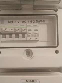

    Give photos of inverter and security boxes as you can, because maybe something needs to be turned on

    Everything is on and no reaction. PV Inverter Not Starting Up: 2.5kW Installation, 8 Panels - How Long to Charge & How to Check? PV Inverter Not Starting Up: 2.5kW Installation, 8 Panels - How Long to Charge & How to Check? PV Inverter Not Starting Up: 2.5kW Installation, 8 Panels - How Long to Charge & How to Check? PV Inverter Not Starting Up: 2.5kW Installation, 8 Panels - How Long to Charge & How to Check? PV Inverter Not Starting Up: 2.5kW Installation, 8 Panels - How Long to Charge & How to Check?
    Check roof DC voltage and GoodWe fault code
    #5 18349178
    marcinbbb
    Level 26  
    Posts: 812
    Help: 44
    Rate: 178
    I also have GoodWe, if the panels were well connected, the inverter would report "Falaut". So either the team forgot to fasten any of the panels on the roof or the inverter to be replaced. If you have a multimeter, disconnect the connection cables that come off the roof of the multimeter to check the DC voltage and check if the voltage is supplied from the roof should be around 8 * 30V = 240V and you need to set this range on the multimeter. Before unplugging the cables, switch the DC switch preventively !!!
    This way you will know what is the damaged inverter or somewhere on the panels or security.
    Regardless of the version, you call the crew and have them fix it

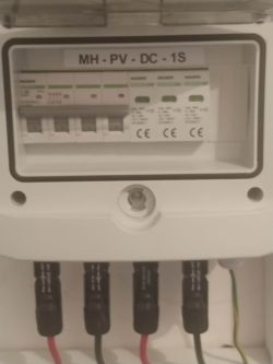

    I see 2 thongs, could there be 4 panels each?
  • #7 18353371
    Tech132
    Posts: 1088
    Help: 97
    Rate: 392
    The fitter made 2 strings and therefore the inverter does not start because it has too low voltage, take a picture of the center of this separates what enter four wires from DC panels.
  • #8 18353403
    theo33
    Posts: 849
    Help: 78
    Rate: 321
    It is rather one string, one arrester, two-pole protection and double pole break and two wires from panels and two to the inverter, the inverter also with one input
  • #9 18353539
    prose
    Level 36  
    Posts: 3037
    Help: 173
    Rate: 850
    You just have to measure the voltage.
  • #10 18381750
    bioton1987
    Posts: 29
    Rate: 19
    He writes a bit late, but the matter is already cleared. Apparently, damaged distribution boxes came out. One of them had a bad connection inside. The fitter has corrected and everything works.
