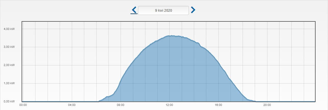

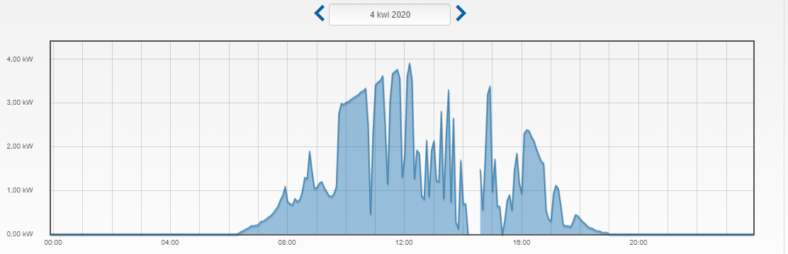

    Since the fall, I had the same problem with exceeding 253V on one of the phases, a week ago on Saturday, I had more than 10 inverter restarts during the day, it was overwhelmed by bitterness. One phone call to the PGE emergency service was enough, that the induction hob burned out and that the voltage of the network exceeds the standard 230V +/- 10%, when asked if the neighbors are also complaining, I answered yes, less than 2 hours have passed, and the gentlemen from PGE came and examined the which power station I have power, they turned off the network for half an hour, then they called that they lowered the voltage on the transformer taps by 6V and now it is from 235 to 245 max, and everything is running beautifully. I recommend such a phone, other methods will not help.
    There was clear blue sky all day, and when I saw the graph, I boiled it:
    The panel inverter shuts down especially on Sundays and public holidays
    And in the following days in the same weather:
    Greetings

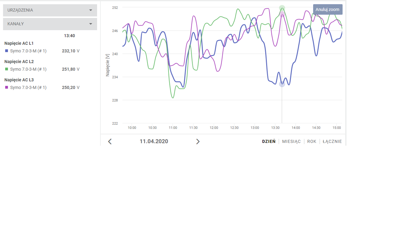

    Most inverters have Logs with parameters available, so there is no need to measure.
    Or graphs, you can see the asymmetry in the following:
