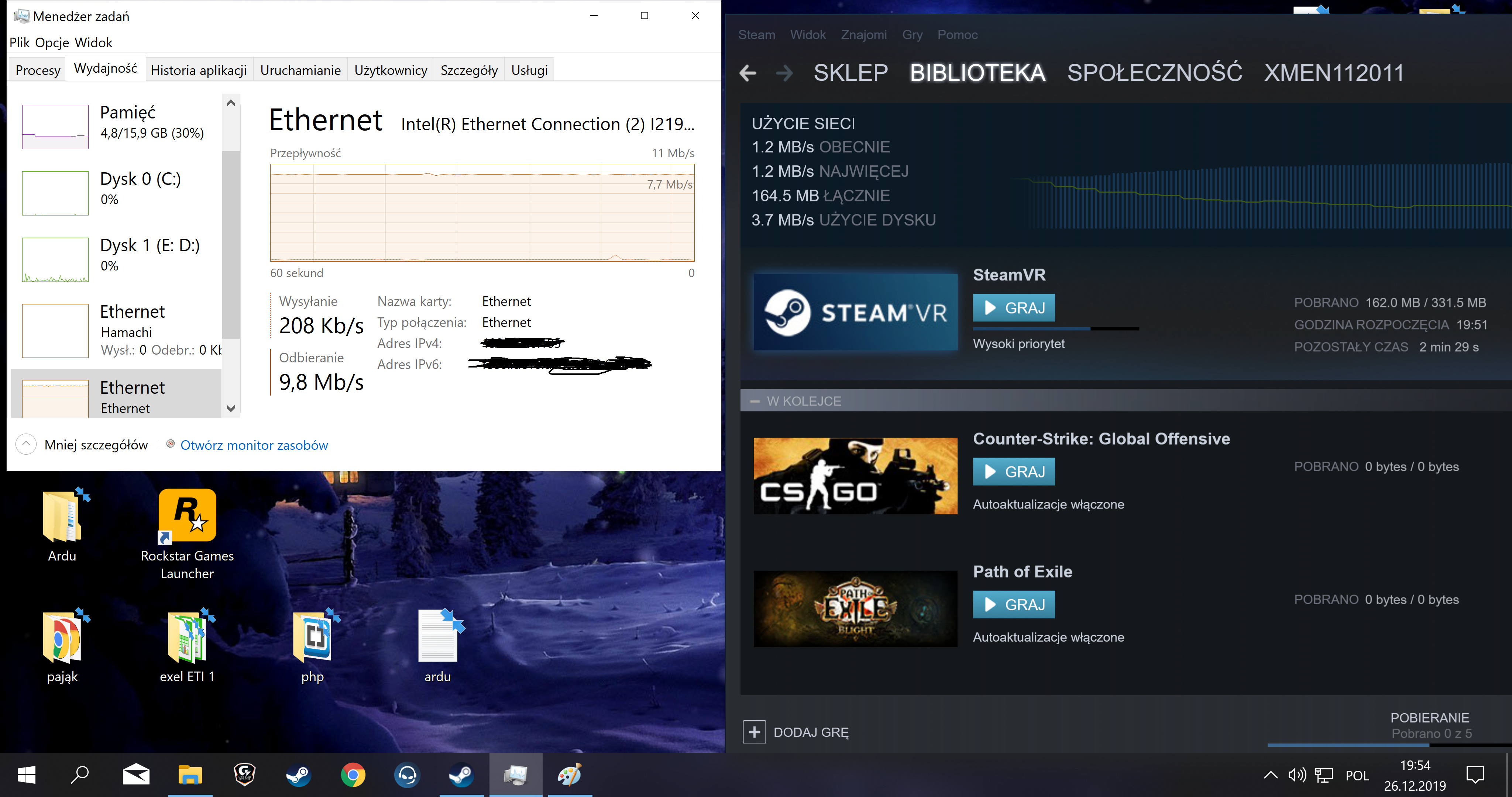

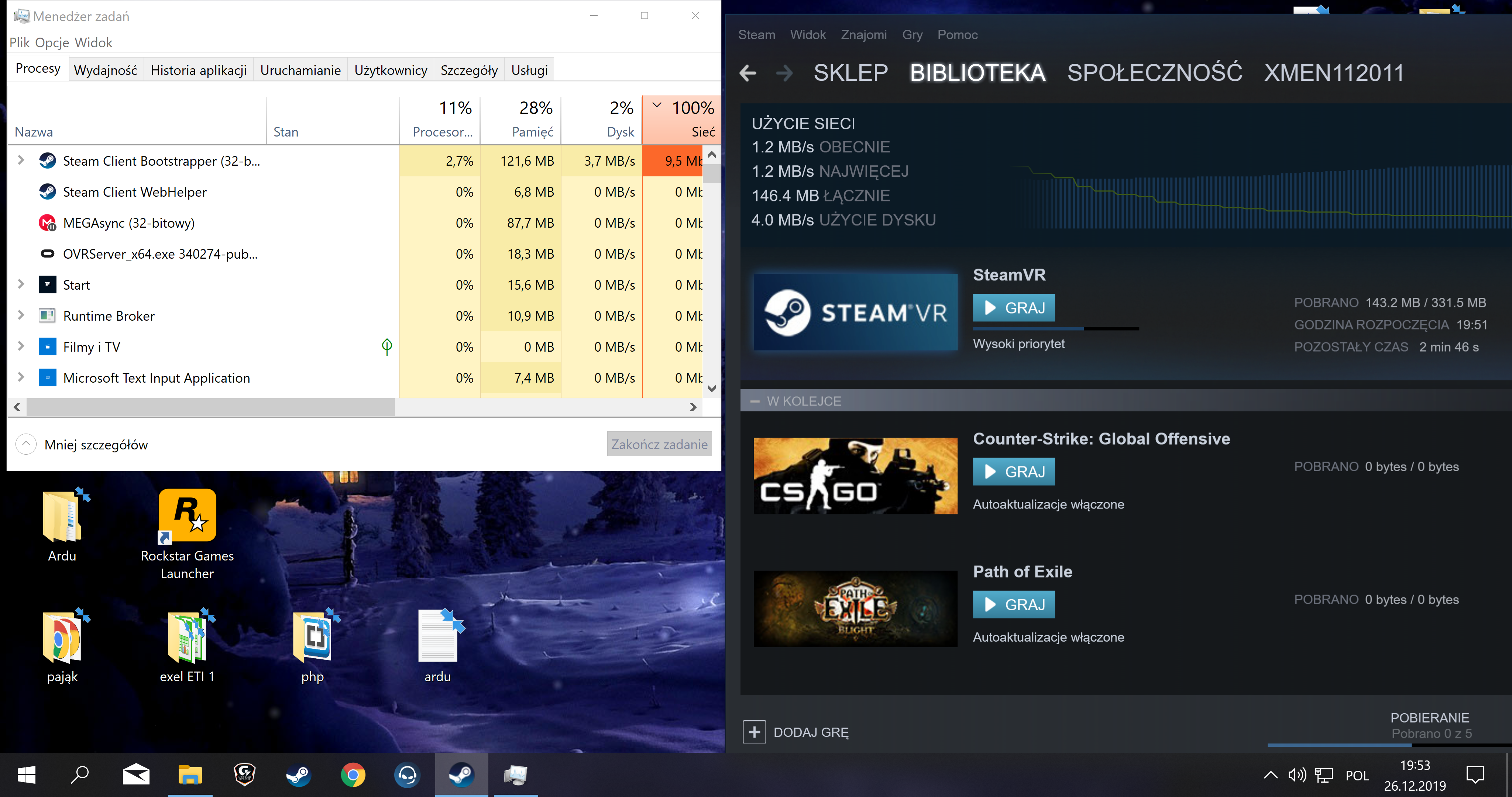

    For a week, maybe longer, I have had a troublesome problem, the reinstallation of the system is not included in the game, the correct data transfer that I have purchased is up to 12MB / s, the NIBY computer downloads me at a speed of 10Mb / s, and in fact MAX 1.5Mb / s. The fact that I will not reach the maximum speed, I can understand, but why the system shows that it uses 10Mb / s, and I download files on programs or in a browser at a speed of 1.5Mb / s. In fact, when downloading, it loads the network because pages take longer to run on other devices. The antivirus does not detect anything, adwcleaner does not detect anything either, everything is kept up-to-date. Everything works fine on other devices.
    Pł. main: Gigabyte Z370 AORUS Gaming K3
    Network card: Intel (R) Ethernet Connection I219-V
    Operating System: win 10
    Thank you in advance for your help

    You have a transfer of 12Mb / s (megabits per second). Are these other programs not reporting in MB / s (megabytes per second)? That'd be pretty much the same when you divide by 8.

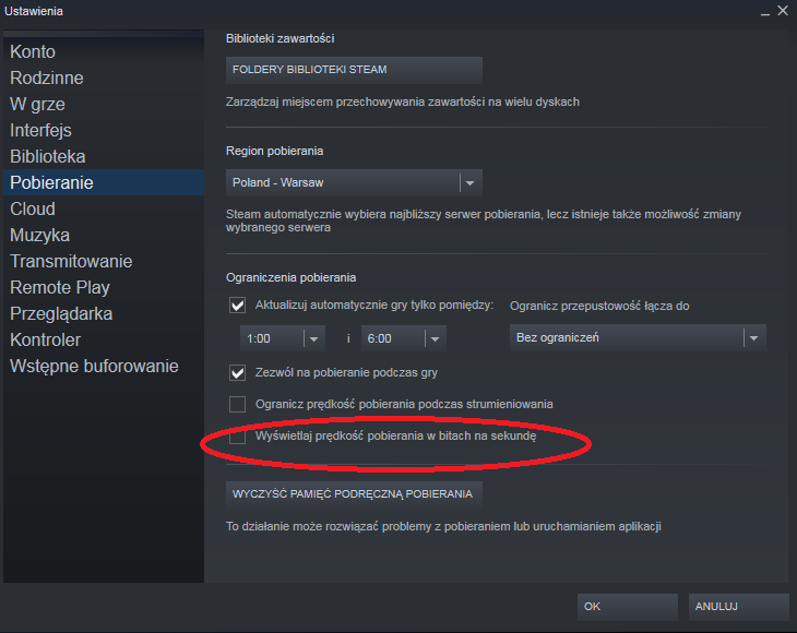

    Everything is correct, Steam says in MB / s, and Windows manager - in Mb / s.
    The ratio of MB / s to Mb / s is such that 1MB / s = 8Mb / s.
    In Steam, you can change the unit:
    Troubleshooting Slow Download Speeds: 10Mbps Display, 1.5Mbps Reality on Gigabyte Z370 AORUS K3

    Xmen112011 wrote:
    I don't know where this error is. I download the file on this computer for 10 minutes, and on a laptop on the same network in 1 minute and both task managers show the same network consumption but the info on browsers with speeds are different
    So one of the computers, simultaneously with the download, downloads a system update or a game on Steam.

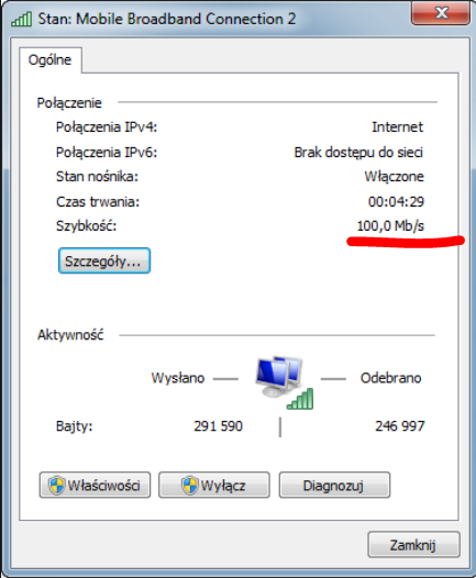

    No, it's more about how fast it is connected to the operator's device.
    Network and Sharing Center -> change adapter settings - and here you click network connection status getting something like:

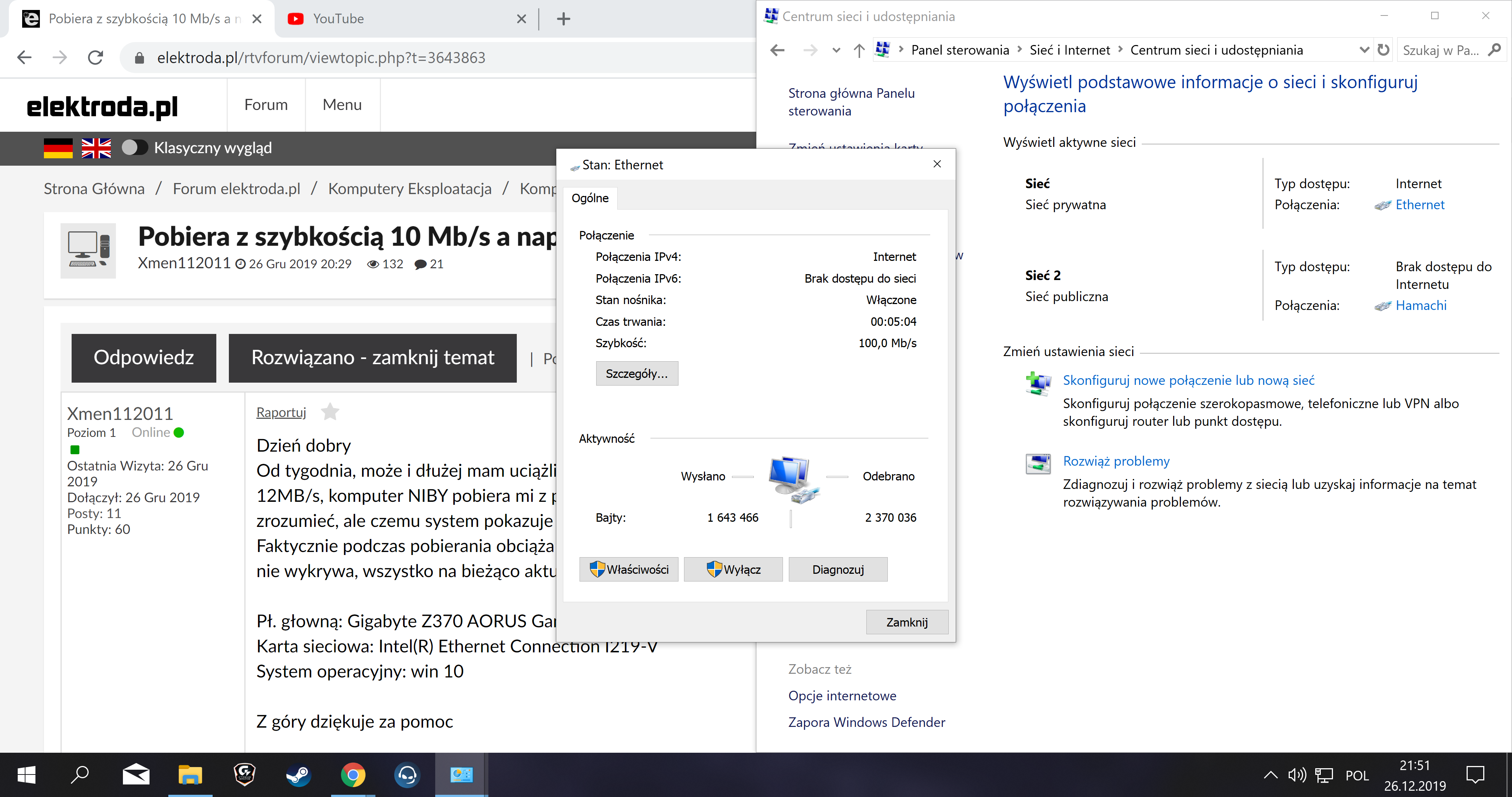

    Speed: 10.0 Mb / s

    Then start by substituting a different wire.

    Xmen112011 wrote:
    Speed: 10.0 Mb / s
    Write a little more about the connection itself.
    What device is the cable from the computer connected to (maybe some operator modem - best give its model), what cable (factory, home-made, about the length - is it a meter cable between devices standing next to each other or 20 meters through the wall to another room, or maybe a cable to the wall socket, or something else)?
    And such a trivial matter ... Have you tried to restart the operator's device (disconnect it from the power supply for a few seconds and reconnect it)?
    If you have the option to swap the cable from your computer to the access device, then do so.
    Additionally, in the network card settings it is worth checking if auto-negotiation is set, or for some reason the limit up to 10Mbps.

    Cable changed to another, speed: 10.0 Gb / s
  • #22 18361837
    dt1
    Admin of Computers group
    Posts: 47961
    Help: 7262
    Rate: 8187
    10.0Mb / s or 1.0Gb / s? :)
    Because the 10.0 Gb / s option is not possible on a 10/100/1000 network card.
    I noticed a badly made screen, sorry xP

    Now it looks OK, check the speedtest again to see if the speed has improved.
