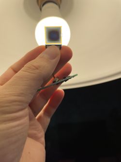

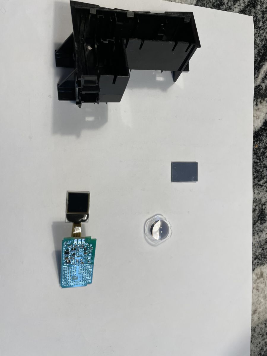

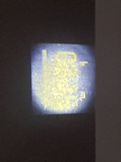

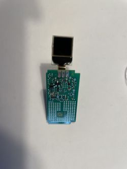

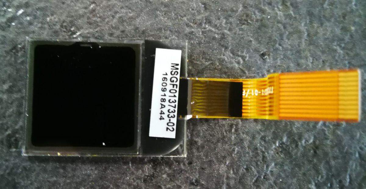

    #26 19660243
    spallony
    I had the same problem and replaced the display with a new one.
    Out of sheer post-mortem curiosity, I took the old module apart, I threw in photos, maybe they will be useful to someone.
    Unfortunately, the repair is impossible without a new liquid crystal element.
    Under the light, you can see the destruction of the liquid crystal coating:
    Bosch SMV68TX04E Dishwasher: Blurred Floor Display Issue - Possible Solutions & Alternatives Bosch SMV68TX04E Dishwasher: Blurred Floor Display Issue - Possible Solutions & Alternatives Bosch SMV68TX04E Dishwasher: Blurred Floor Display Issue - Possible Solutions & Alternatives
    The display itself is even sensibly connected to the board -> with a latch tape, but I couldn't find the display itself anywhere. It probably costs $ 2, and so almost PLN 350 went for a new module with replacement.
    Better photos are on the Dutch forum - I will not post the link because I'm too fresh on the forum. :(
