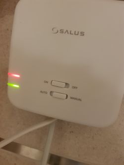

    I have it set like this
    How to set the Salus receiver to work with the regulator - auto or manual?
    When switching to auto mode, the boiler runs without a pump, so it doesn`t work as it should? I wonder if I have something wrong because the temperature shown on the controller screen does not match the one I set the controller to. Cool radiators, not cold, still don`t go down to 21C, and I have the economy one at 7pm.
    that is, bad.
    The MANUAL setting means that the circuit is permanently closed, just like if you had a permanently closed jumper on the boiler and the receiver does not respond to signals from the room regulator (transmitter).
    Only the AUTO setting causes the receiver to respond to signals from the transmitter.
    If you prefer MANUAL mode, why did you buy the controller? What you have set up makes no sense.
    In AUTO mode, if the transmitter, i.e. the room regulator, gives a heating signal, the green diode on the receiver will light up, the circuit will be closed and the boiler will turn on the heating.
    If the transmitter gives the HEATING STOP signal, the green diode on the receiver will turn off, the circuit will be opened and the boiler will turn off the heating.
    The operation of the pump after the burner is turned off depends on the so-called settings. pump overrun in the boiler settings.
    When a specialist connected this Salus to you, the specialist should have set it up on the boiler or told you what to set it up and how, and if you did it yourself, now you have to set everything up yourself.

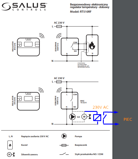

    How to set the Salus receiver to work with the regulator - auto or manual? Well, it`s as simple as pie, but if you want to have a pump and a solo boiler, you need to connect a relay and a coil for 230 V/AC.
  • #11 18441955

    ROWE wrote:
    If there is to be a pump and a boiler, a relay must be connected.
    If you have a gas boiler, the pump is built into the boiler, so the regulator turns on the boiler and the built-in pump automatically, so an additional relay is unnecessary and I installed this variant.
    The question was how the receiver should be set to AUTO or MANUAL, the answer is AUTO.
    For people who know the basics of the subject, this connection is simple, and if someone has no idea about it, they should not attempt it at all.

    The author has drawn it in two versions so as not to split it up, also for other interested parties.
    The answer is always auto (OFF/ON with the Salus regulator), the control applies to the upper diagram (to be precise).
    This is the position of the receiver switches:
    1. HE
    2. AUTO
