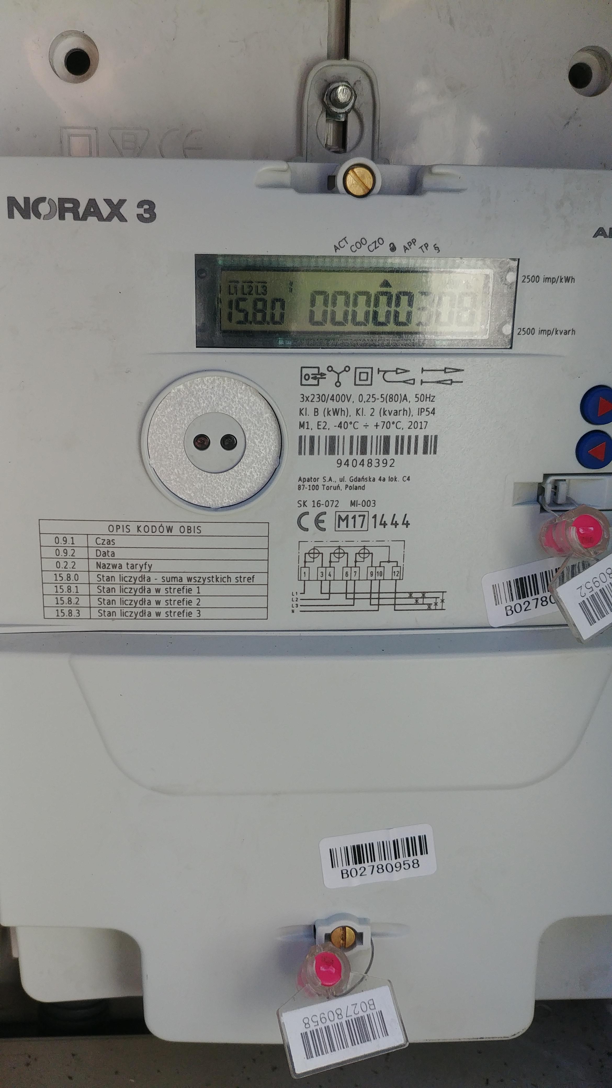

    I started the PV installation and PGE replaced the meter with a bi-directional NORAX 3. I have a G11 tariff.
    I have a question, I checked the OBIS codes programmed on the meter installed at my place.
    For example, I have 5.8.0, 6.8.0, 7.8.0, 9.8.0, 1.6.0, 1.8.1 and 2.6.0 (I do not include these for dates etc.). I was surprised that I do not have the code 1.8.0 or any in the range 2.8.0 - 2.8.3.
    In this case, how can I check how much I have used and how much have I returned EE?
    I will add that I have a Solax x3-4.0-t Inverter but it shows the EE produced and sent to the network, unfortunately I do not have information about the energy consumed.
    Is this installation OK?

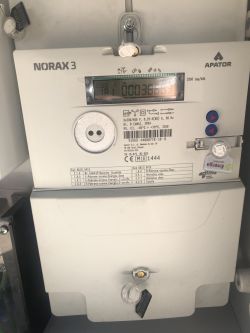

    Hello. I have an exclamation mark in a triangle, in the Norax 3 bidirectional counter, which? He marks. Nowhere to find this marking, what kind of error it is.

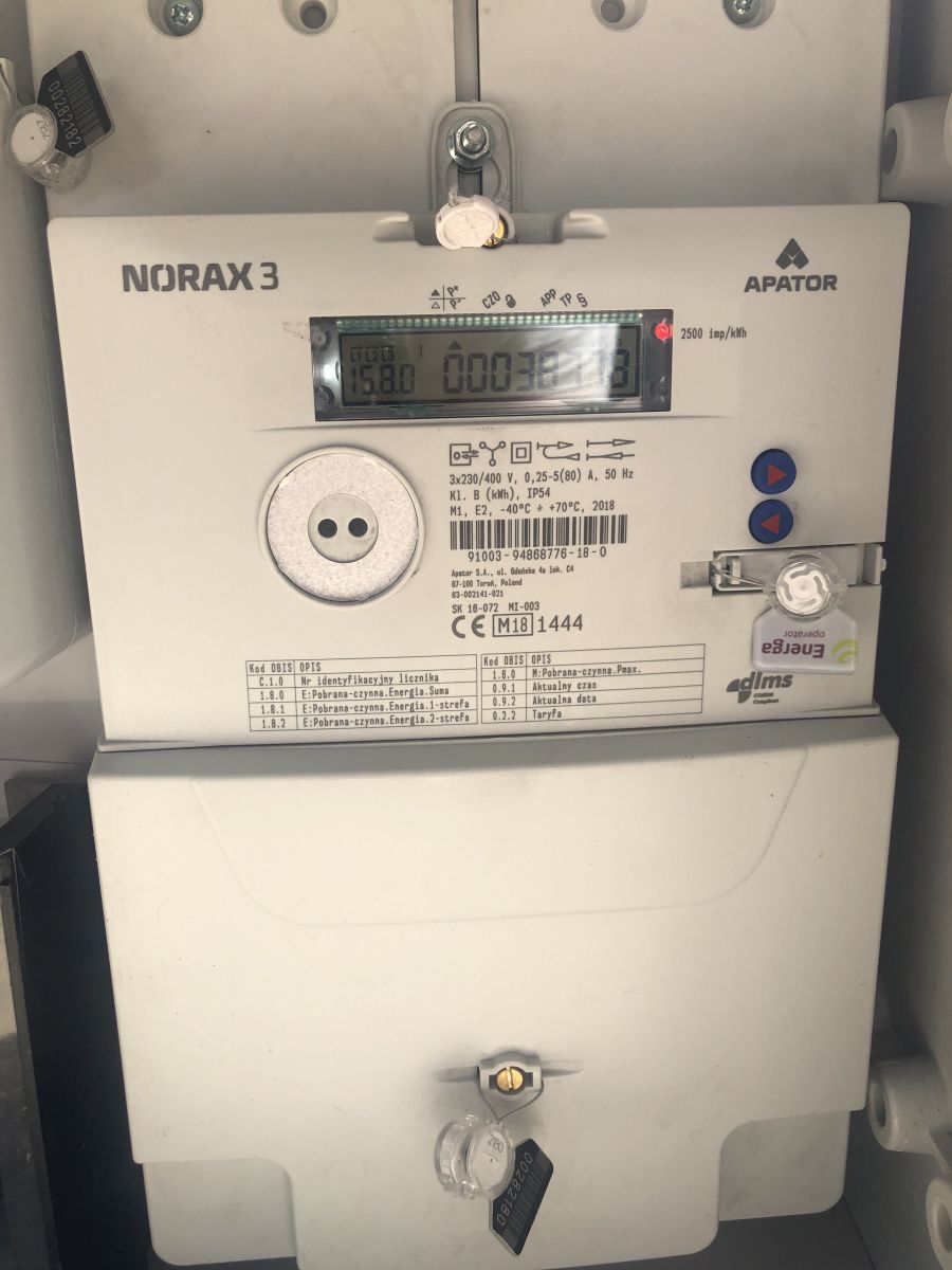

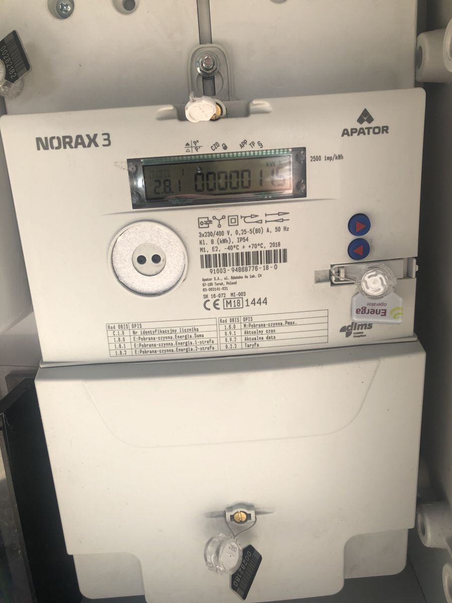

    When starting the installation, the counter at position 1.8.0. if 1.8.1 (3866.3) stops punching despite running washing machine, heat pump and dishwasher.
    At position 2.8.0 or 2.8.1, he starts punching the kilowatts supplied to the net (11.5).
    And in item 1.5.8.0 it sums up the energy taken from the grid plus the energy given to the grid (3,877.8).
    With Energi there is still no message that the received instance, although everything works as if the meter was already reprogrammed to receive energy. I'm in despair too, and I don't know whether to run or not .......
    I have real settlements turned on and I always enter the status on the page from 1.8.0, which means that it would not reach this status ...
    below photos

    So if I do not have a contract, I can use the FV and what I give to the network will be lost at most, but I will be a plus from what I will produce and use during the day for my own use until I sign the contract?
The discussion revolves around the suitability of the Norax 3 energy meter for measuring energy produced by a 3kW photovoltaic installation, particularly in the context of energy donation to the grid. Users confirm that the Norax 3 is a bidirectional meter capable of measuring both energy consumption and energy exported to the grid. However, concerns are raised regarding its programming, as some users report that the meter may not accurately reflect energy exported if not properly configured. The importance of notifying the grid operator about the photovoltaic installation is emphasized, as it may affect the meter's functionality and the user's ability to benefit from net metering. Additionally, users share experiences with different energy companies and the challenges of accessing remote readings and data from the meter.
TL;DR: A correctly-programmed Norax 3 shows export on register 2.8.0; values above 0.5 kWh h⁻¹ confirm bidirectionality. “If you don’t see 2.8.x, the meter adds export to import” [Elektroda, michalPV, post #21043653] Why it matters: mis-programming can inflate your bill by up to 20 % every billing cycle.
• Accuracy class: 1 % (active energy) [Apator Norax 3 Datasheet]. • Max current: 5–100 A, 3-phase, 4-wire [Apator Norax 3 Datasheet]. • Key registers: 1.8.x import, 2.8.x export, 15.8.0 absolute sum [Elektroda, 3301, post #17916012] • Typical prosumer write-off: 20 % of exported kWh in net-metering ≤10 kW [Energy Act, Art.4g]. • Remote reading only in GSM/GPRS variant OTUS 3; base Norax 3 lacks this module [Elektroda, michalPV, post #21043653]
How do I confirm my Norax 3 is counting export separately?
Compare 1.8.0 and 2.8.0 over one sunny hour. A rise only in 2.8.0 means proper bidirectionality; a rise in 1.8.0 means mis-programming [Elektroda, bakupl, post #21046022]
Which OBIS codes matter for a G11/G12 prosumer?
1.8.0 (total import), 1.8.1/1.8.2 (WT/NT import), 2.8.0 (total export), 2.8.1/2.8.2 (WT/NT export), and 15.8.0 (absolute energy) [Elektroda, Viszna, post #18457049]
What if only 1.8.x is visible and 2.8.x is missing?
Exported energy will add to 1.8.0, inflating consumption. Request re-programming or meter swap; one user saw this on an un-reprogrammed unit [Elektroda, janekk77, post #18635141]

What is 15.8.0 and why is it higher than 1.8.0?
15.8.0 records absolute energy flow (|import|+|export|). It will always exceed or equal 1.8.0 because it adds both directions [Elektroda, piwalek77, post #18584945]
Edge case: Can the meter count PV generation as consumption even with 2.8.0 present?
If programmed for “absolute” billing, the DSO may read 15.8.0 instead of 1.8.0, charging you for both flows; one user reported this mis-billing risk [Elektroda, theo33, post #18634346]
