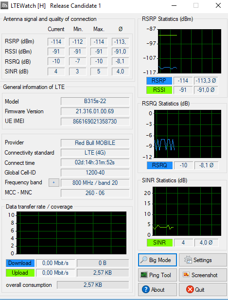

  • #11 16563504
    reponiczyk
    Posts: 11
    Choosing the Right LTE Antenna and Modem for Rural Areas in Play Network within PLN 400 Choosing the Right LTE Antenna and Modem for Rural Areas in Play Network within PLN 400 Choosing the Right LTE Antenna and Modem for Rural Areas in Play Network within PLN 400 Choosing the Right LTE Antenna and Modem for Rural Areas in Play Network within PLN 400
    LTE 2100 can't connect at all.
    LTE 1800 connects but the internet does not work.
    LTE 800 works.
    I put speedtest with LTE 800 and ping from the program, I will add that it connects to the modem via wifi.

  • LTE 1800 signal is too weak for usable data
    #15 16564518
    reponiczyk
    Posts: 11
    After displaying outside the window:
    LTE 1800 detects a signal, but it takes over 2 minutes to load a page with a speed test.
    LTE 800 still works as it should.
    After choosing LTE-Advanced in the program the internet does not work at all (I do not know if it matters)
    I put pictures from the program and speedtest:
  • LTE800 antenna recommended for stable Play coverage
    #16 16564647
    matek451
    Posts: 31251
    Help: 4352
    Rate: 5808
    Signal parameters outside on LTE1800 properly exclude proper operation. Dual LTE 1800 MHz antenna will improve it by about 10-12dB but the obtained parameters (RSRP about -110dBm) do not guarantee stability. As for the LTE800, with a 800MHz antenna you will get RSRP around -100dBm, i.e. sufficient parameters and it should be stable and the speeds should increase. The decision as to which LTe band to play on Play is up to you, which is your choice of antenna.
  • #17 16564983
    reponiczyk
    Posts: 11
    He decides on stability or LTE 800, what exactly antenna do you recommend? The price does not play a major role, it is important that FV is available and the price goes with performance. I will add that during the last 48h on LTE 800 I have never lost my connection, so it should be the same with real antennas.
  • ATK-10 LTE800 MIMO antenna recommendation
    #18 16565261
    matek451
    Posts: 31251
    Help: 4352
    Rate: 5808
    The recommended antenna for LTE800 is ATK-10 / 800-980 http://www.dipol.com.pl/antena_gsm_10-element..._800-980_mhz_10_m_przewodu_wtyk_sma_A7017.htm Because Play uses MIMO, two pieces are necessary, one in vertical polarization (vertical elements) , the other in horizontal. It has SMA connectors to B315 immediately. The cable can be shorter to reduce losses on it. Possibly stronger http://www.dipol.com.pl/antena_gsm_20-element...-850-960_mhz_10_m_przewodu_wtyk_sma_A7027.htm but this is a piece of antenna 10m long and requires a solid attachment, the more so also 2 pieces. You can also use these antennas for LTE800 in Orange or T-Mobile.
