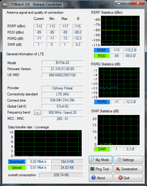

    And how do I know with which BTS you are connected now and on what LTE band? Download http://www.lte-anbieter.info/ltewatch/count_huawei.php?Datei=ltewatch_h, log in to this program on B315s-22 and show screenshots. The program shows signal parameters and BTS data. Select LTE800 in turn, then LTE1800, show screenshots from LTEWatchH and speed test. Perform on the B315 on the outside and with this Akc2uni.

    When starting, something like this appears ??
    Improving LTE Coverage: B315s-22 Router and New Antenna Considerations in Rural Areas
    what should I set up in this?

    Tragically weak signal parameters on LTE800Sferia from BTS-Ciężkowice, which is measured with antenna and which without with B315 out? About 5 km to the BTS. Link to speedtest does not show speed but it's probably bad. It is not known whether the improvement of signal parameters will affect speed. I understand that you do not connect to LTE1800? BTS-Y LTE1800Aero2 far away. Choosing an operator is a massacre mistake, when to subscribe? It's time to change the operator, the others have LTE coverage and even LTE-A.

    Both results from Akc2uni, the subscription for the year is over, now for a week even more slowed down I have no idea why. So on the LTE1800 does not connect. Other operators Play / Orange / TM have a better range than plus ????

    I mean what Neostrada offers and what are they realistic to obtain? What are they now in CP from the LTE800Sferia BTS in Ciężkowice? With the Grinder T-Mobile and probably Orange have LTE-A or aggregation of the LTE1800 + LTE800 bands, from Ciężkowice they have LTE800. Play has LTE1800 + LTE800 from Gromnik. Of course, in any case, you need an antenna for the selected band. The same for CP on LTE800Sferii where the antenna needs 800MHz.
