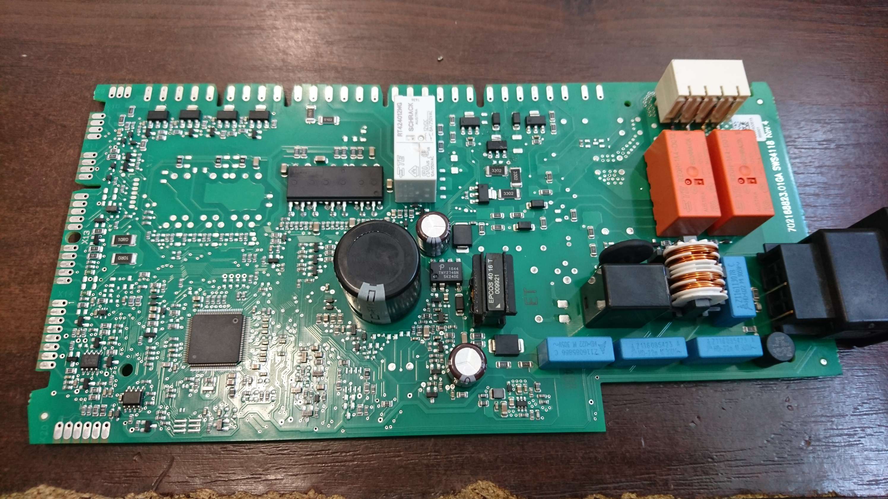

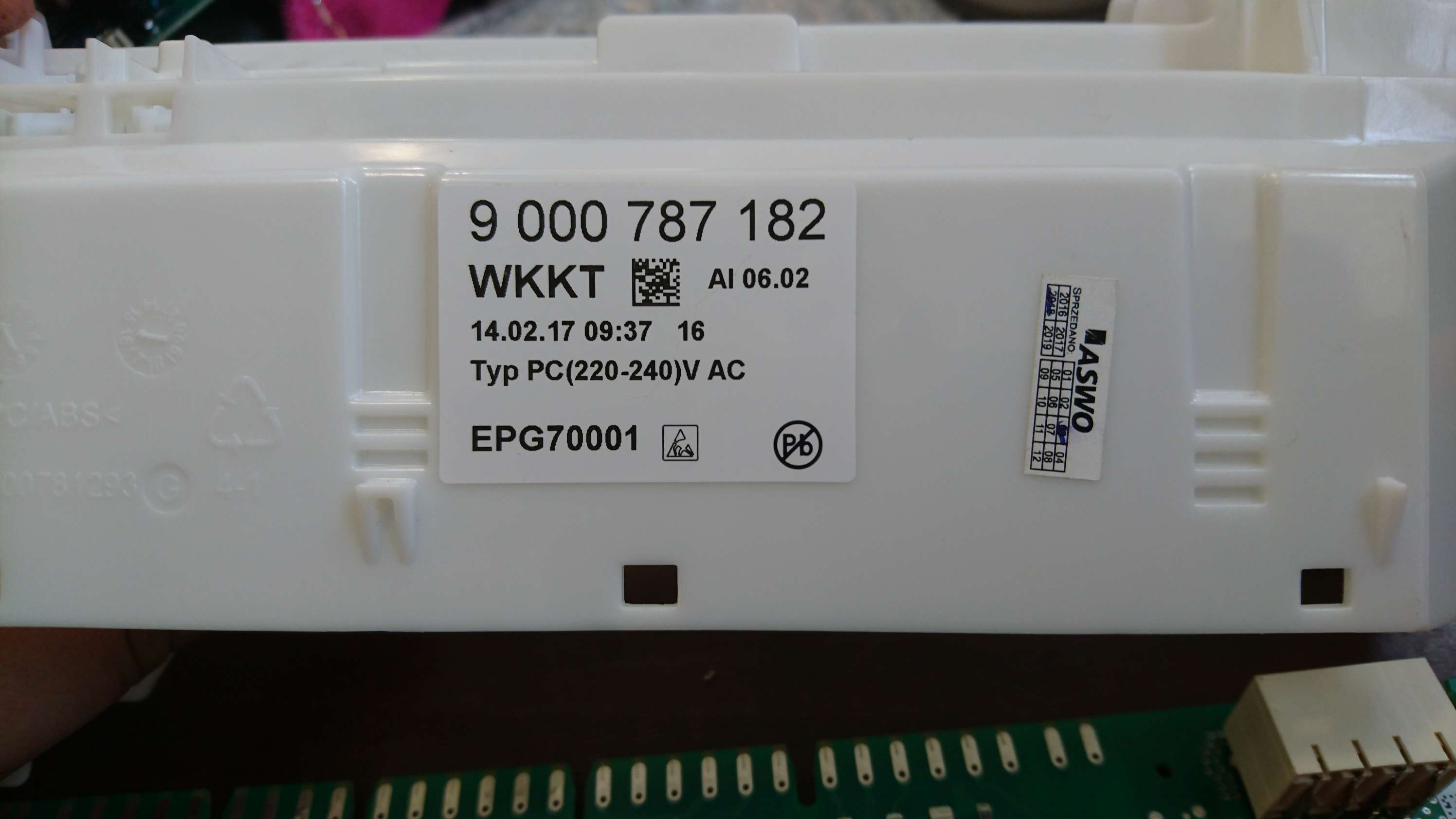

    Hello, I am looking for information about the value of the triac SMD resistor. Siemens SPS53E08EU / 30 error E19 N9260 or STN9260 mounted between the base and the emitter. The module was damaged after shorting the coil of the water jacket solenoid valve, thank you in advance for your help

    looking for information about the value of the triac control SMD resistor

    Replacing the SMD 473 and N9620 resistor improved the equipment thank you for your help.
