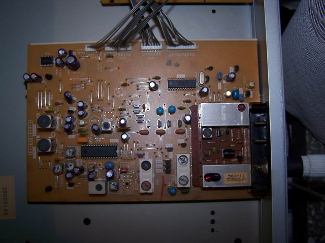

  • #7 1862271
    jarosz123
    Posts: 11
    I attach a photo. I would ask for tuning tips, because I have never done this before ...

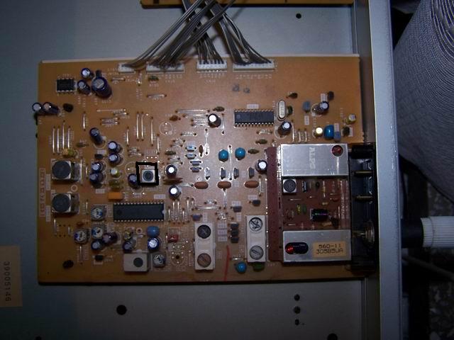

  • #8 1869111
    h jaworski
    Home appliances specialist
    Posts: 4786
    Help: 466
    Rate: 717
    so it seems to me that the filter of the discriminator is tan marked in black in the picture you need to choose a good screwdriver to connect the tuner to set the frequency of the known station and gently screw in the core sometimes need 1/4 turn but sometimes you need to screw in more it screwed up so that it's stereo but you have to be very careful because as the core will break the beret with the antenna but sometimes the capacitor in the filter has lost the value so much that it does not help tuning you need to replace the capacitor (but it's hard to say what is the value or replace the whole filter

  • #12 2168582
    esesz83
    Level 19  
    Posts: 446
    Help: 22
    Rate: 19
    Well, I was able to do stereo in this tuner. And the matter turned out to be very simple. There is a connector on the spit (at least in my picture I marked it with a pink frame) and you should set the discriminator equally 0V on this connector and everything returns to normal.

  • #14 6264474
    KABE
    Posts: 78
    Rate: 8
    I dig up the topic, because this tuner just today fell into my paws with a problem in the thread.
    This "field intensity" overload is a problem.
    We set the band manually on which there is definitely a stereo signal.
    -trymerek marked as "FN TUNE" we turn to the left resistance / that the signal strength bars go down, not important /
    - turn the filter "black" (marked on the photo above) left-right until the desired stereo signal appears
    - go back to the trimmer, turn right to the limit of breaking the stereo signal / the bar rises /, gently (!) when it breaks micromically back to the left until the stereo flashs again
    - if we know that the broadcast signal of the station in a given area is strong and we think that the signal bar should be at the max, then we are looking for the trimmer at which stands "signal" and ..... we :) .
    I know that with the cable I have a max signal, but I have set it so that the highest post slightly appears and disappears, twitching. Stereo game.
    And on this "pink" proceeding according to the above regulations, by turning the filter I could not get 0V, after a few moments and any tensions appear there.
    PS Obvious to filming, we do not use metal tips.
    I tore a screwdriver from a lollipop stick.
    Best regards and nice reception.
