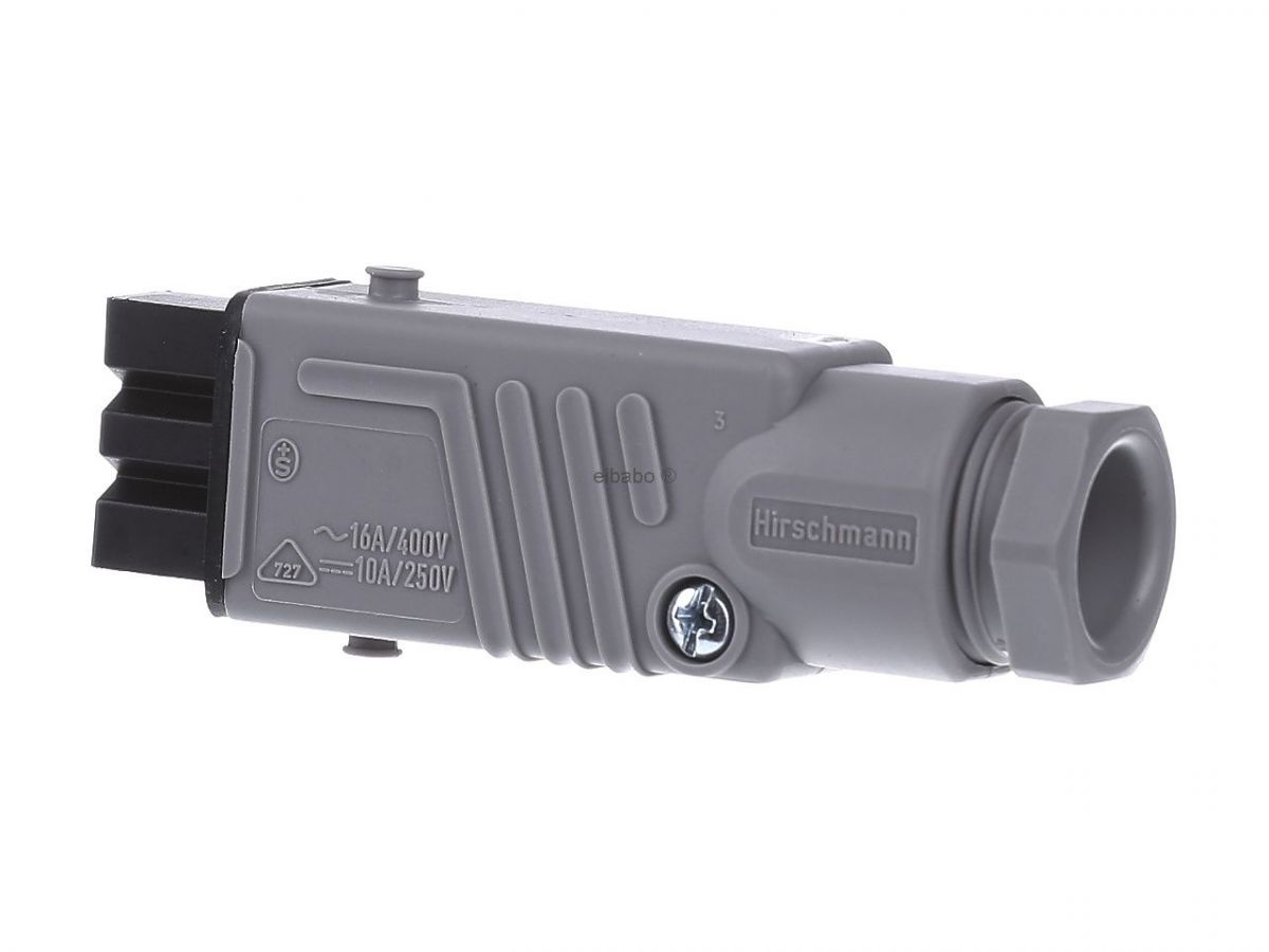

    NO. The point is that the Hirschmann connector has chokes to prevent moisture from getting inside, and it's hard to do it on a flat cable. In addition, the facade blinds have specially designed holders for laying/suspending the cable in the housings and these are adapted to the cable in round insulation...

    As a rule, shutter drives have a piece of cable with a Hirschmann connector. The plug has a gland for a round cable.

Why use round cable at the headbox instead of flat cable?
Blind motors often include a Hirschmann plug with a gland designed for round cable. Flat cable is hard to seal and can admit moisture. Housings also have clips sized for round insulation, improving strain relief and reliability. [Elektroda, Marek J., post #18567791]
