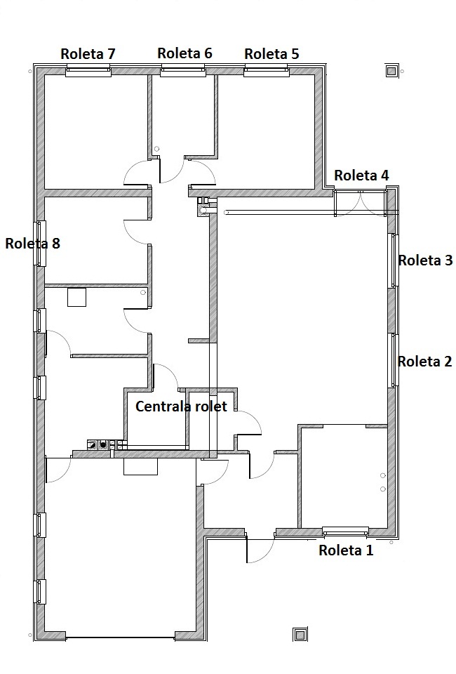

    I have a request for experts and connoisseurs of the subject.
    I want to install power + control for electric shutters in the house. Each roller shutter is opened and closed individually at the window, a switch and all roller shutters from the whole house controlled centrally from the control unit. The layout of rooms and shutters is attached. Questions to the experts:
    - What cables should I lay and how many?
    - I do not know what blinds will be installed.
    - I would like to prepare the wiring in front of plasters and at the beginning to control the roller shutters with switches near the windows, and once centrally and with various options from the control panel.
    - Request for a detailed description and how to draw the wiring in the drawing. Electric Roller Shutters: Guidance on Installation, Wiring, and Control Systems
    I am asking for a hint of people who have already performed such installations.

    I would like to prepare only the cabling and someday, if I am financially possible, I will expand the control. To begin with, the switch next to the window + wiring to the control panel, but what and how? I ask experts for a step-by-step explanation where what cables should I lead?
    Added after 9 [minutes]:
    Will something like this be the correct solution:
    - 4-wire cable from the shutter to the box and a switch here
    - 5-wire cable from the box to the control panel
    - 3-wire cable to the control panel
    and now in the control panel I connect the power supply (phase, N and PE) to all 5-wire cables from the roller blinds and this way I have control of the key of each roller blind - there are 9 of them.
    - from each 5-core cable from the box, 2 free wires are left in the control panel - once to be used for goodies.

    I will do such wiring:
    From the control panel to each box with a button by the window, a 5x1.5 mm2 cable, and from each box to the roller shutter motor 4x1.5 mm2.
    It should be enough and give the possibility of extending the control.

    Cymiasty wrote:
    Cable 5x1.5mm2 from the control panel to each box with a button by the window
    Not.
    From the 5x1.5 mm2 control panel to the first box next to the window and from this box to the next also 5x1.5 mm2 cable, etc., etc., up to the last shutter box.
    You do not need to run a separate line for each roller shutter from the control panel. With such wiring, you can insert buttons for central control anywhere.
    You have to use extra deep cans so that there is no problem with the installation of accessories.

    And why is 3x1.5 not enough from the 5x1.5 control panel to the first box and then between the 5x1.5 cans?
  • #10 15513710
    jann111
    Posts: 2058
    Help: 180
    Rate: 507
    To be able to control all roller shutters centrally.
    3 wires are only power supply, the other two open / close all roller shutters.
    Your drawing is correct.

    Feeling good - thank you worse with the wallet and I will probably use 5 wires from can to can. Several sockets on one circuit - and I will do the same with roller shutters. First, the switches themselves, and then we'll see. Thanks.
    Added after 12 [minutes]:
    Just to be sure:
    From the switchgear, a separate wire on a separate circuit of 5 * 1.5mm to the first box with a switch.
    Connection in the first box with the shutter switch:
    1 wire N separated with a cube for a switch and another box
    2 PE wire separated with a cube on the PE roller shutter and to the next box
    3 phase wire, separated by a cube into a switch and to the next box
    4 cable free through to the next box
    5 free wire as above
    and the same in subsequent cans. This connection will allow me to control each roller shutter separately with a switch, and after adding drivers to the boxes - additional goodies?

    From 5x1.5mm2 switchgear to a box with a central button. From the central button, two circuits of 5x1.5mm (ground floor, floor) from can to can. Install the boxes deep 70mm plus an additional 20mm distance. You can easily install drivers like Zamela, f & f.

    I did this:
    From 5x1.5mm2 electrical switchboard to a box with a central button. From the central 5x1.5mm button to the first box with the roller shutter switch up and down (sometime when the cash register is free, some drivers in cans) and so I connected all the cans among themselves. Then from each box a 4x1.5 mm cable to the shutter.
