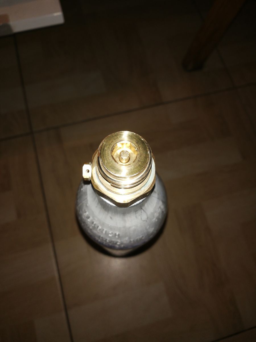

    Good morning,
    I bought a set for filling the cartridge for a soda stream carbonator, I have a mother bottle and a transfer valve. The problem is that only about 40 grams of co2 is injected into the cylinder each time, and then very slowly it goes down to 2 or 3 grams at a time, so I disconnect the system. What could be the reason why a small bottle won`t fill? It works without any problems on YouTube videos. I will add that the small bottle does not want to frost up, and it should probably be cold.

    If the valve in the cartridge is one-way, it often fills slowly. What`s more, if you want to do it too quickly, it may get completely blocked.

    The valve in the small cylinder is bidirectional
  • #4 18634325
    vieleicht
    Level 37  
    Posts: 2163
    Help: 463
    Rate: 460
    With pin or flat?
  • #5 18634785
    Labatek
    Posts: 10
    Rate: 8
    Such :) How to fill the CO2 cylinder for the Aquadream carbonator? Small amounts of gas.
