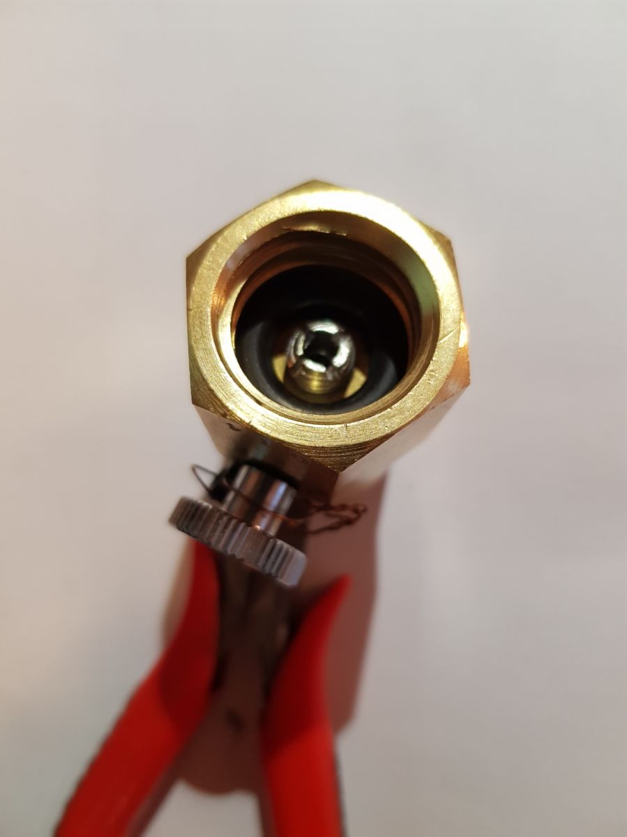

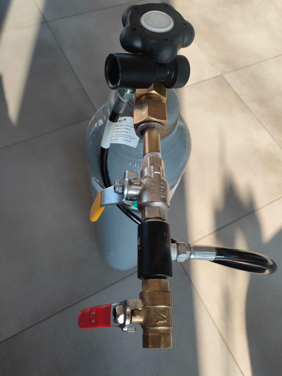

    I have a problem, I bought a shunt for filling the sodastream cylinder with a 6 kg mother cylinder
    I`m doing something wrong, I only get about 150g-200g, I`ve already read various posts on this subject, but nowhere
    specific answer
    I have it
    6kg co2 cylinder with siphon
    sodastream cartridge with two-way valve
    copper pipe without hose
    I freeze the cartridge for about 8 hours before loading it
    I unscrew the cylinders very slowly during landing
    anyway, maybe someone will be able to help me
    the photos show the cartridge and the plunger

    What kind of valves do you have in your cylinders? Does the 6kg cylinder have a siphon tube or not?
  • #3 19425893
    pirek85
    Posts: 15
    Rate: 40
    yes, the cylinder definitely has a siphon tube
    and the sodastream cartridges are supposedly double-directional, you have a photo above
  • #4 19425972
    jdubowski
    Tube devices specialist
    Posts: 21595
    Help: 2511
    Rate: 2795
    And do you set it with the valve up?

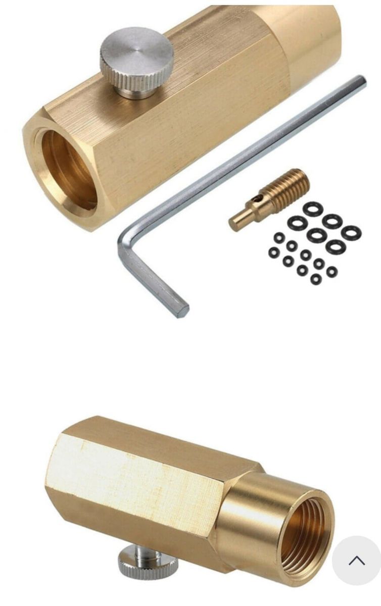

  • #6 19429165
    gelob
    Posts: 25
    Rate: 81
    check the plunger pin that should open the valve in the cylinder being filled - maybe it is incorrectly adjusted and it does not open it and only partially fills because the pressure from the large cylinder is not able to open the valve any further.
  • #7 19429176
    pirek85
    Posts: 15
    Rate: 40
    Can you be a little clearer, because I don't really understand what kind of pin, or do you mean the movable part in the coil that is screwed in with an Allen key? If so, how to adjust it???
  • #8 19429228
    gelob
    Posts: 25
    Rate: 81

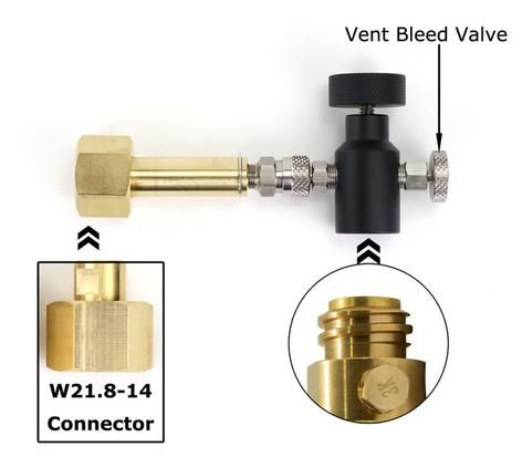

    yes, it's about this pin, I'm planning to buy a set of a cylinder and a similar shunt. According to my opinion, after screwing in the cylinder, this pin should open the filling valve in the small cylinder. The bottle should be completely empty before filling. This pin, screwed in with an Allen key, can be used to adjust the pin protrusion. Is the knob at the top of the shunt used to bleed the system or to move the pin?
  • #9 19429282
    pirek85
    Posts: 15
    Rate: 40
    gelob wrote:
    yes, it`s about this pin, I`m planning to buy a set of a cylinder and a similar shunt. According to in my opinion, after screwing in the cylinder, this pin should open the filling valve in the small cylinder. The bottle should be completely empty before filling. This pin, screwed in with an Allen key, can be used to adjust the pin protrusion. Is the knob at the top of the shunt used to bleed the system or to move the pin?
    only to bleed air after filling a small bottle, it follows that it is best to screw in the pipe with an ampel and unscrew the pin so that it goes more into the mother bottle and maybe then it will be ok, I have already checked it in various ways, I have tried it, but I won`t check it yet
    p.s. I regret that I didn`t immediately buy a shunt with a hose directly from a large bottle to the sodastream distributor, bypassing the cartridge, I saw such a miracle on Alli for PLN 100 and charging it from my head

  • #14 19433115
    gelob
    Posts: 25
    Rate: 81
    and you see, your shunt has a pin to open the valve in the mother cylinder (apparently there are cylinders that have an additional valve that needs to be opened with such a pin) and not to open the valve of the sodastream cylinder. From what I see, most other shunts have a pin on the side of the cylinder filled with 425g of CO2, which opens the cylinder valve for filling. There is a spring in the valve that closes the valve. I suspect that when filling the cylinder, the pressure from the mother cylinder is able to open the valve automatically to the 200g of CO2, and then probably due to the spring of the filled cylinder and the accumulated pressure, it is not able to reach the 200g (open the cylinder valve only with CO2). It would be good if someone who has done cylinder filling confirmed or denied my theory.
  • #15 19433198
    pirek85
    Posts: 15
    Rate: 40
    you’re probably right, my shunt doesn’t have a pin on the sodastream cylinder side and that’s why it doesn’t go in anymore

    Without supporting the valve in the small cylinder, none of this will happen. I had to add such a pin in my shunt.
  • #17 19437704
    pirek85
    Posts: 15
    Rate: 40
    Zbychul wrote:
    @gelob - exactly.
    It's hard to get a pin like that, could you send me a photo?

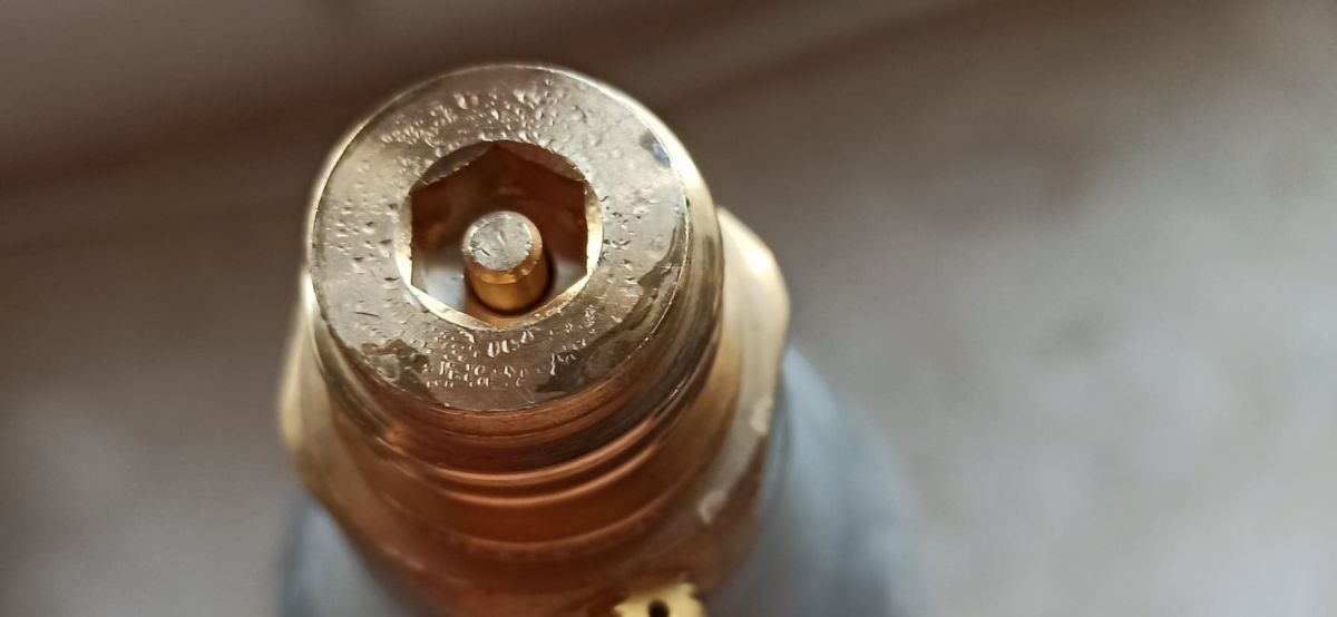

    #18 19437819
    Zbychul
    Level 22  
    Posts: 442
    Help: 31
    Rate: 189
    Honestly, it`s not very professional, but it does its job.
    Filling the Sodastream cylinder - only 150-200g of CO2 from the 6kg mother cylinder. How to improve?
    I drilled a hole in the groove to 6.5 mm and threaded M8, and a piece of M8 screw was drilled through to 4 mm and cut (without head) to approx. 2.5 cm. It must be adjusted so that it chokes the valve a moment before the small cylinder is fully tightened on its thread - if it is too tight, too much gas will be released into the air when unscrewed. these visible cuts are for adjustment and to give the gas a place to pass.
    edit:
    you also need to make sure that the pin does not rotate too easily, otherwise it will become out of adjustment. I gently tried it with a hammer :D
  • #19 19438232
    pirek85
    Posts: 15
    Rate: 40
    OK thank you
  • #20 19440221
    gelob
    Posts: 25
    Rate: 81

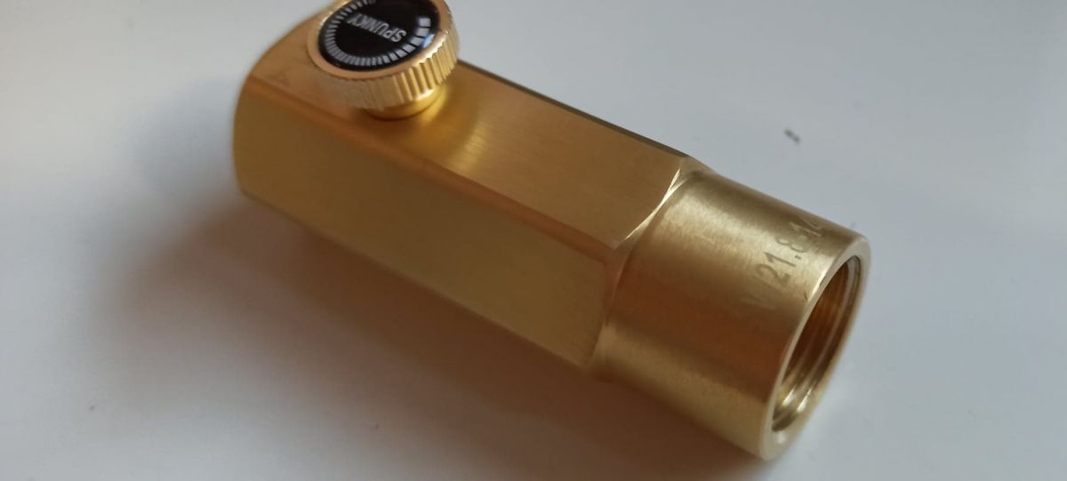

    I did a filling test without opening the valve with a friend who has a slightly different filling set. The bottle was cooled in the refrigerator for several days and contained 350g of CO2. Filled from a cylinder without a siphon (upside down). It seems that the gas pressure in the cylinder you are filling from is no longer too high, or your valve has a stronger spring.
    I ordered it on Ali for PLN 55 and I will ship it
    I think it will do its job.

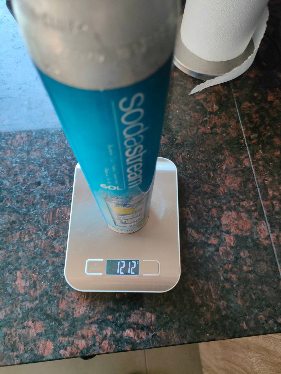

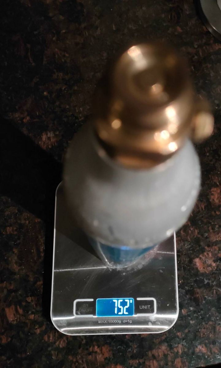

  • #25 19521663
    gelob
    Posts: 25
    Rate: 81
    Well, I already have a cylinder with a siphon, and a set with Ali which I posted a photo of earlier, a 2-way valve.
    Filling the first 303 g was filled quite quickly because I couldn`t feel the cylinder valve.
    Second filling 150g (filling extremely slowly so that there is barely any flow)
    Cylinders from the freezer, no CO2 inside, 2-way valves. Pin of the filling cylinder lowered to the maximum during filling.
    The next filling was 330g. I don`t know how some people get 425g....
