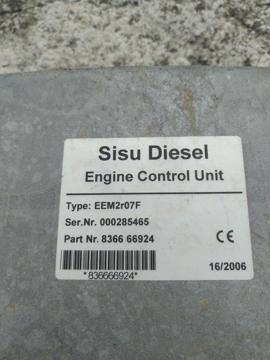

    I have a problem with the Sisu engine controller in Massey Ferguson 6495 from 2006. .
    The controller refuses to obey, most often after warming up, it disconnects the power pump once and the engine goes out, after some time the pump starts up again, which is a tragedy in transport. More than once it enters emergency mode and the revs drop to 1400. What I noticed that if it is in safe mode, after a slight tapping on the controller everything returns to normal, I suspect it is cold February, Unfortunately, the controller is flooded with mass and cannot be checked visually.
    Does anyone have a reference to a company repairing these drivers?

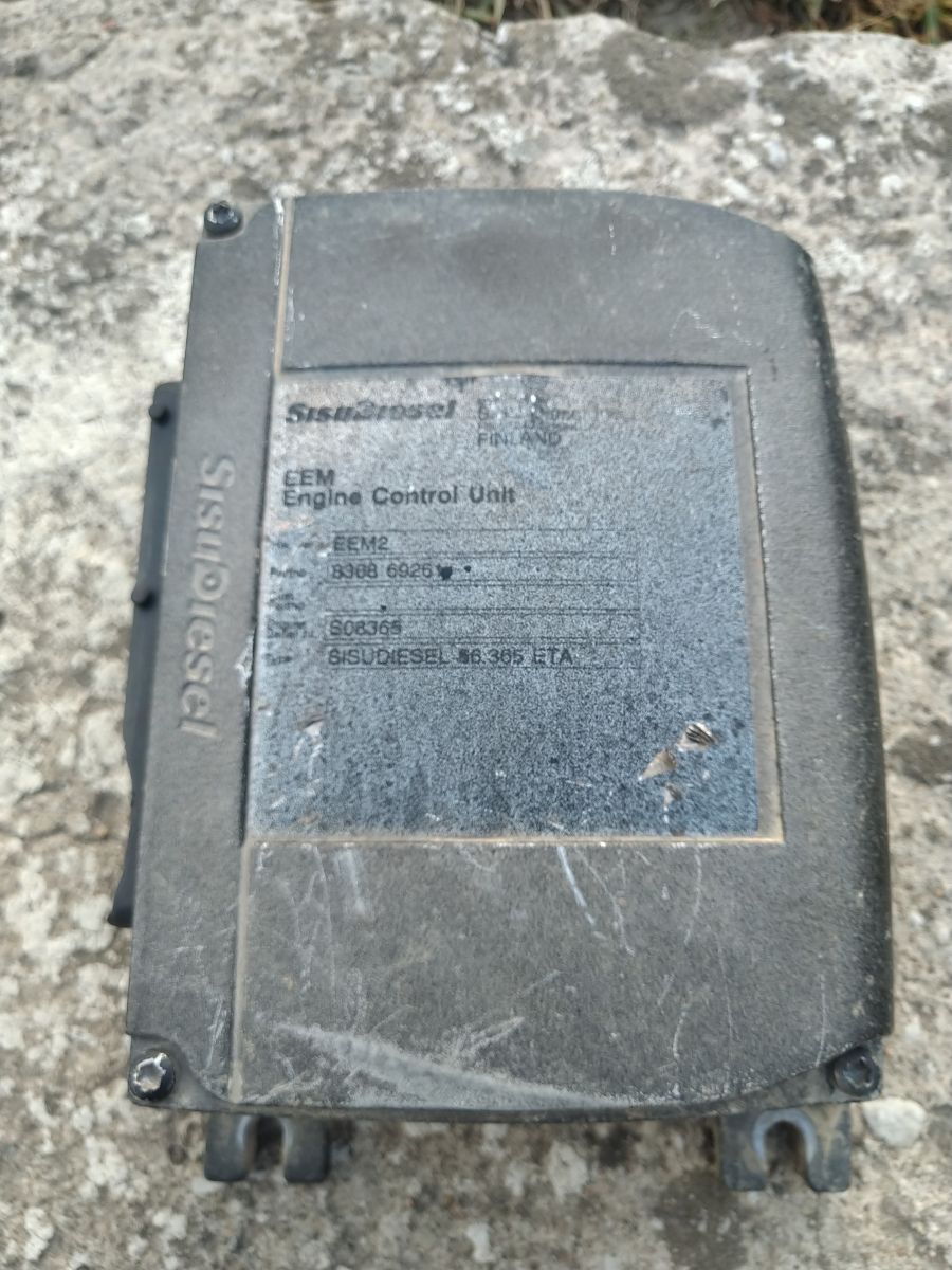

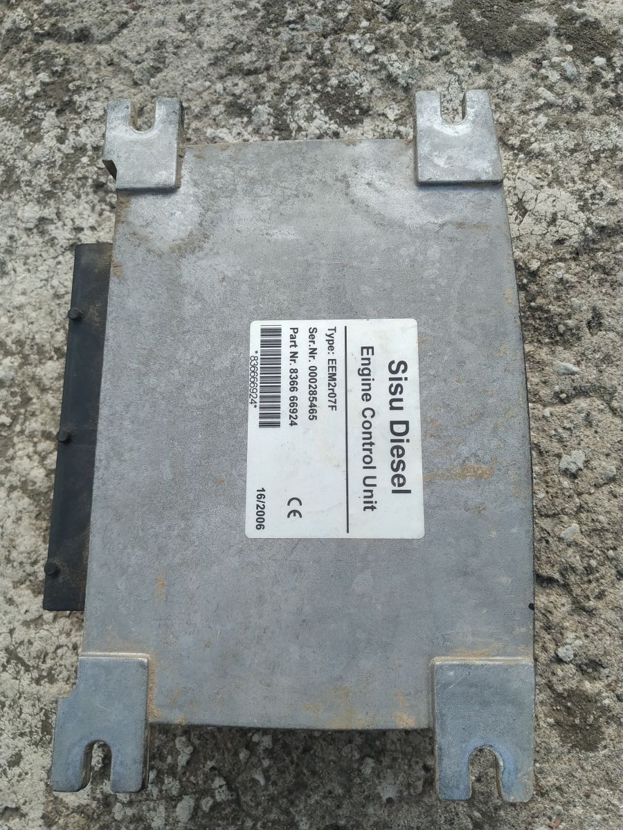

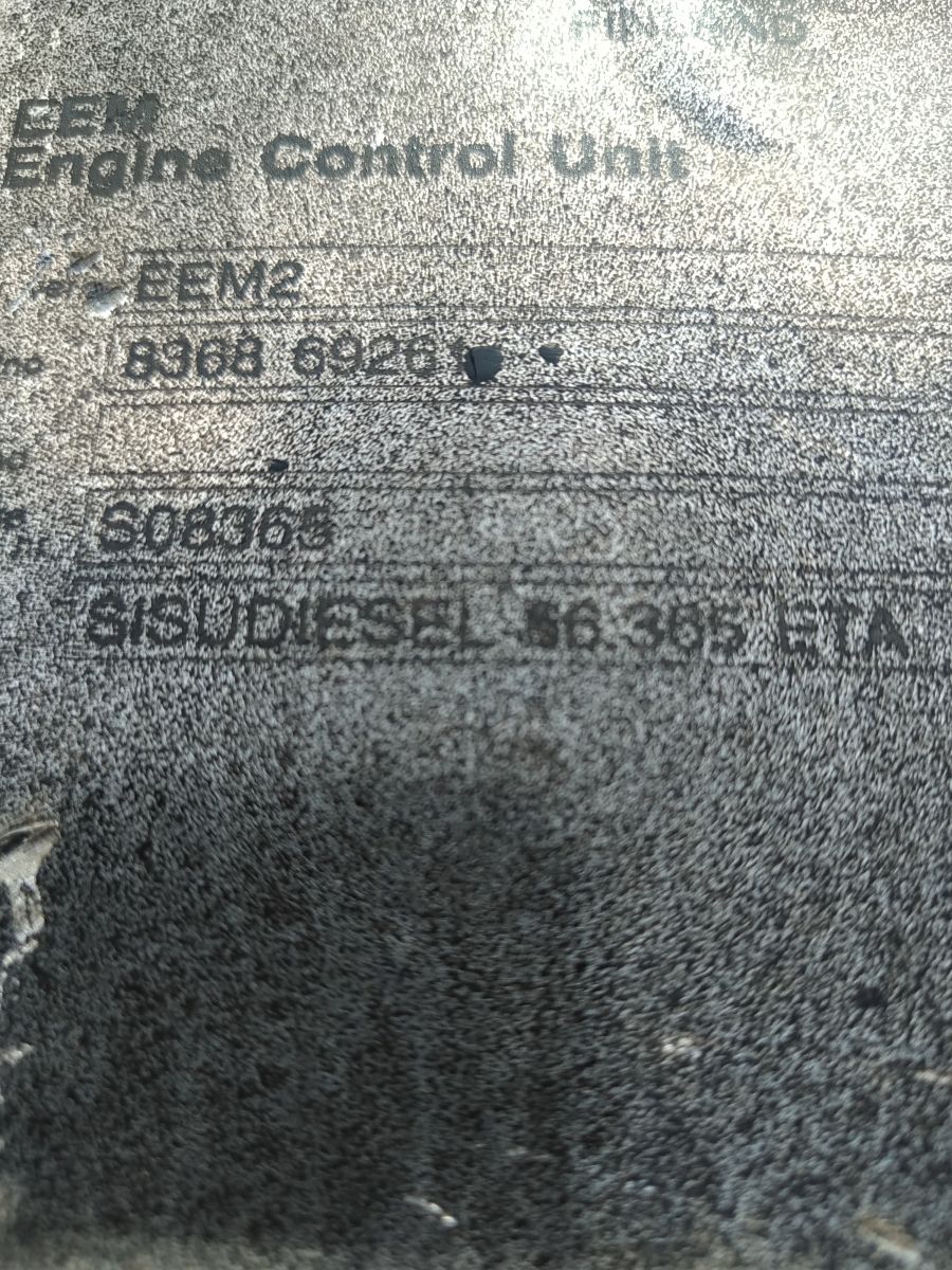

    Take a photo of the sticker, maybe I will find the same one.
  • #3 18671188
    zuczek37
    Posts: 15
    Massey Ferguson 6495 (2006) - EEM2 Sisudiesel Driver Repair and Engine Power Pump Issues Massey Ferguson 6495 (2006) - EEM2 Sisudiesel Driver Repair and Engine Power Pump Issues Massey Ferguson 6495 (2006) - EEM2 Sisudiesel Driver Repair and Engine Power Pump Issues Massey Ferguson 6495 (2006) - EEM2 Sisudiesel Driver Repair and Engine Power Pump Issues Massey Ferguson 6495 (2006) - EEM2 Sisudiesel Driver Repair and Engine Power Pump Issues
    I rewrote the fuzzy inscriptions
    EEM2r07F controller
    sisudiesel 66,365 ETA
    8368 69261

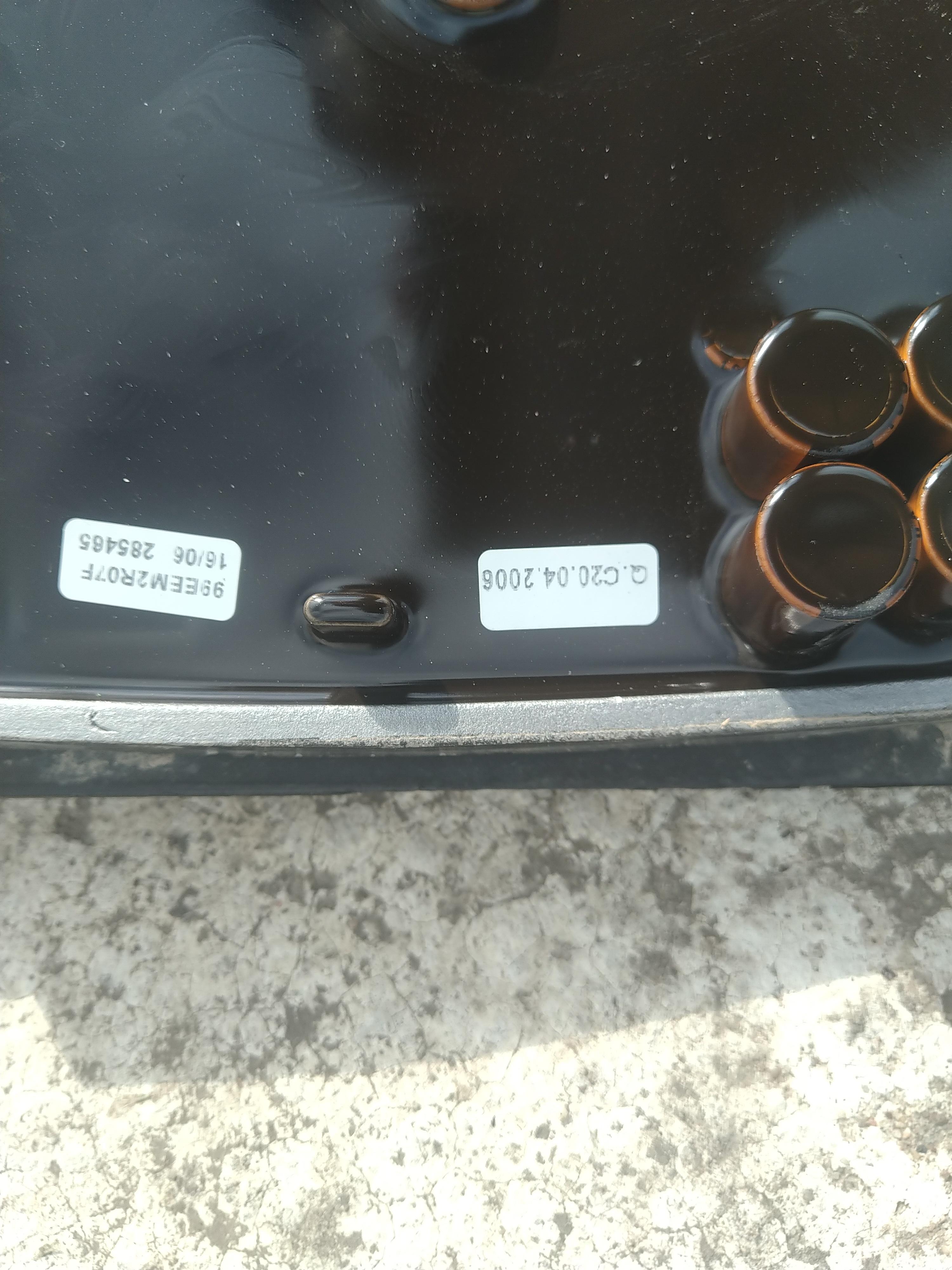

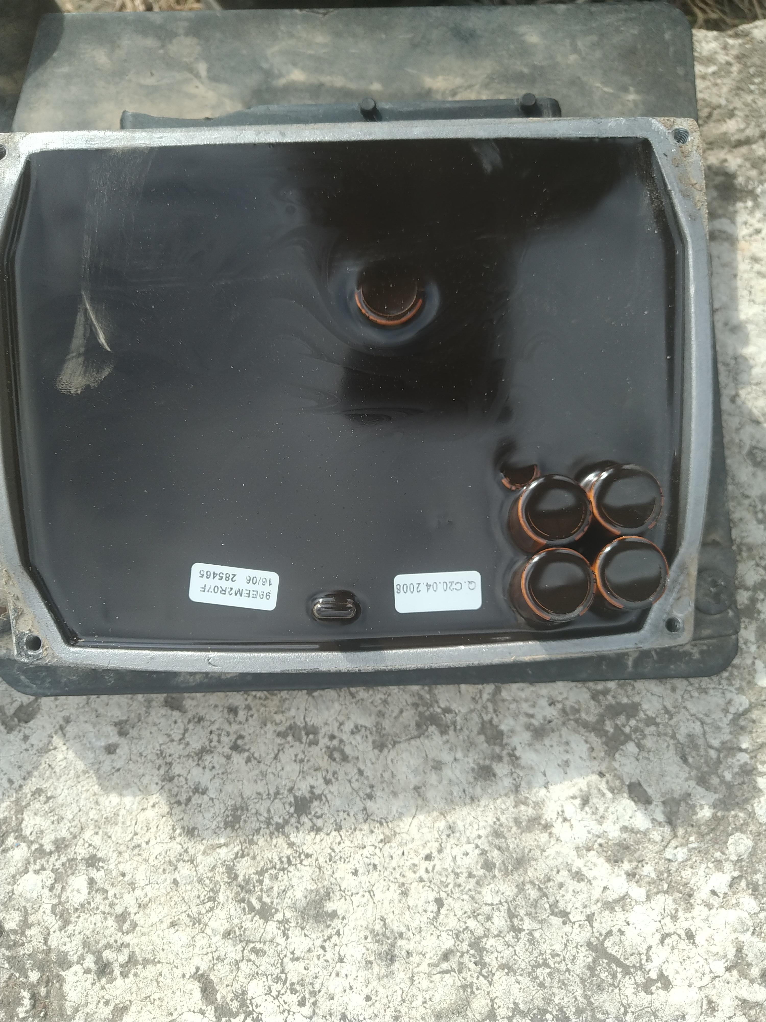

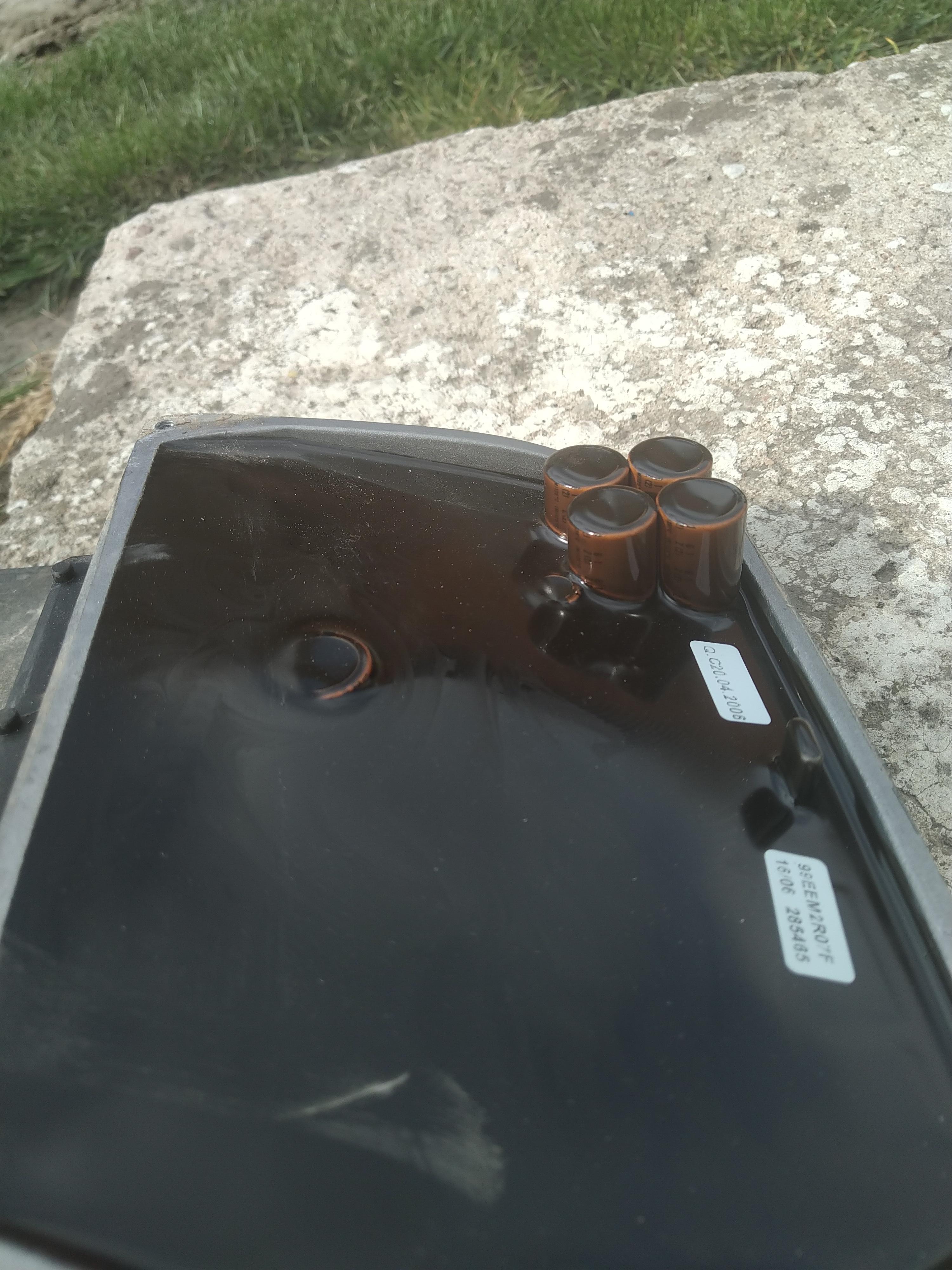

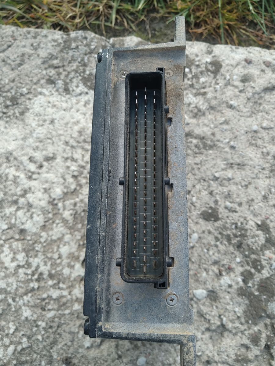

    What does this mass look like inside? Can it be picked out?
  • #5 18682871
    zuczek37
    Posts: 15
    The interior of the controller is flooded with a black mass resembling silicone, only maybe harder ... I think that it could also pick it, although it may take ages.
    the driver looks like this.
    • Massey Ferguson 6495 (2006) - EEM2 Sisudiesel Driver Repair and Engine Power Pump Issues IMG_20200510_154112.jpg (867.07 KB) You must be logged in to download this attachment.
    • Massey Ferguson 6495 (2006) - EEM2 Sisudiesel Driver Repair and Engine Power Pump Issues IMG_20200510_154105.jpg (1.12 MB) You must be logged in to download this attachment.
    • Massey Ferguson 6495 (2006) - EEM2 Sisudiesel Driver Repair and Engine Power Pump Issues IMG_20200510_154122.jpg (1021.26 KB) You must be logged in to download this attachment.
