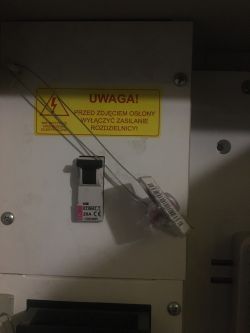

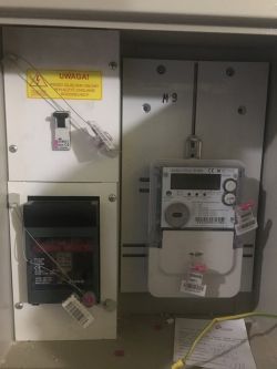

    I bought a flat, I replaced the electrical installation which is adapted to 3 phases with connection to an induction cooker for the future. (5 x 2.5mm? wire pulled up ;)
    The electrical system in the building was also replaced.
    I don't have an induction hob and I'm not going to change it for now.
    The devices I have are a 3.6kW oven, dishwasher (0.95kW/cycle), washing machine (0.91kW/cycle), A++ fridge and the rest is rather basic (TV, 2x laptop, vacuum cleaner, coffee machine, etc.).
    Currently, I do not disconnect the fuses, but there is something strangely connected by an electrician :) or rather this 5 x 2.5mm? wire to which only the oven is connected. This wire is connected to the fuse and the 3-phase differential and the test does not work on the differential, probably because there is one phase.
    And my question is whether this 1 phase and these 4kW contractual with 25A pre-counter protection is enough for me?? I have a contract with Tauron G11.
    I'm asking because I'm thinking about upgrading or applying for phase 3.
    I also don't fully understand what 4kW means.
    Thanks in advance for the hints.

    Pre-meter protection is probably more than 4kW. I have 25A in a single-family house and the power is probably 9 or 11, I don't remember. If it's 25A you'll be fine. The test button on the RCD does not work because either l1+l2+l3+N is to be connected incorrectly, and if one phase is, for example, L1+N, or it is faulty.

    Because the contractual power means that you are guaranteed power consumption up to 4 kW. But actually with 25A fuse you can draw around 5750 watts.

    If the pre-counter protection does not disconnect you, there is no point in pushing yourself into costs and increasing the power.
    Differential text may not work because it is 3f and you only have 1f drawn. The test can work between two phases and not between L and N, check the differential diagram how the test is connected.
    As for the standards, at 1f such a standard is 25A before the meter. Perhaps a few million flats, and certainly several hundred thousand flats in Poland have such protection. 25A will not disconnect at this current, 30A will also withstand the more so in an apartment where there are no continuous loads for many hours.

    @bartekfigura but I did not set up this pre-counter protection myself and no one touched it. I have this information from Tauron's website when I log in to my account. in the collection point details tab.
    Power type: 1-phase
    Read date: 05/02/2020
    zone 1: 0
    Read Type: New
    Contractual power: 4
    Pre-meter protections: 25 A
    Multiplicand: 1
    As for my installation, I don't put my fingers there, the electrician did it, he just said that the test did not work probably because one phase and basically it was supposed to be increased to 3 phases, although at the moment I am wondering whether to increase it because if not, then these RCDs would have to be done properly somehow.

    Pan.Kropa wrote:
    le actually with 25A fuse you can draw about 5750 watts.
    Non-stop and the fuse will not turn off.
    The value of this fuse determines the ZE and therefore seals it.

    I think I misled, I actually have 20A in the box, although the website shows 25A if it's this fuse.
    The stove remains gas. I think I will leave it as it is, only with this 3-phase fuse, I will take someone to make it work properly and safely. If it starts blowing fuses somewhere, I'll start thinking about increasing the power.
