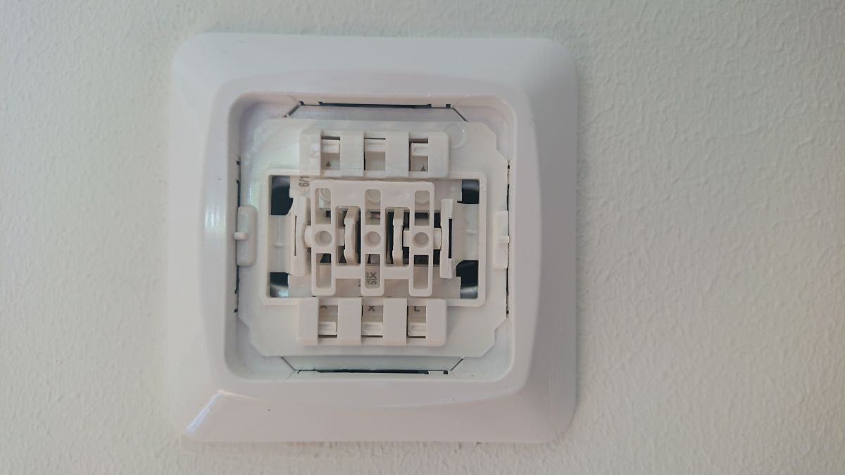

    How to get inside, how to remove the frame from this wonder. Brand new and don't want to break. Guide for Safely Removing Brand New Switch Frame Without Damage

    You must first remove this smaller, "inner" frame.
    She presses the outer one.
    Flat screwdriver and pry, there's nothing to be afraid of, this plastic is flexible and you can't see it anyway :P

    where to pry with a screwdriver?
    I still have such switches in the form of a panel, double or even quadruple vertically, a screw is a screw and I approach latches and plastics with a distance.
    P.S.
    it looks as if this smaller frame was together with the switch, hmmmm

    That's what you need to download. And pry basically anywhere, as long as you don't push the screwdriver too deep.

    I do not want to try to undermine on each side because the frame is "kneaded" under the screwdriver and will soon be replaced because it will look fake, so I would like to know where to pry.

    On both sides, in the axis of the switch, you insert a small flat screwdriver, slightly tilt it in the buoy and the plastic will spring off by itself.

    A friend warned me ;)
    My mistake, I didn't notice the two tabs on the switch axis.
