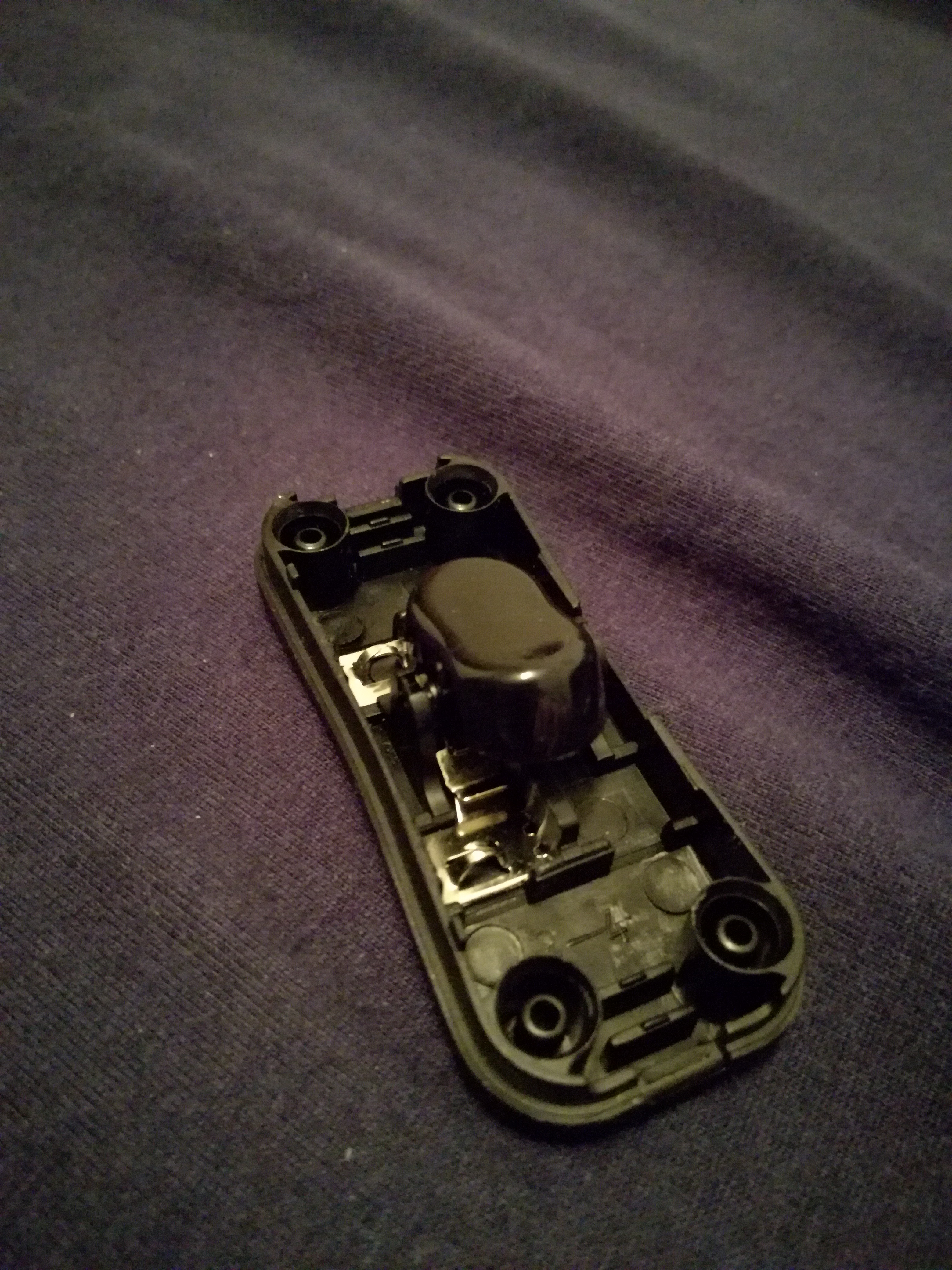

    Hello, I have a problem, it will probably be trivial for some, but not for me. I'll get to the point, I wanted to plug a through switch into the cable, I bought a regular switch, thinking that inside it will look like this
    Connecting Pass-Through Switch: Cable Wiring Guide with Switch Interior Images
    and there will be no connection problem, but when I opened the switch inside it looked like this
    and this is where the stairs got because I have no idea how to connect the cables. I am asking you for help.

    Little is seen in this picture.
  • #3 16341184
    Brivido
    Posts: 2865
    Help: 227
    Rate: 431
    Do not let the cable clamp on the protruding contacts there?

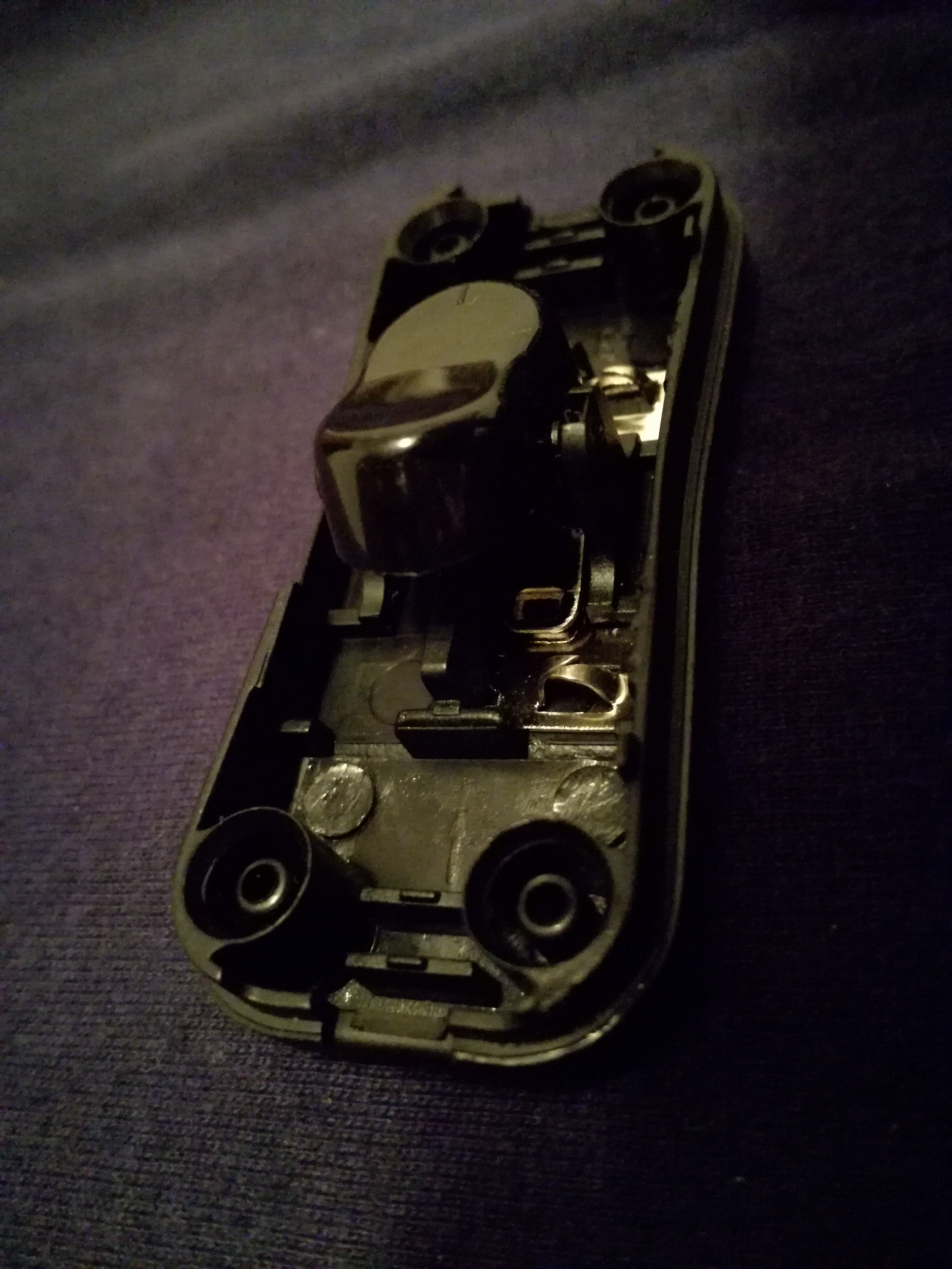

    Please, give me more pictures
    and how should I connect such a cable here
    Connecting Pass-Through Switch: Cable Wiring Guide with Switch Interior Images ?
  • #5 16341244
    kkas12
    Posts: 17406
    Help: 1076
    Rate: 4321
    You don't connect two veins and one you cut. You don't cut the other vein.

    ok just how do i connect this one strand to keep it?
  • #7 16341380
    kkas12
    Posts: 17406
    Help: 1076
    Rate: 4321
    You slide the earned vein under these cut plates and clamp it.

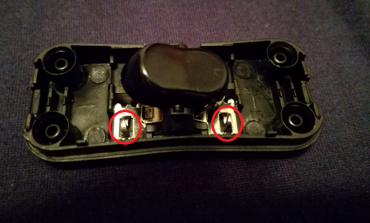

    sprytny_zbik wrote:
    how should I connect this one vein to keep it
    You slide the cable under the elements marked on the photo with a red circle and then tighten these elements
  • #9 16341520
    sprytny_zbik
    Posts: 18
    Ok, I understand that I lead the second wire in the middle of the switch but I don't cut it?
  • #10 16341610
    polaklbn
    Posts: 594
    Help: 55
    Rate: 162
    Exactly. And it's best to cut the brown vein.
