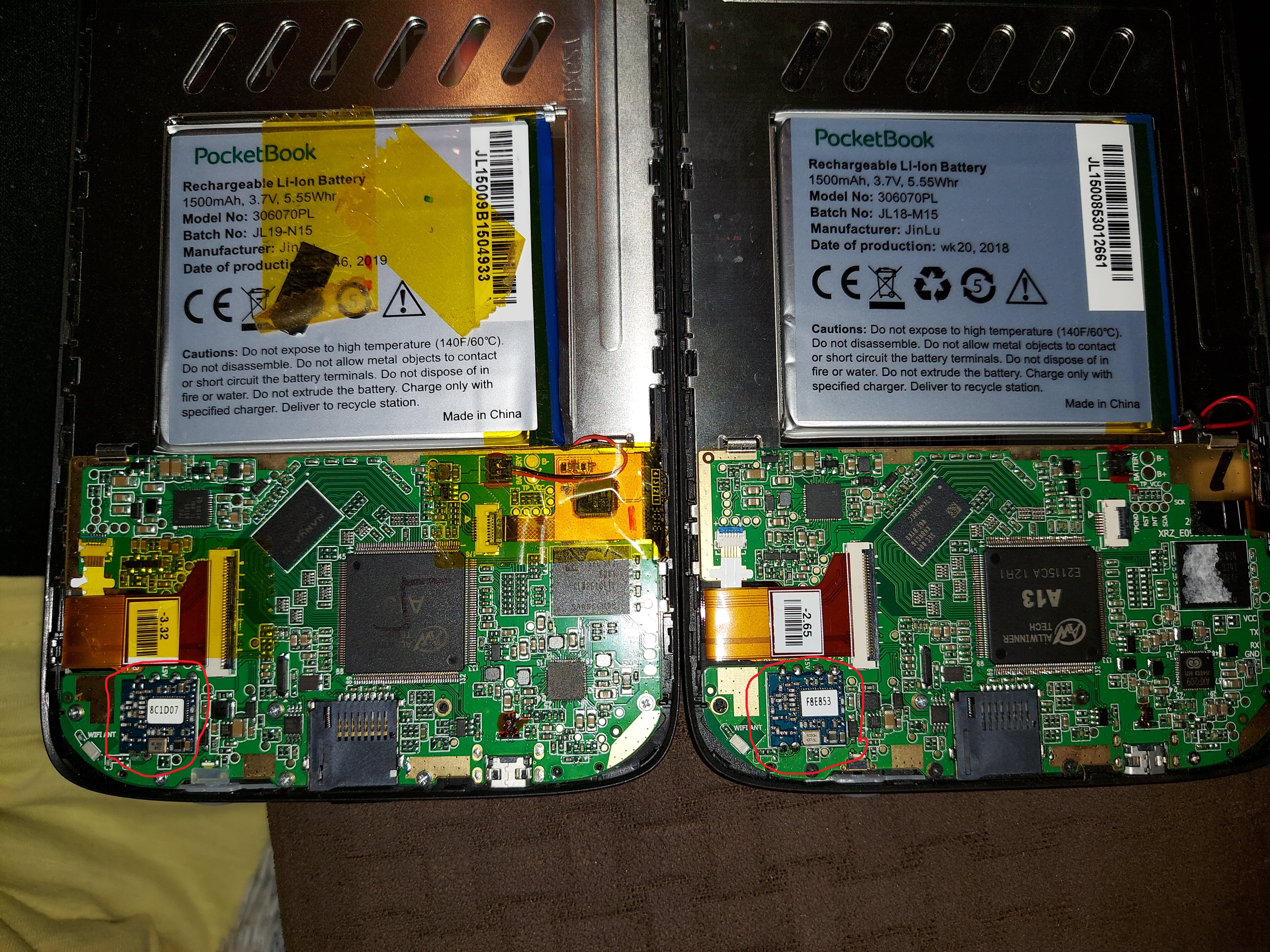

    gradek83 wrote:
    The ED060XH7 has the ELAN Yilong eKTF2232ALW chip, and in the old ED060XCD what is your digitizer chip?
    A colleague wrote a few posts above
    radoslav006 wrote:
    I have searched the internet for these displays and unfortunately they are not completely compatible. The touch sensor is glued a bit differently in both of these screens and it is related to the different configuration of the touch controller. Updating the PocketBook firmware overwrites this configuration and thus may break the touch operation. Some solution is to disable the update.
    Source Link: http://www.mobileread.mobi/forums/showthread.php?t=332356
    He concludes that the controller is the same and only the soft differs. I do not have to check, because now I have two ED060XH7 screens
    I was still browsing the motherboards of both readers in search of some resistor pulling some line to ground depending on the screen used and I found a different chip soldered to the motherboard, I marked it in the photo.

    zgred125 wrote:
    I was still browsing the motherboards of both readers in search of some resistor pulling up some lines to the ground, depending on the screen used, and found a different chip soldered to the motherboard, I marked in the photo maybe this, then
    These are just Wi-Fi modules

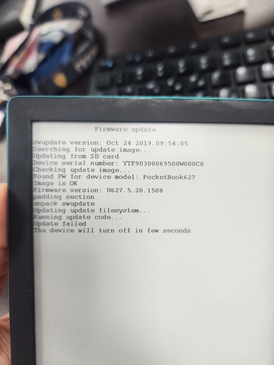

    #35 20167917
    zgred125
    Posts: 22
    If someone had a changed screen and yet was interested in updating the software, just do this:
    1. We download the soft we are interested in from the manufacturer's website.
    2. Unpack the archive on the SD card so that the SWUPDATE.BIN file is in the root directory of the SD card
    3. Turn the reader off and insert it into the soft SD card
    4. Remove the back of the reader. On the right side at the top of the motherboard next to the battery connector is connected a touch. For the duration of the update, disconnect it after disconnecting the battery - connect the battery.
    5. Start the reader by holding down the back keys (< ;) and front (> ;) .
    6. The reader updates itself without requiring any confirmation by the touch panel and does not change anything in the touch controller
    7. After the update is finished, turn off the reader, disconnect the batteries, connect the touch and reconnect the battery.

    sagia_geo
    >>20167917 >>20167917
    dose this worked /? when i have not the touch controller i cant flash the firmware. give me error.
