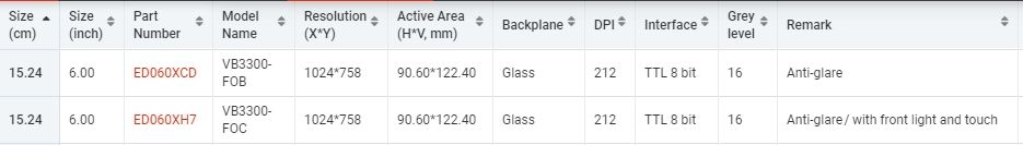

    I throw the update - the exchange was successful (with some lesson).
    I ordered the screens on aliexpress and I warn you that the compatible part number (ED060XCD) does not mean that it will fit this particular reader (!) What differs (with what I have encountered) are the dimensions of the connection ribbons, despite the theoretical compatibility as it is the ribbon is too short, or the thread from the connection is slightly shifted. Apparently, these screens are also used in other devices, where they are made with slightly different ribbons.
    Unfortunately, I cut myself, but I finally managed to buy a model that fits .. Besides, discussions with the Chinese are not the easiest ones.
    If someone needs it, I send my measured screen, the dimensions are removable with a ruler, so they may be inaccurate.
    I also ordered 2 more, thankfully it went free of customs and other extra charges, so I can resell at a similar price with a delivery time of 3 days, not a month :) - if someone is interested, you can contact me in a private message.
    Correct screen dimensions:

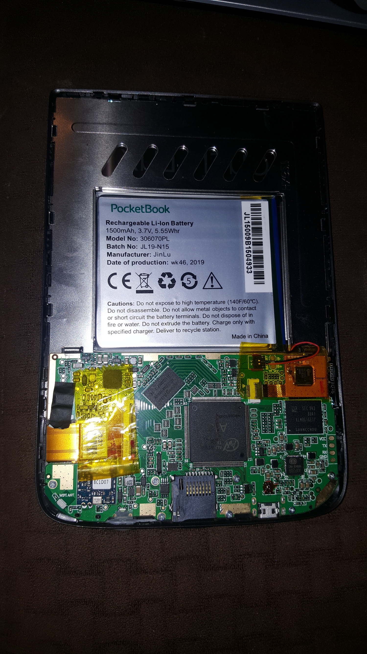

    Share this file, I'll take a look at what this contraption is.
    Or maybe you have a photo of the reader's motherboard, I'm curious what it looks like from the inside.
  • #23 19259031
    zgred125
    Posts: 22
    Overall it looks dull. The housing is mostly snap-on and sticky, instead of threads, screws are screwed into the plastic. This tape on the right is a touch tape on the left of the display and backlight.

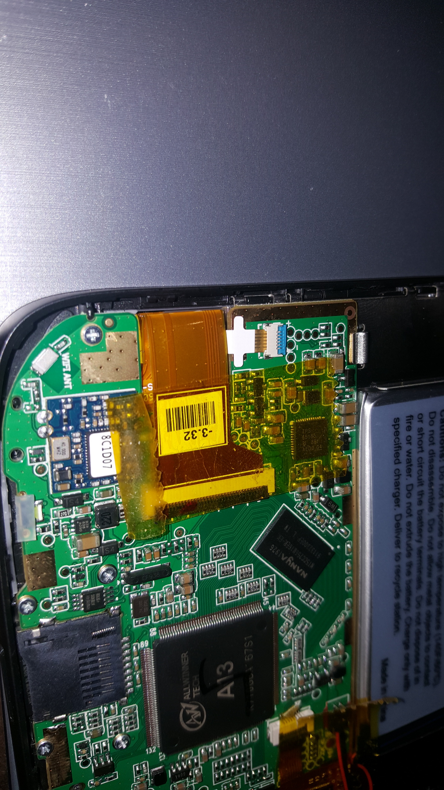

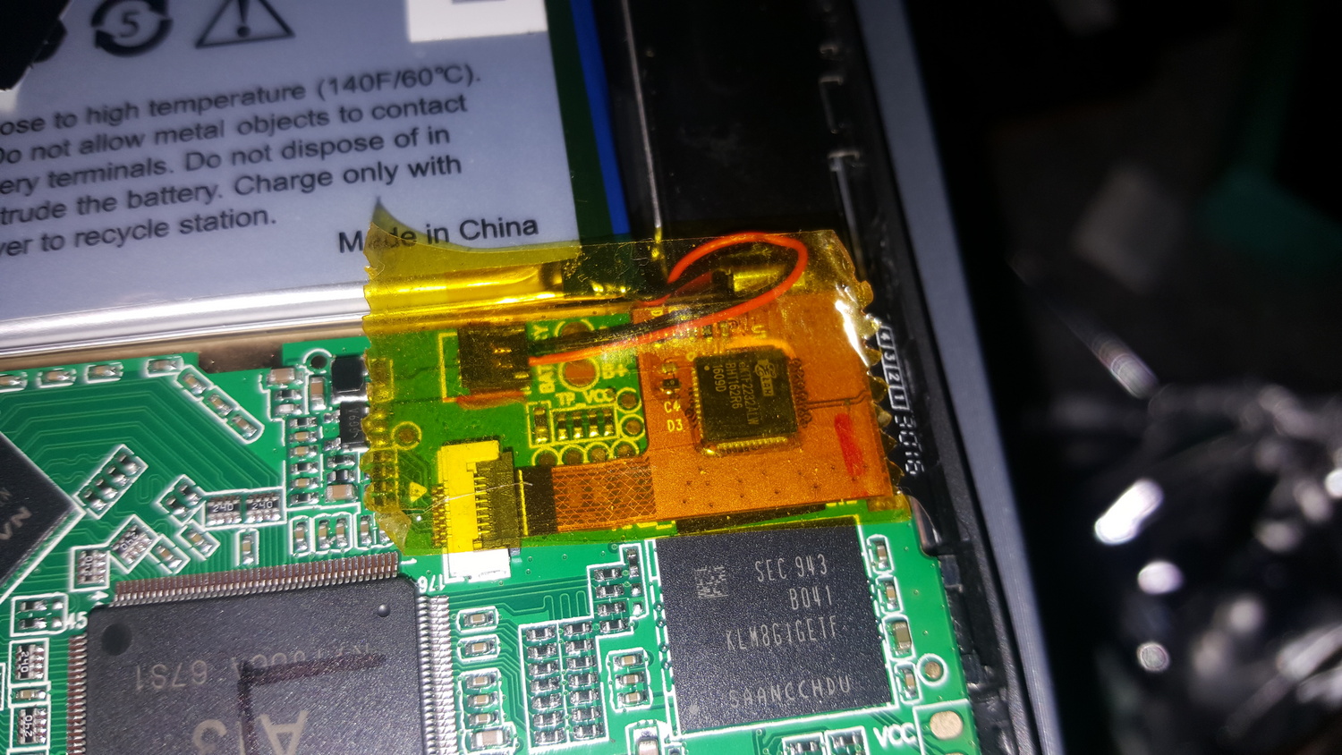

    Adds better photos. This white ribbon under the display tape. OTG does not work, when I try to upload soft, the update is done without a problem - I noticed by the icons that each version is a bit different. However, this format crashes all the time. Generally, I don't have new ideas anymore.

  • #26 19259189
    gradek83
    Posts: 9129
    Help: 930
    Rate: 2106
    The reader is on the allwinner A13 system. Sometimes this type of equipment has a recovery mode, especially a tablet, I do not know how it is with an ebook reader.
    software usually comes in .img format for tablets.
    Information which may be useful but not they must .

    So yeah. As I wrote before, I ordered another reader with a mechanically damaged screen. Only after ordering, I started to wonder what the version with the ED060XCD screen would be like, which is what I had originally in my reader. It would probably have been a bummer. Only today the reader has arrived. After removing the cap with trembling hands, I looked behind the tape and ED060XH7 there. You can see more happiness than reason. I put my screen on the donor reader and uploaded soft 5.20.1508 because I knew the screen was definitely working on it. I have uploaded 6.0.1118 to my reader. After the swap, the touch came to life and the reader flashes on the new software. Thank you very much for your help and commitment to my colleagues gradek83 and radoslav006. If someone had a similar problem, feel free to write, I can share the donor's motherboard for free. Regards
    ps. two more questions arise for me. It's about the update process, I wonder how and where the information is saved which touch controller is to upload the update program, I think that having this information, it is enough to edit the script and change one value and that's it. Or possibly replace part of the code so that the soft for the controller has two the same dock codes for the ED060XCD version. Unfortunately, I am too thin for that.

    zgred125 wrote:
    It is about the update process, I wonder how and where the information on which touch controller is to upload the update program is stored
    In ED060XH7 there is an ELAN Yilong eKTF2232ALW chip in this old one ED060XCD what kind of digitizer chip do you have?
    Looking for more or less displays that could be approached, I found a small list, but you need to take into account the type of touch panel used plus the type of matrix connecting tape and backlight. Overview table.
    Model Size Number of pixels Active area (mm) Outline Size (mm)
    ED060XCD
    VB3300-FOB
    6 inch 758 × 1024 90.58 × 122.368 (H × V) 101.8 (W) × 138.4 (H) × 1.1 (D) mm
    ED060XD7 6 inch 758 × 1024 90.58 × 122.368 (H × V) 101.8 (W) × 138.4 (H) × 1.1 (D) mm
    ED060XC3 6 inch 758 × 1024 90.6 × 122.4 (H×V) 101.8(W)×138.4(H) ×1.1(D) mm
    ED060XH7
    VB3300-FOC
    6 cal 758×1024 90.6 × 122.4 (H×V) 101.8(W)×138.4(H) ×1.1(D) mm
    ED060XH2 6 cal 758×1024 90.58 × 122.368 (H×V) 101.8(W)×138.4(H) ×1.1(D) mm
    ED060XG1 6 cal 758×1024 90.58 × 122.368 (H×V) 101.8(W)×138.4(H) ×1.1(D) mm
    ED060XC9 6 cal 758×1024 90.58 × 122.368 (H×V) 101.8(W)×138.4(H) ×1.1(D) mm
    ED060XC5 6 cal 758 × 1024 90.58 × 122.368 (H × V) 101.8 (H) × 138.4 (V) × 1.28 (D) mm
    ED060XD6 6 inch 758 × 1024 90.58 × 122.368 (H × V) 101.8 (W) × 138.4 (H) × 1.1 (D) mm
    ED060XD4 6 inch 758 × 1024 90.58 × 122.368 (H × V) 101.8 (W) × 138.4 (H) × 1.1 (D) mm
    ED060XH5 6 inch 758 × 1024 90.58 × 122.368 (H × V) 101.8 (W) × 138.4 (H) × 1.1 (D) mm
    More accurate information.
