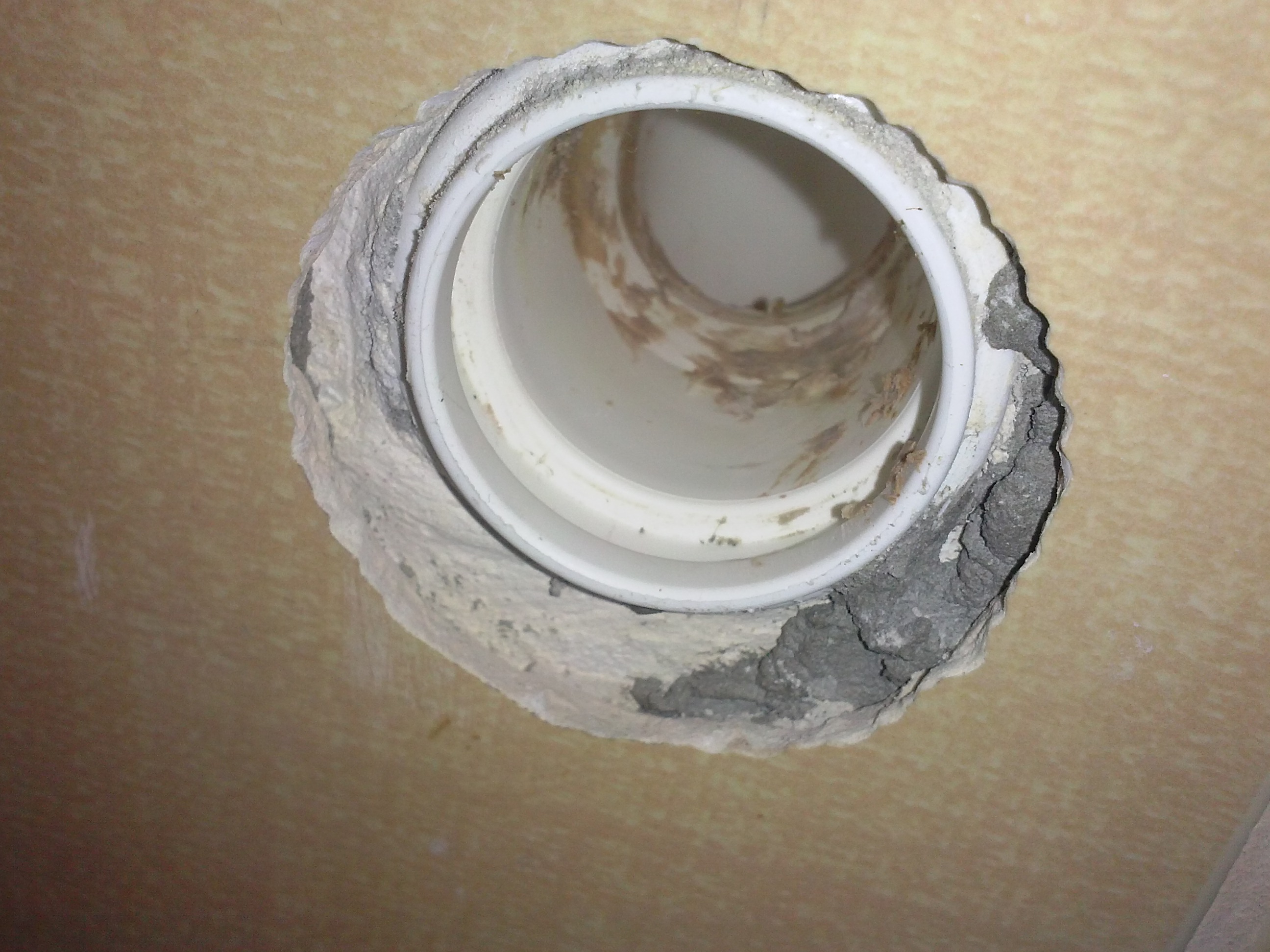

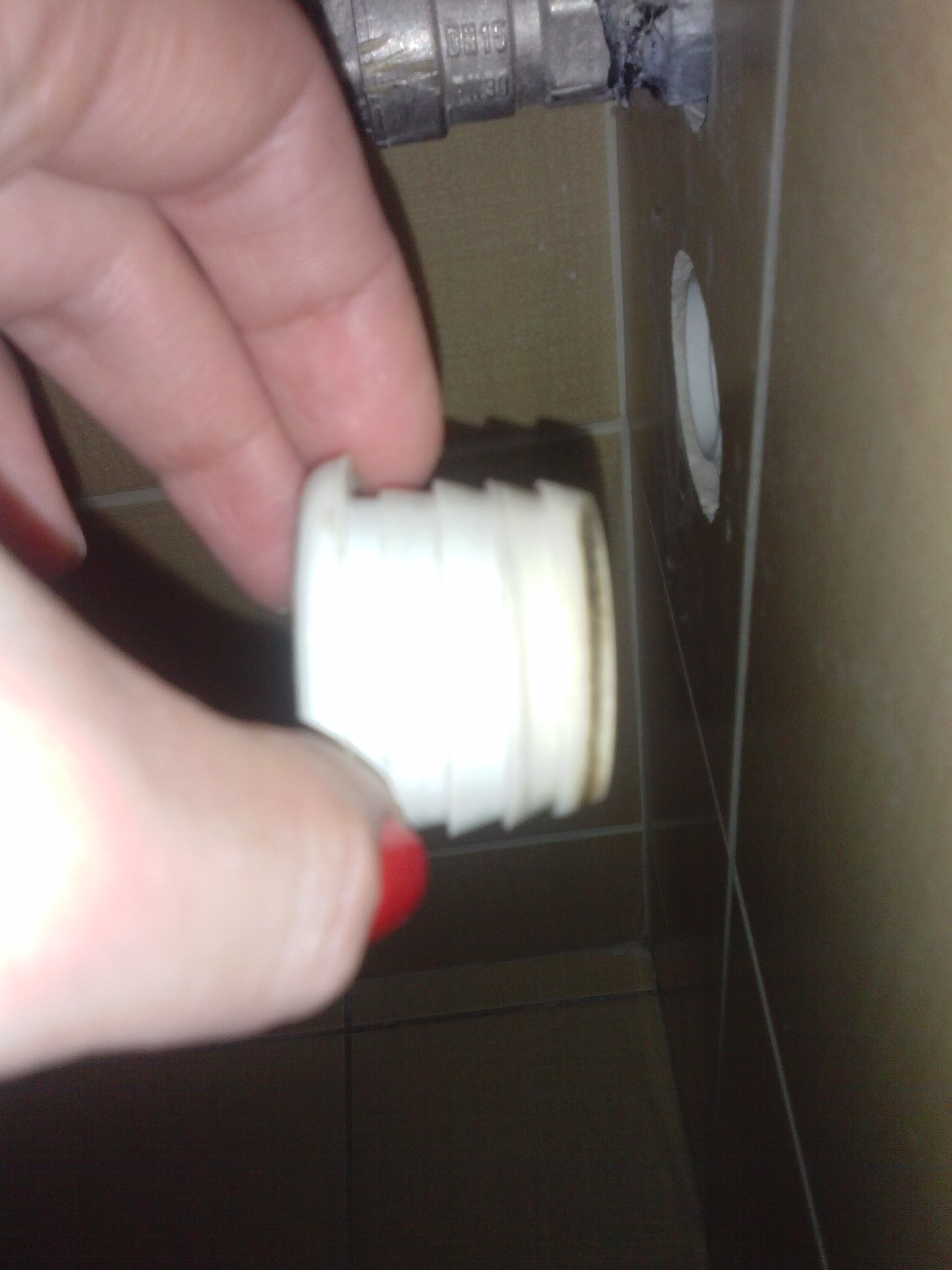

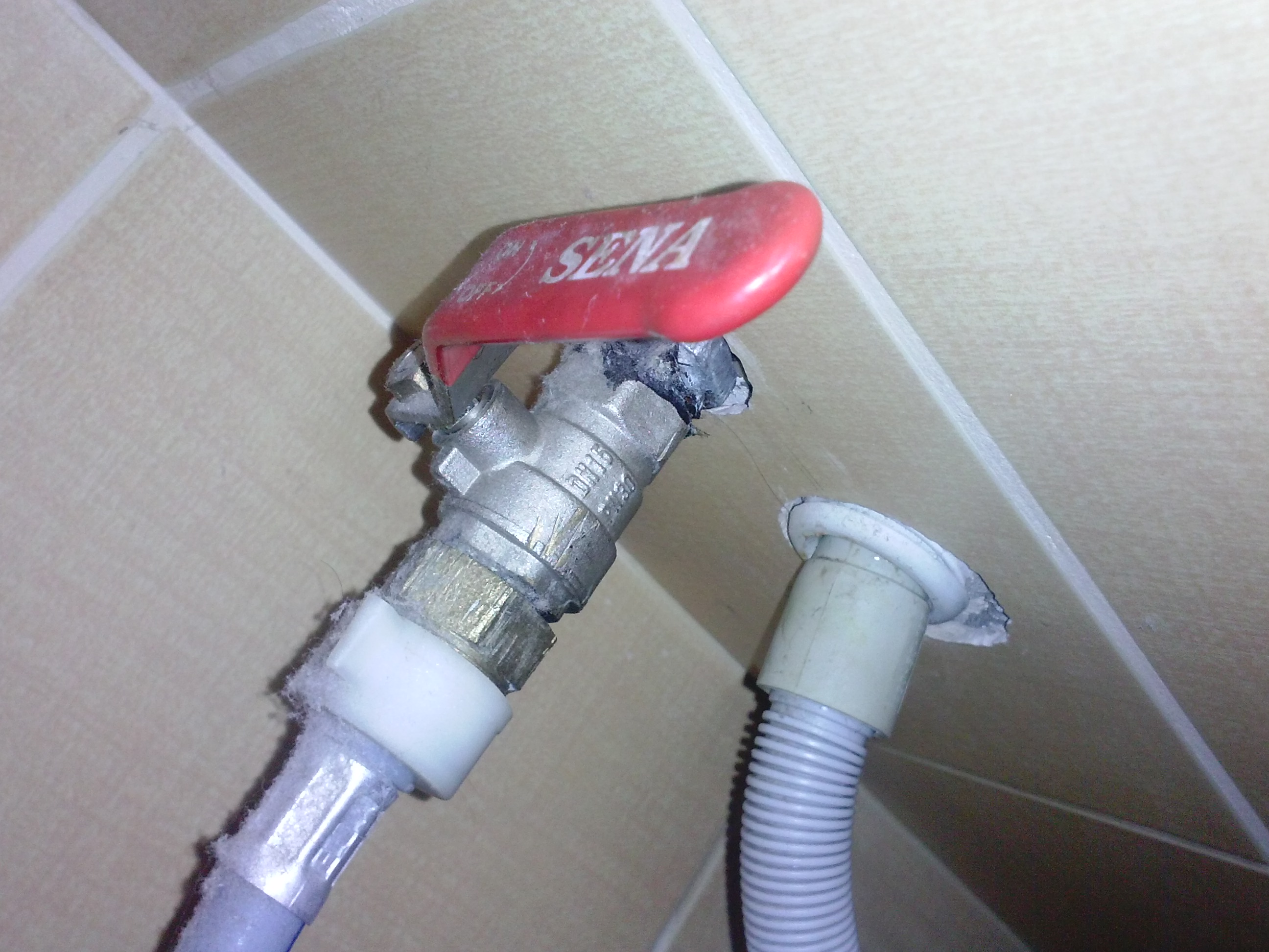

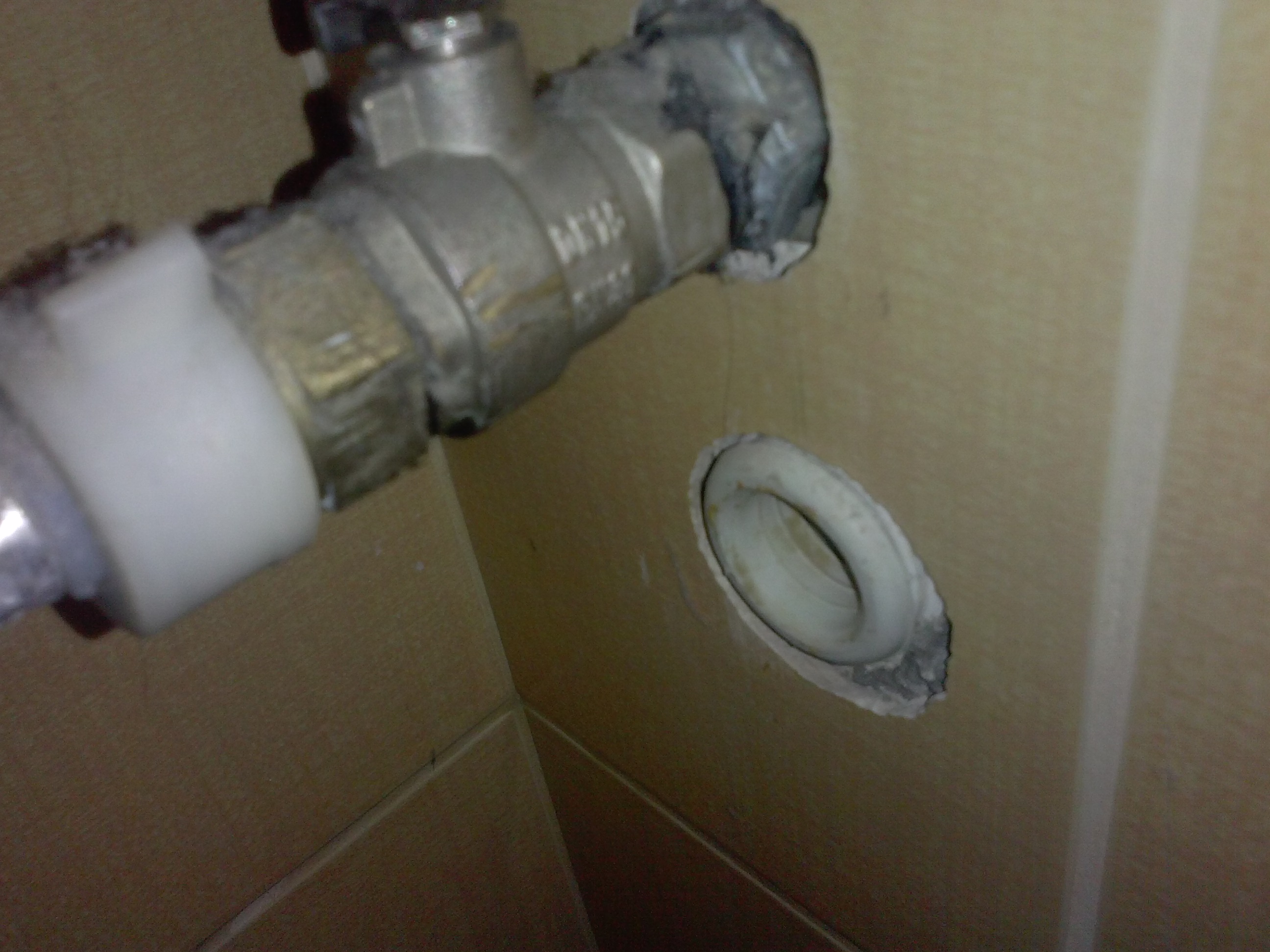

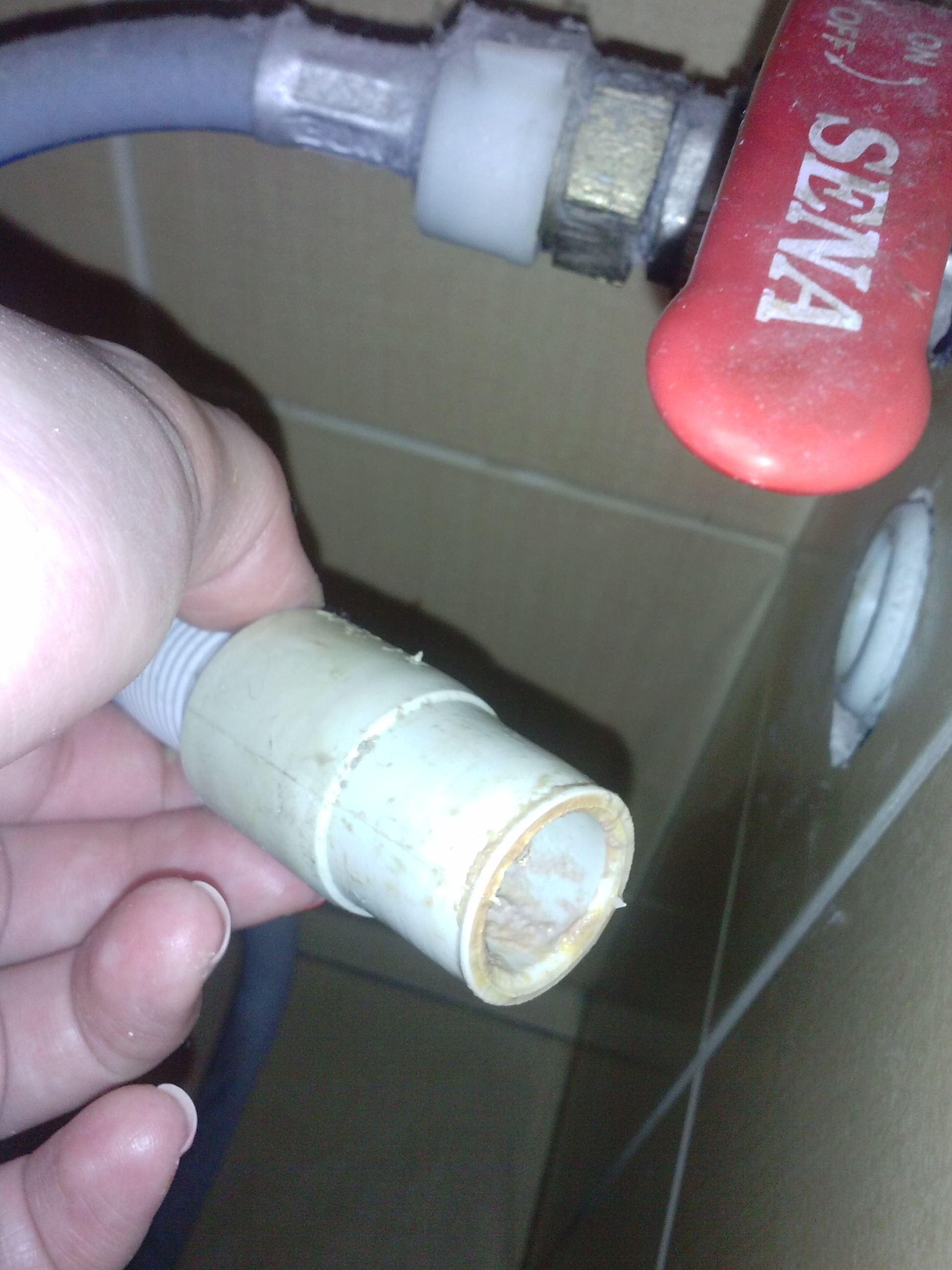

    Today my washing machine spilled water - the drain hose fell out. My question is, how can this contraption be reconnected? The drain hose is just pushed into the hole. Is it correct? I'm afraid that if I leave it like that, I will flood the bathroom again ...
    Second thing: why did the snake fly out? Was it too weakly attached, or is there some other reason?
    I attach some photos.

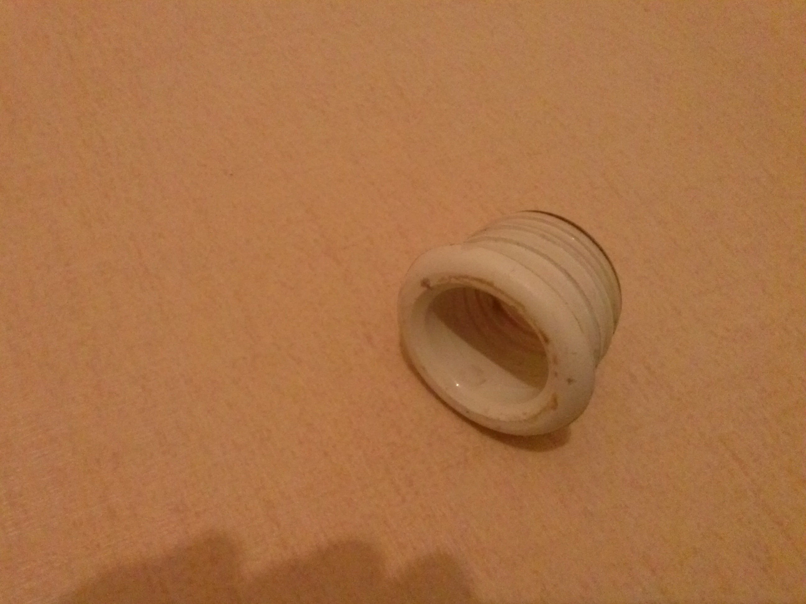

    In fact, there is a gasket (photo attached).
    Plus a photo of the drain itself. There was a light sludge / sediment, which I managed to remove, I will not show shit in the picture ;)
    So what, after pulling out, this gasket should be assembled with the hose, tightened with a compression clamp?
    Btw the gasket does not look rotten ...
    The second option is the installation of a siphon.
    Unless 2 in 1 should be assembled?
    I call the hydrulik after Sunday. But having already experience with 'experts', I prefer to know the solution myself first.

    It just came out after years. Clean this rubber gasket, put it in the drain and push the pipe from the washing machine so that the thicker part enters the gasket. It has to sit tight. I don't know if this siphon is needed. It is supposed to prevent the backflow of water and the stench from the pipes to the washing machine. And the drain hose always has water at the bottom, which does the same and blocks the odors.

    In the third photo from the first post - it is impossible to cram this hose in such a way that the entire plastic tip with the thicker part enters the rubber? And still loose? This is to replace the rubber because it has probably hardened. It seems to me that a plumber's call to such a fault is a bit extravagant :D
    And temporarily and temporarily, push it with the thicker part into the rubber and hang it to the valve in this way
    Washing Machine Drain Hose Disconnection: Reconnecting & Preventing Future Spills
    King Candle's method, but it will work :D

    It can be pushed to the end and even sticks to it, but it's just a word of honor: /

    Pour water into the washing machine and pump drain. If it does not blow the hose, it is a drainage channel.

    I bought a reducing rubber (32/25). In fact, when you insert the hose, it sits tighter. On the other hand, the end, which should fit tightly into the sewage pipe, enters it loosely. I returned to the store, I bought a gasket that should sit in the sewer pipe (and it wasn't there before!).
    He is sitting now :)
    A question, because to be sure I also got to the obi and there are 2 types of 32/25 rubber bands (with a narrower and wider mounting in the sewer pipe). Whether I mount a wider or narrower one, do I need a sealing ring anyway?
    Edit:
    Set of reducing rubber + ring do the job :)
    The first wash was successful!
