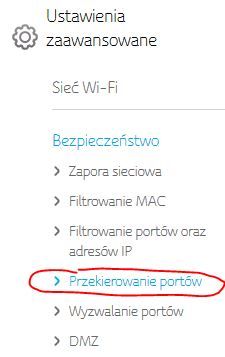

    The best and simplest is port forwarding, in the modem menu you should have the option as shown in the picture
    ConnectBox, UPC, Public IP, Bridge, NAS, truncated options and complications
    If you cannot see such a tab, you most likely have IP6 and as he wrote Goatee it must be changed either on your own (via the UPC website) or by contacting the phone

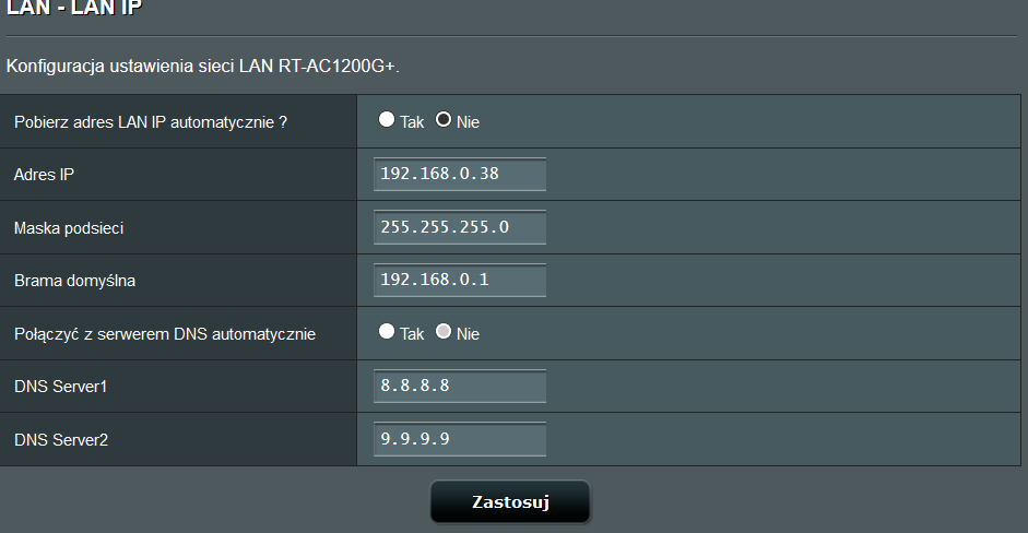

    This is what my network + Wi-Fi devices look like at this point. How to connect the NAS to a VPN in this setting? Maybe a hickey?
  • #16 18843777
    krisabc
    Posts: 70
    You do not need anything, if you do a VPN, then by connecting from outside your home, e.g. with a loptop, it will get access to the entire home network as if you plugged it into your switch at home.

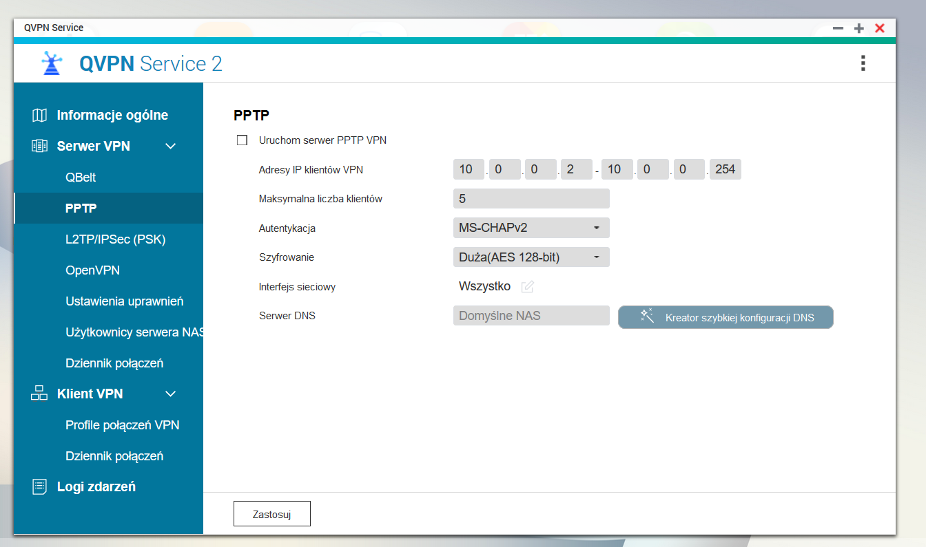

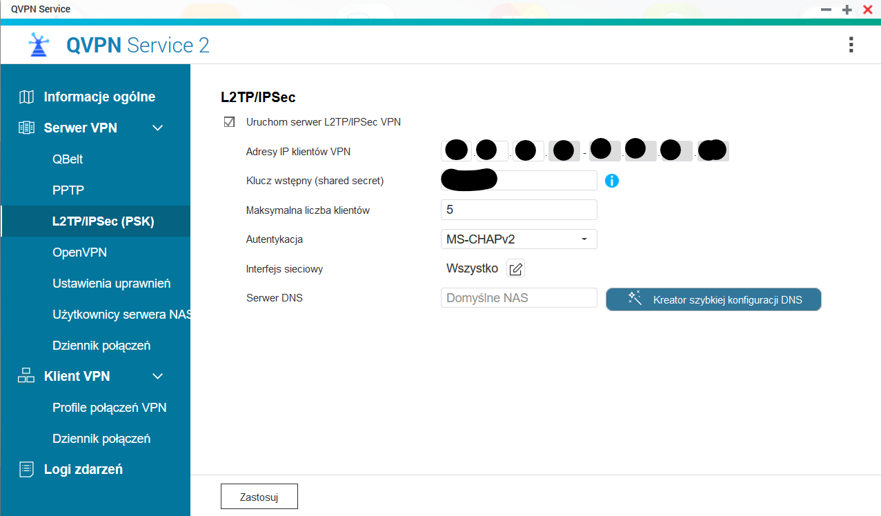

    As for the VPN on CB. The manual says that CB VPN supports it, but I don't think you can set the VPN server version on it.
    On the other hand, the NAS even has a dedicated application for VPNs - QVPN Service 2. There are many options - OpenVPN, QBelt, PPTP, L2TP / IPSec. It is also probably not too bad. Below are some screenshots. ConnectBox, UPC, Public IP, Bridge, NAS, truncated options and complications ConnectBox, UPC, Public IP, Bridge, NAS, truncated options and complications ConnectBox, UPC, Public IP, Bridge, NAS, truncated options and complications ConnectBox, UPC, Public IP, Bridge, NAS, truncated options and complications
    Added after 39 [minutes]:
    Okay, I'm successful. I set up a L2TP / IPSec VPN on this NAS and ... it works! (I did a bit of a blur. I don't know if some things are right, but the cautious one is always insured ...)
    That's enough, or was it not? Then the next step is IPv4 and port forwarding?

    This is ok.Now port redirection on CB (UDP 1194) on QNAP and external testing, only set a good (complicated and long) Shared Key

    As for redirecting, it is step by step:
    1) I log in to the CB (after changing to IPv4) and enter port forwarding.
    2) Adding a rule (not sure with ports)
    Local IP address: 192.168.0.10
    Starting LAN Port: 1194
    Ending LAN Port: 1194
    Public network starting port:?
    Public Network End Port:?
    Protocol: UDP
    I took the information from instructions (page 38).

  • #25 18844286
    krisabc
    Posts: 70
    Protocol: UDP
    as final also 1194
    Vester11 wrote:
    In addition, there is also a port triggering option, which detects when something is broadcast on a given port and only opens it. Is it safer? (It is in the manual)
    first fire on the standard redirect, then you can see the trigger with small steps :-)

    However, I still have some problems with the VPN. Using the IP checker, it shows the same IP address with and without a VPN connected.
    I want to check the option with the NAS connected as a client, because I think it should be so.
    When configuring the client connection on the NAS, a warning pops up about the server reserving IP addresses from 10.2.0.0/24 and possible IP address conflicts.
    Will changing the VPN server's IP address range from 10.2.0.2-10.2.0.254 to 10.3.0.2-10.3.0.254 fix this problem?
    The VPN connection you have configured on the client creates a virtual network card that gets the address from the VPN, the address of the physical card is not changed. Addresses for individual network cards on the client can be checked with the command ipconfig / all (in CMD / powershel)
    It probably won't work that way. The client "dialing in" to the server, if it authenticates correctly, a VPN tunnel is established.
    Leave it alone for now, taking small steps because it's easier to see what's not working.

    Oh, and will changing the option in Asus "Get LAN address automatically" to not make this address static? Leave DNS automatically or give some cloudflare?
    Yes, but enter the same IP address as you have now (192.168.0.38), dns can be given from google, UPC, cloudflare depending on how much you can enter

    On Asus, I just toggle the option, filling the windows stays okay.
    When I set up statica on NAS, I gave 9.9.9.9 and some cloudflare as DNS.
    I plan to change IPv6 for today around 19-20.
    Added after 7 [hours] 37 [minutes]:
    IP on Asus changed to statics. Now it's time for IPv4
