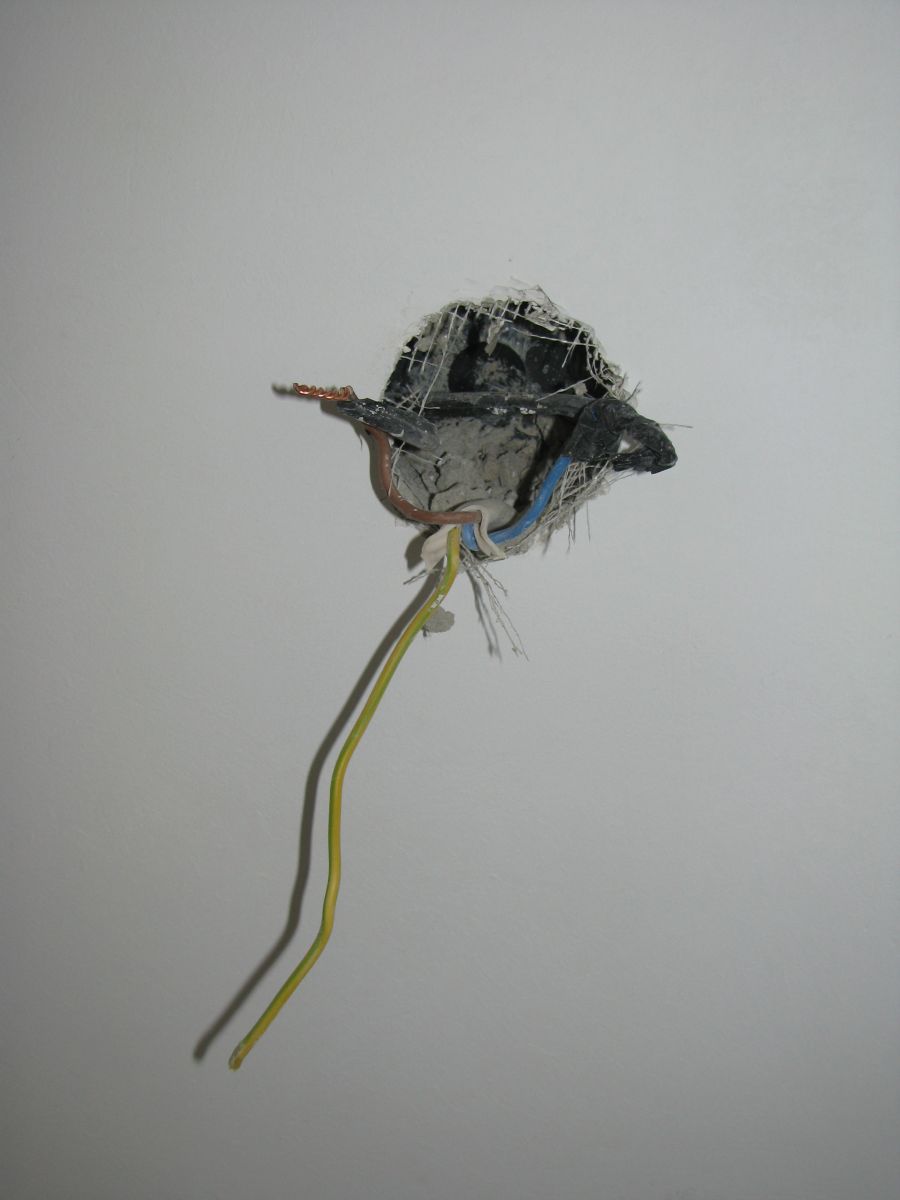

    How to check with a meter which cable is 0 and which is phase
    In this photo you can see various interesting bugs:
    - the switchgear has no main switch - the power supply is supplied to the comb that is connected to the lower connectors of the apparatus
    - the presence of the Żo conductors (protective conductor, this is the yellow-green one) indicates that the installation is three-core - but the question of what is the entire protective rail connected to - it cannot be seen in the photo - correctly, depending on the type of power supply network (TN, TT) this rail should be properly handled
    - eeee - regarding the above point - because I did not get a little sleep today - there are wires in the switchgear, but there are no cables in this example socket - this is a question what the masters have done with them - it is not sometimes that the fuse box was in another place and they moved it by adding pieces of 3-wire cables? if you can see something in the switchgear, it should of course also be in the socket - and it is not there
    - lack of a residual current device required by law (Regulation)
    - too large denominations - B20 - there cannot be a socket on the perimeter behind such a device, because the socket has a strength of 16A, and besides, there cannot be a 2.5mm? cable, and probably it is - also the question is why as many as 3 such devices
    - similarly, if you have any lighting with switches, it is also too large a value, because most household switches have a strength of 10A
    - plus the fact that I counted 8 blue wires on the neutral bus, and there are also 8 overcurrent switches, there is also a separate switch for each circuit
    - the supply of cables in the switchgear is too large left
    - I wonder if the bell is secured

    There was an electrician I asked for, but not the same electrician who had done anything here in the past. He also stated the same:
    What he said:
    -the builders used the existing cables already in the wall and added their own 3-wire cables here and there.
    - despite the fact that they added new 3-wire here and there, and so in not all of these places the protective cable was connected (electrician's surprise and mine too)
    - therefore, the sockets in which there was no protective cable (or it was, but not connected at all) applied a patent (if I understood it correctly) - the ground cable first to the pin and from the pin to the ground input in the socket. He said it was always more than nothing.
    -said that in the box it would be necessary to exchange these devices for other ones, because the ones I have are "exaggerated" with the cables I have.
    - the possibility of installing a RDC, although he emphasized that with these cables it makes sense on average ..
    He had a nice large device (computer) with him, as he claims for several thousand, and there I saw he made various measurements on the display, he had a lot of equipment in general.
    When I asked him how to distinguish between a ground cable and a protective cable (he was looking at this large device after it was connected). He said that "you can use a meter", I connect one probe to the phase and the other to the other cable - if the indication is 0 it is "rather protective", although he ordered to buy a multimeter with RFM and then it shows, for example, ~ 50 ..

    JohhnyCage11 wrote:
    The builders took advantage and took advantage of their and their client's ignorance and dragged him to pointless costs. Normal operation for tricksters, but as the saying goes:
    The old truth says - " a bricklayer and a forester are not a craftsman. And the painter is fern "
    The obvious fault of the client / principal, who should know that the builders do not know each other and will not know about electricity.
    I meet such flowers often, even here:
