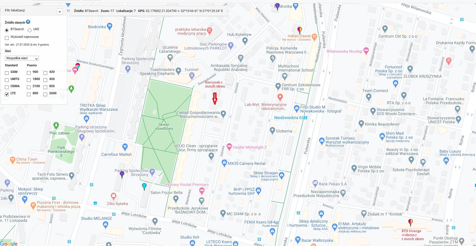

    Well, the BTS on Kaczmarskiego and Stwosza streets are not visible from my windows. The one on Kaczmarskiego Street is covered with a 10-story block on Blacharska Street and the one on Smoluchowskiego Street is similar. The ones on Stwosza 44 and 50 are to the north, looking from my block, i.e. exactly on the other side, because I have windows to the south.
    Here I see that BTS Orange is in the vicinity of Wałbrzyska, even two or more, which is why the Internet works best for me, as the modem is literally hanging on the window facing to the left, because the station is visible at a considerable angle to the left. 800,1800,2100,2600. It is visible a bit by convention, but it works best from the surrounding area. Unless something else turns out after new tests. But it has been so so far. I say right away that it is not possible to mount the antenna on the roof, one is with 25 m of cable, two that it is not allowed. It will not work in the other direction either, because to the west it will not do anything because there is a block of flats in Blacharska, and to the east it will not be possible because the neighbors do not guess. I only have the South to use and the South East.
    Seeking the Best LTE Modem/Router Upgrade for Huawei E3372: Stability and Performance
    http://beta.btsearch.pl/?dataSource=locations...s=lte&bands=?er=52.175039%2C21.021234&zoom=17
