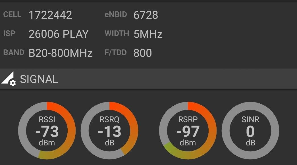

    I have a request for advice on what router / modem to buy for the Internet in PLAY to obtain LTE band aggregation.
    I am currently using the Huawei E3372 modem and this antenna: allegro.pl/oferta/antena-lte-800-mhz-mimo-ts9-crc9-sma-10m-9188143196
    The achieved maximum speeds are DL 15Mb / s, UL 4 Mb / s.
    Distance to the transmitter (BRE4421, eNBID: 6728) approx. 5 km, hills, holes and tall trees.
    I was considering buying a used Huawei B525s-23a from Plus (?) Perhaps it will be necessary to replace the antenna (?)
    What do you propose to get a stable and fast connection to work from home for reasonable money - supposedly "jitter" is important - due to the work "on headphones" ;-)
    Thank you in advance for hints and proven solutions ;-)

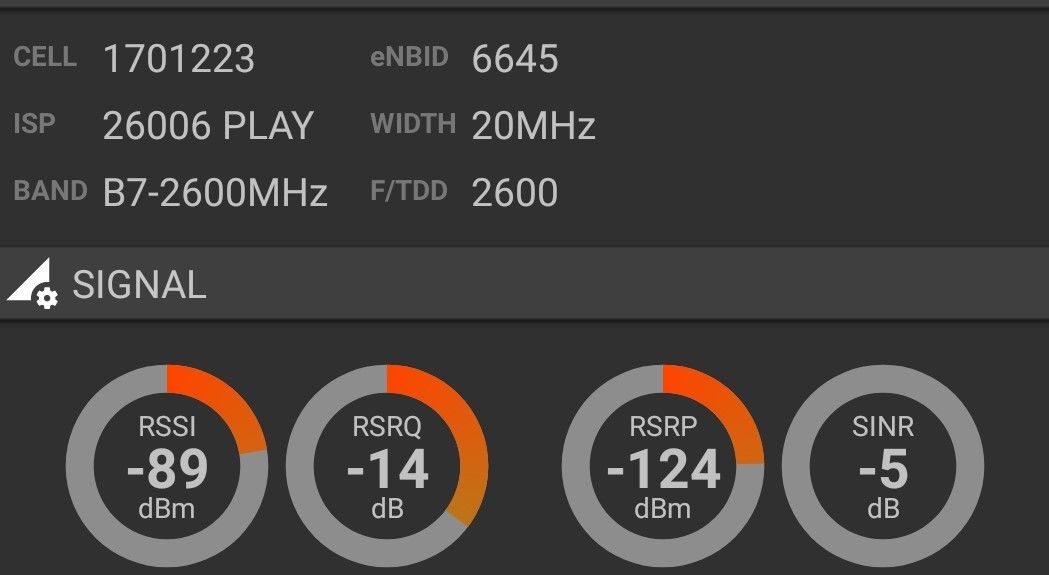

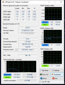

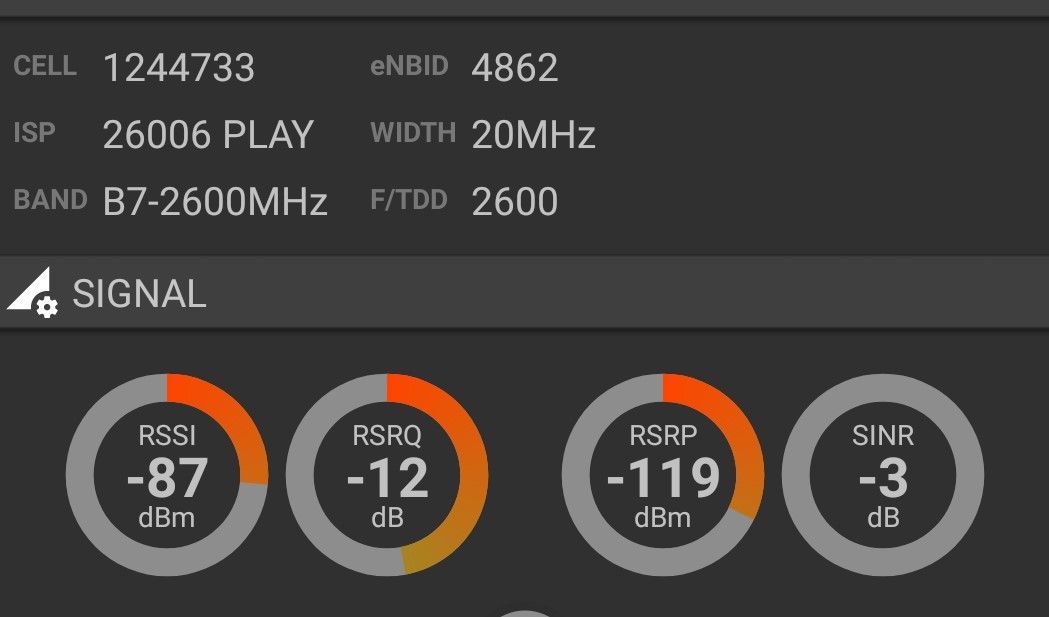

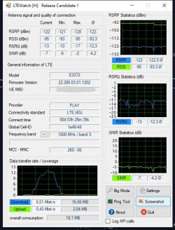

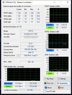

    Hello again, I was finally able to take some measurements recently.
    Measurements made using LTEWatch programs on the E3372 modem and HUA CTRL on the B525 router, respectively - devices placed on the mast ~ 2.5 above the roof level at the destination of the antenna installation.
    What router and antenna do you recommend (aggregation from 800 is probably not an option ;-) rather 1800 + 2100? From what I checked, B525 should aggregate 1800 + 2600 - but it probably won't play here (?)
    Transfers to the B525:
    - for 2600 - practically zero,
    - for 2100 - DL up to 23 Mb / s, UL 2.5 Mb / s,
    - for 1800 - DL up to 19 Mb / s, UL 1.7 Mb / s,
    - for 800 - DL up to 9 Mb / s, UL 7 Mb / s.

  • #7 19337019
    matek451
    Posts: 31144
    Help: 4334
    Rate: 5765
    B525 to Play in this location is not suitable LTE2100 / LTE1800 / LTE800 from Kolacin signal on the first two weak and on LTE800 sufficient, LTE2600 from Stryków-Brzezińska 41 and from Brzezin-chimney PEC and here it is weak, but you can even fight for the aggregation of 3 capacitive bands LTE with PEC.

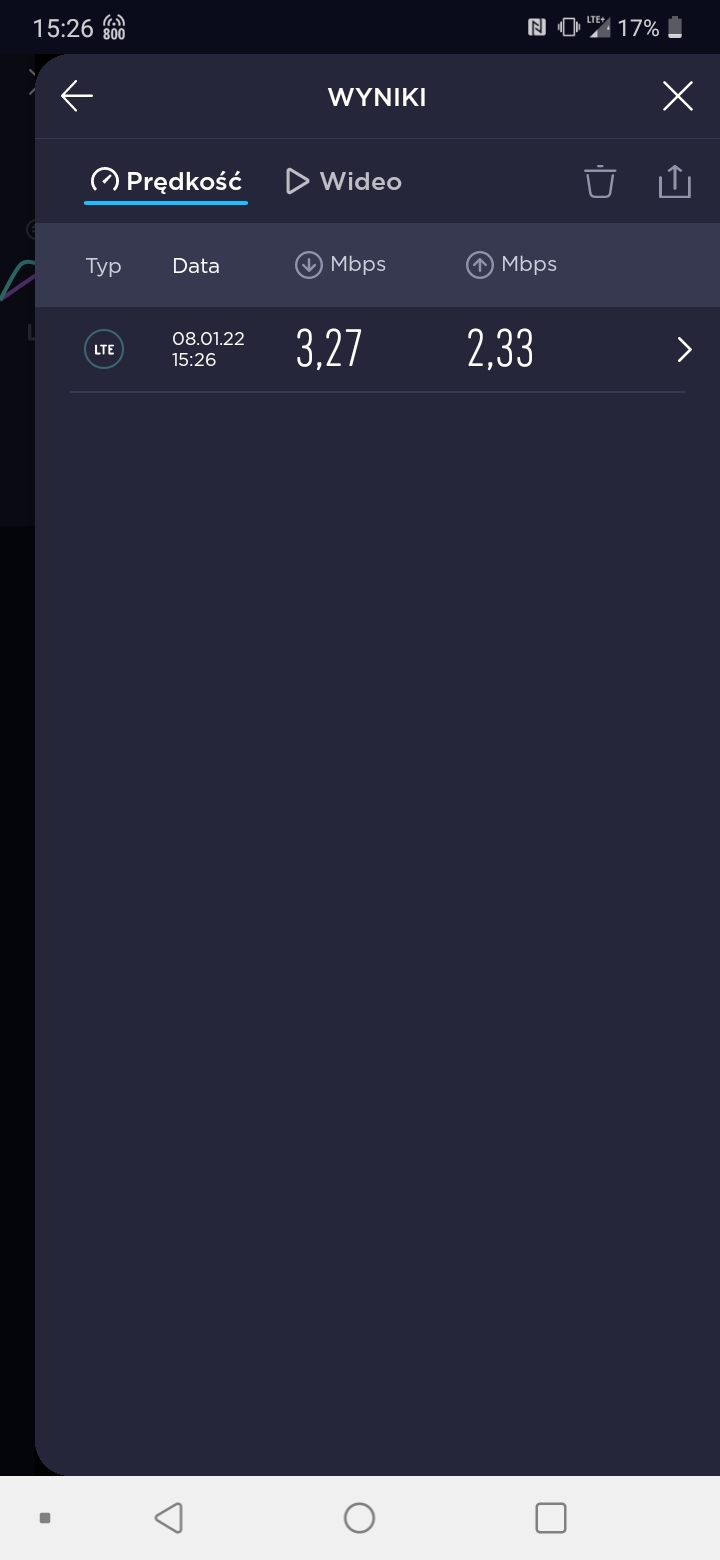

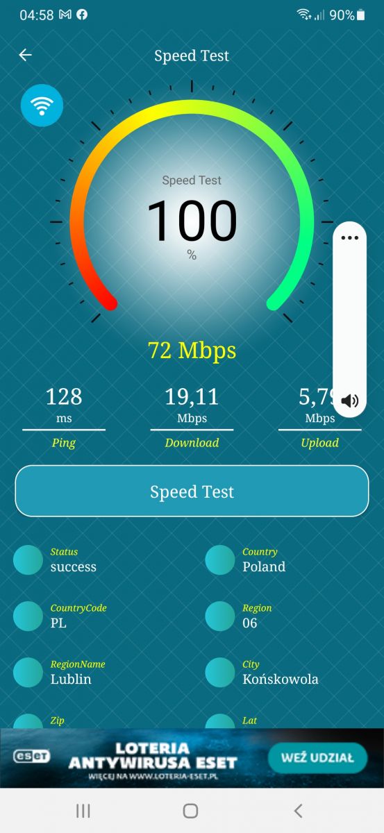

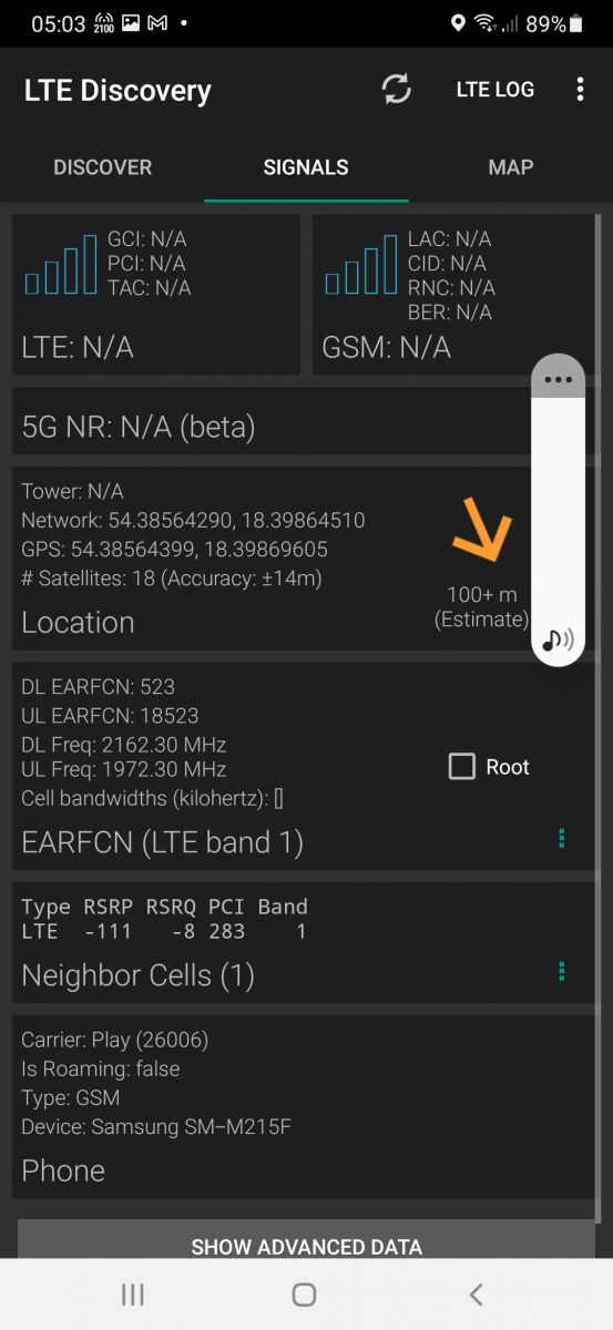

    I did the tests on the phone Which PLAY Internet router (with LTE 800 MHz band aggregation?) Which PLAY Internet router (with LTE 800 MHz band aggregation?) Which PLAY Internet router (with LTE 800 MHz band aggregation?) Which PLAY Internet router (with LTE 800 MHz band aggregation?) Which PLAY Internet router (with LTE 800 MHz band aggregation?) Which PLAY Internet router (with LTE 800 MHz band aggregation?)
  • #22 19593187
    NOWY987654321
    Level 25  
    Posts: 542
    Help: 87
    Rate: 96
    Unfortunately, at home you only have sufficient signal on the slow, long-range LTE800 from BTS Leźno, and very poor signal parameters on LTE1800 / LTE2100 / LTE2600 from this BTS. In addition, in PCI neighbors from another base station and even worse signal parameters on the same bands, it is difficult to say whether this is PCI from BTS Banino or another. Do the same test outside.

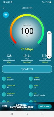

  • #27 19807683
    eto07eto
    Posts: 43

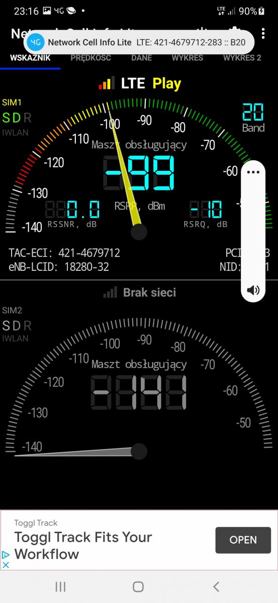

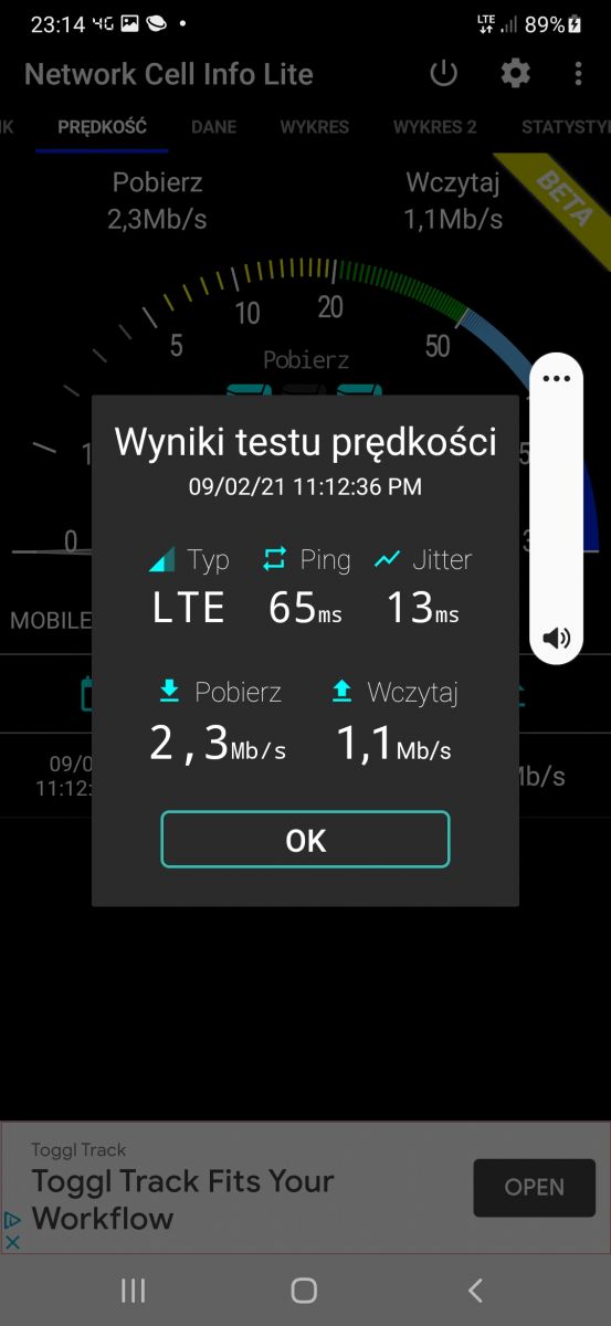

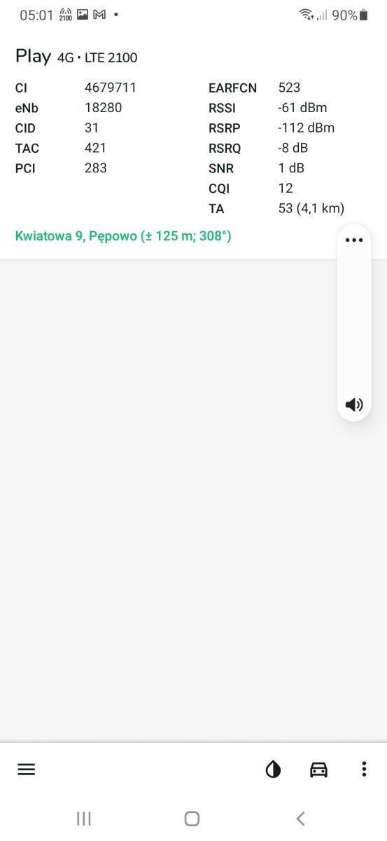

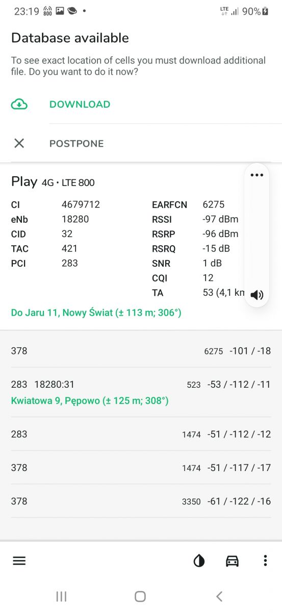

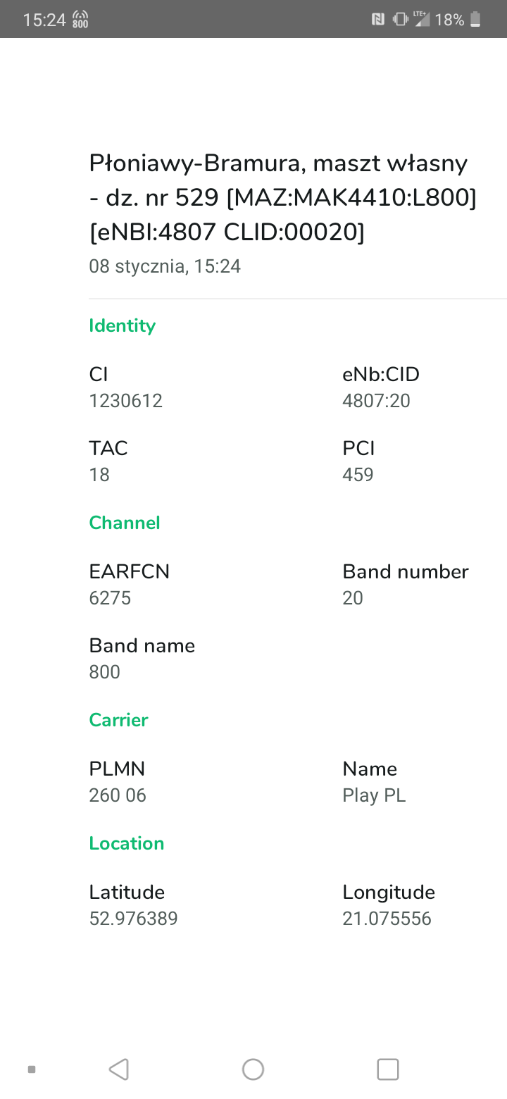

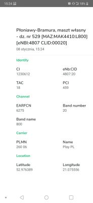

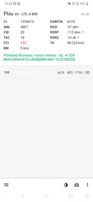

    Hello. I plan to buy an internet router from Play. What can you advise? I put screenshots from netmonster and speedtest. Regards Which PLAY Internet router (with LTE 800 MHz band aggregation?) Which PLAY Internet router (with LTE 800 MHz band aggregation?) Which PLAY Internet router (with LTE 800 MHz band aggregation?)
  • #28 19807725
    matek451
    Posts: 31144
    Help: 4334
    Rate: 5765
    In what location was the test performed, outdoors or at home? The Play Płoniawy-Bramura base station operates in the LTE2100 + 1800 + 800 aggregation. the phone joined in aggregation as the LTE800 baseband, very poor signal parameters and probably LTE1800 / 2100 to it on some remnants of the signal, in the neighbors some other BTS Play on LTE800, the signal even worse. The router is not everything, with such signal parameters the basis will be a directional antenna, in Play LTE800 operating at 5MHz it does not count, it has the greatest range and is usually clogged. Each LTE2100 / 1800 base station working on 15MHz bands and their aggregation count on this base station.
  • #29 19807728
    eto07eto
    Posts: 43
    Thanks for the quick reply. The test was taken outside. I will add that I live gently in the well in relation to the transmitter. So what should be done to have a relatively stable and fast internet?
    Location 52.9743420,21.1189101
  • #30 19807746
    matek451
    Posts: 31144
    Help: 4334
    Rate: 5765
    Take the test outside but somewhere higher, for example, outside the window on the second floor, attic. You see BTS Play standing behind the cemetery on the road to you.
