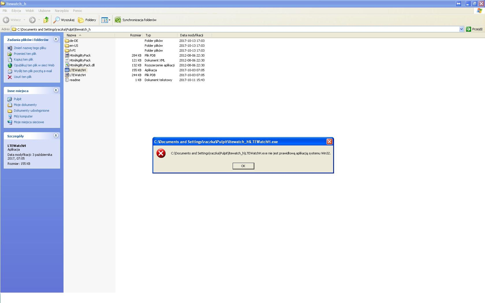

  • #5 16755080
    Mraczka
    Posts: 44
    Rate: 7
    Unfortunately, I can't install the application (win XP 32-bit)
    "... is not a valid Win32 application"
    Best LTE Router for Micro SIM PLUS Card: HUAWEI E5180 or Upgrade? External Antenna Options
    Of course I am asking for further help
    #6 16755130
    makosuu
    Posts: 2984
    Help: 369
    Rate: 370
    Paaanie, Windolx XP, don't you have something newer? Honestly, I have never run this application on XP, so I do not know if it works, the application is probably not. If you don't have it, we'll think.

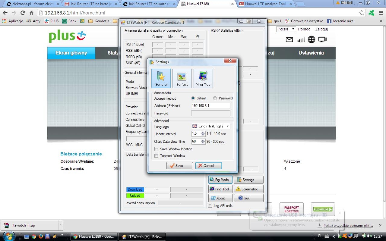

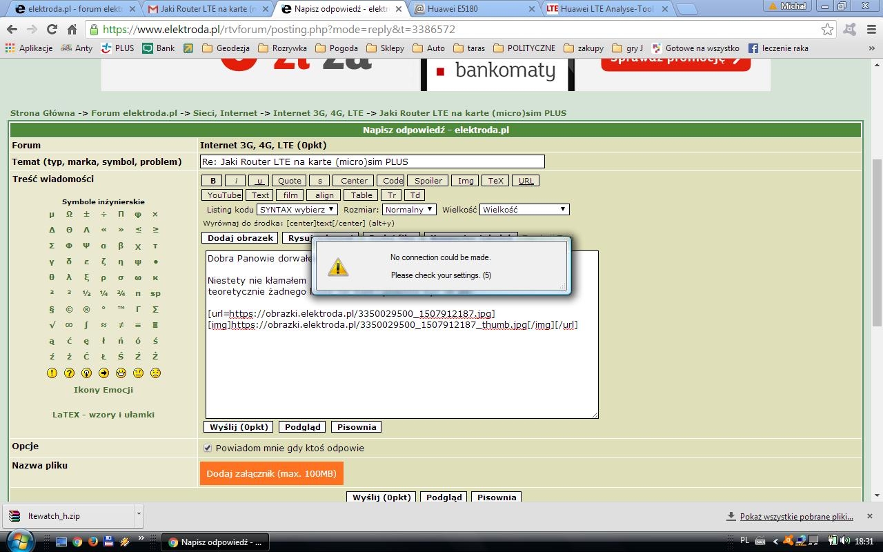

  • #7 16755257
    Mraczka
    Posts: 44
    Rate: 7
    Okay, gentlemen, I got Viste's wife (also archaism :) )
    As for Win XP, I know that it is a trick, but in my industry there are many useful programs that do not work on newer systems
    Unfortunately, I wasn't lying and I'm a Lajkonik
    theoretically, I don't have any password and it should be ok but I can't log in:
    Added after 8 [minutes]:
    what now?
    I am asking for a clear short instruction
    #8 16755285
    matek451
    Posts: 31253
    Help: 4352
    Rate: 5808
    You click Password and enter the same password as to connect to the router in the browser.

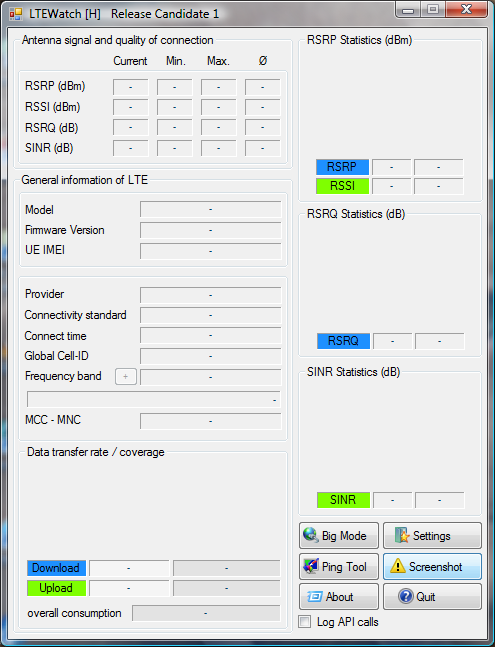

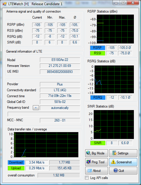

  • #9 16755293
    Mraczka
    Posts: 44
    Rate: 7
    something popped up
    Added after 6 [minutes]:
    I changed the frequency band once to 1800, then 800

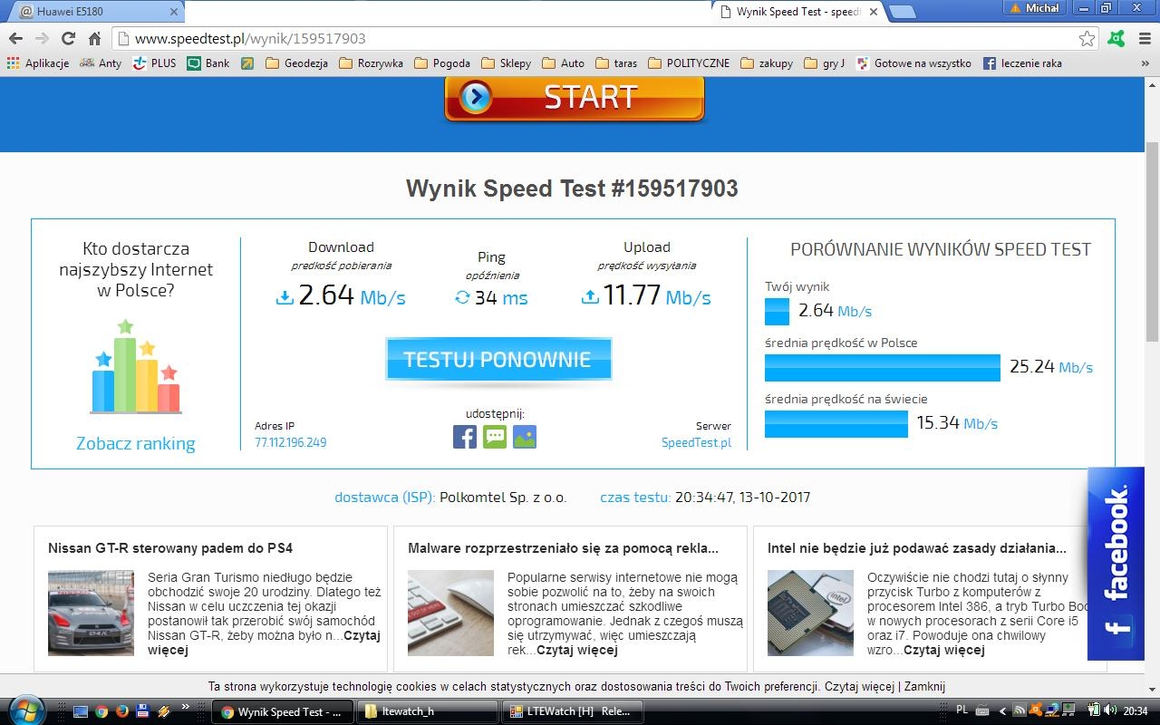

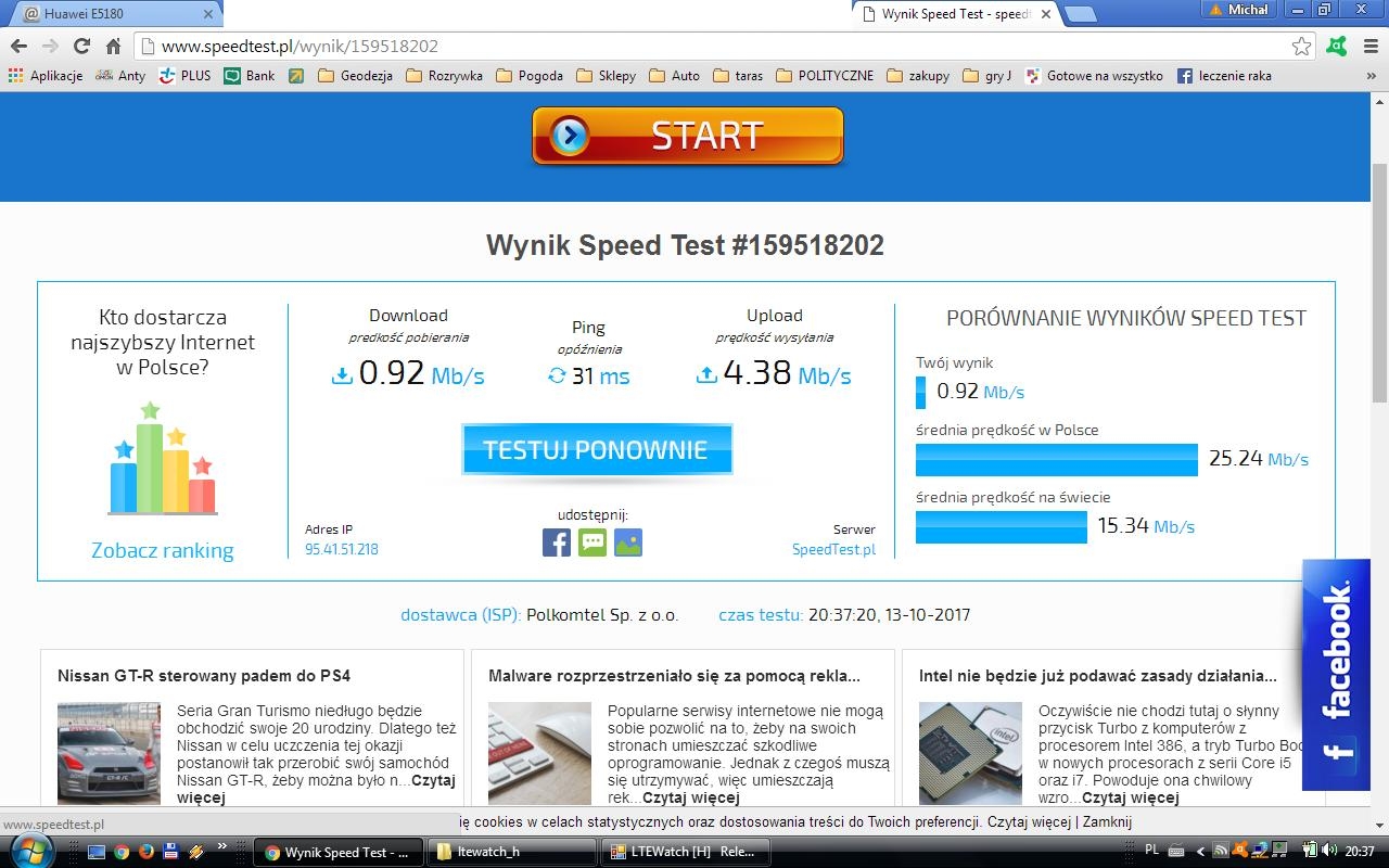

  • #10 16755493
    makosuu
    Posts: 2984
    Help: 369
    Rate: 370
    Do speedtest with setting 1800 then you can set it back to auto.

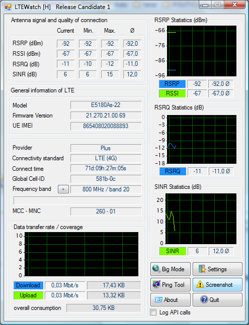

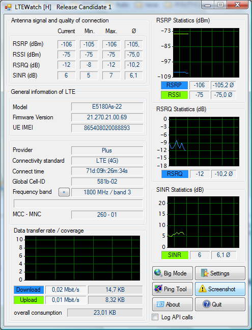

  • #12 16755562
    Mraczka
    Posts: 44
    Rate: 7
    1800
    800
    #13 16755624
    makosuu
    Posts: 2984
    Help: 369
    Rate: 370
    Obviously both clogged but 1800 better. This is probably the fault of your internet overload problems. Because the range is pretty good. Unfortunately, you will not reduce the load.
    #14 16755672
    matek451
    Posts: 31253
    Help: 4352
    Rate: 5808
    Everything is clear, LTE Plus "works" according to their standards. It is not known if and how BTS LTE1800Aero2 from Markov and Widacz work. It's high time to change the operator, T-mobile is waiting with an unlimited internet offer for PLN 45/55 per month, in a subscription for PLN 1 the B525 router, i.e. LTE-A worth PLN 400-500. Coverage from BTS LTE1800NetWorks and LTE800 T-Mobile Polna in Kańczuga. In Husów, the LTE800 T-Mobile.
