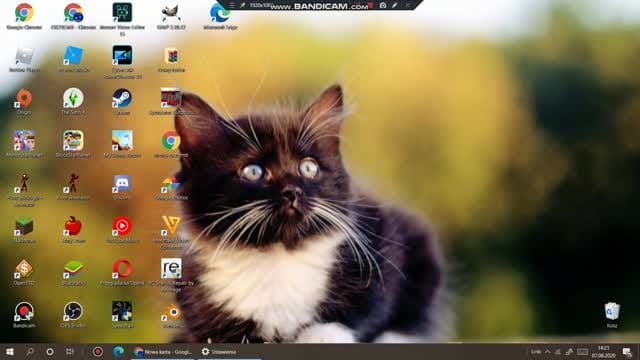

    I have a problem - can't search Windows Search. Someone help me? I have been doing troubleshooting and writing has not been resolved. Windows Search Search bar doesn't work and in file explorer (I wanted to search in file explorer for search and it doesn't work either). What to do with search on this laptop? Check out the video I put on, I've had this problem for a long time.
    [movie: a68583f02e] https://filmy.elektroda.pl/67_1596802963.mp4 [/ movie: a68583f02e]

    Run powershell as administrator - a dark blue window - a prompt will pop up with a construct in front of it:
    PS C:\WINDOWS\system32>
    Then copy and paste this lower code into the powershel window, e.g. holding shift, click with two fingers on the trackpad or shift and right.
    Get-AppxPackage Microsoft.Windows.Cortana | Foreach {Add-AppxPackage -DisableDevelopmentMode -Register "$($_.InstallLocation)\AppXManifest.xml"}
    They spent a while, restart the computer. See if it helped

    Unfortunately, it did not help me and I still have a problem

    The damage is deeper. Before you attach the logs (I'll write them in a moment), run cmd as an administrator and in the black console, type:
    chkdsk /f c:
    Restart the computer and then cmd again as administrator and the command:
    dism /online /cleanup-image /start component cleanup
    dism /online /cleanup-image /restorehealth
    sfc /scannow
    Record the time of completion of the last operation and attach the system event log (compmgmt.msc / s) selecting all of them with shift and end, right save all or selected selected events - save to evtx file and attach. Attach two more log files - folders c: \ windows \ logs \ cbs ic: \ windows \ logs \ dism

    I didn't do that
    the search engine started working when there was some configuration after the configuration, I clicked the search button and it started working.
    I close
